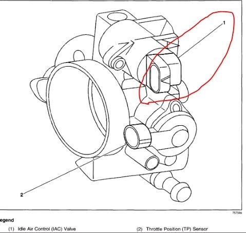

Car runs great as long as air conditioning is on. Once air is turned off or heat is put on car runs terrible at idle!
Jun 5, 2019 at 12:54 AM
  • 110,240 POSTS
Welcome to 2CarPros.
When the AC is on, there is a component called a stepper motor that raises the idle speed to compensate for the added load on the engine. When you turn the AC off, the motor (idle air control valve or IAC) readjusts to lower the RPM's.
Based on your description, I have a feeling you have one of three things wrong. First, the IAC is not functioning properly or is dirty, not allowing enough air to enter the engine. Second, there is an engine vacuum leak. Third, the throttle body (throttle plate) needs cleaned.
First, I will provide directions on how to clean a throttle body. This is the easiest to try and cheapest. Follow this link:
Next, if that doesn't fix the problem I need you to check for engine vacuum leaks. This can cause a rough idle as well. Here is a link that shows how to check:
Now the last. If there are no leaks and cleaning the throttle body didn't help, I need you to remove the idle air control valve (IAC) for inspection. Again, this is the component that is responsible for maintaining a smooth idle.
First, here is a link that explains how one is replaced. I am providing this just to help you remove the one on the vehicle for inspection.
https://www.2carpros.com/articles/how-to-replace-an-idle-speed-control-motor-iac

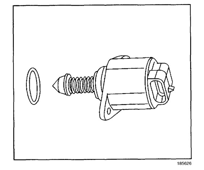

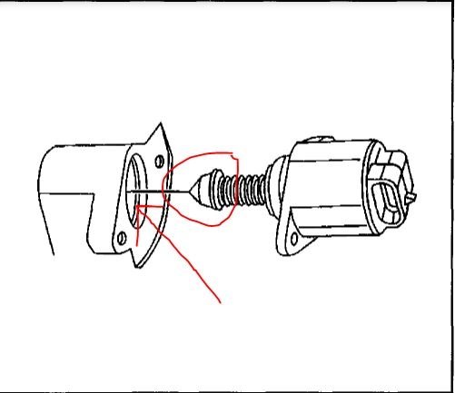

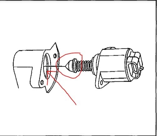

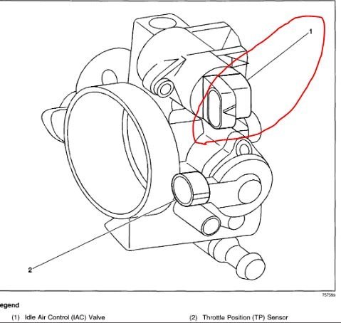

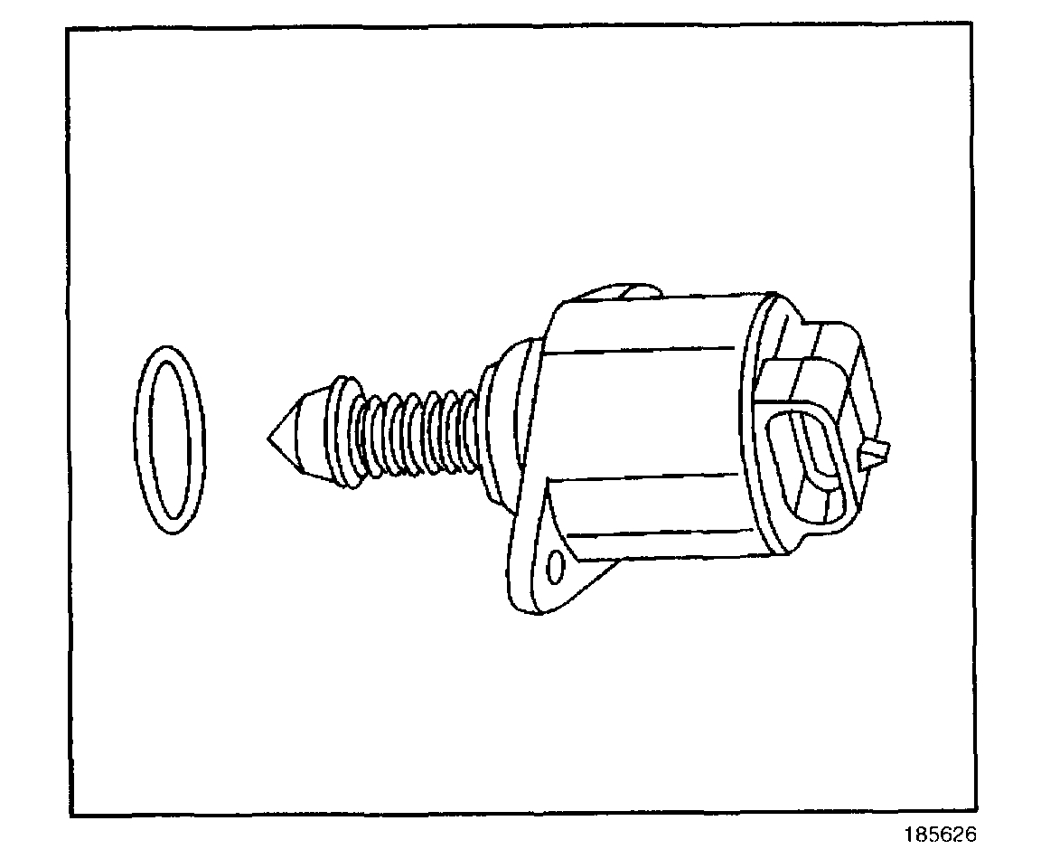

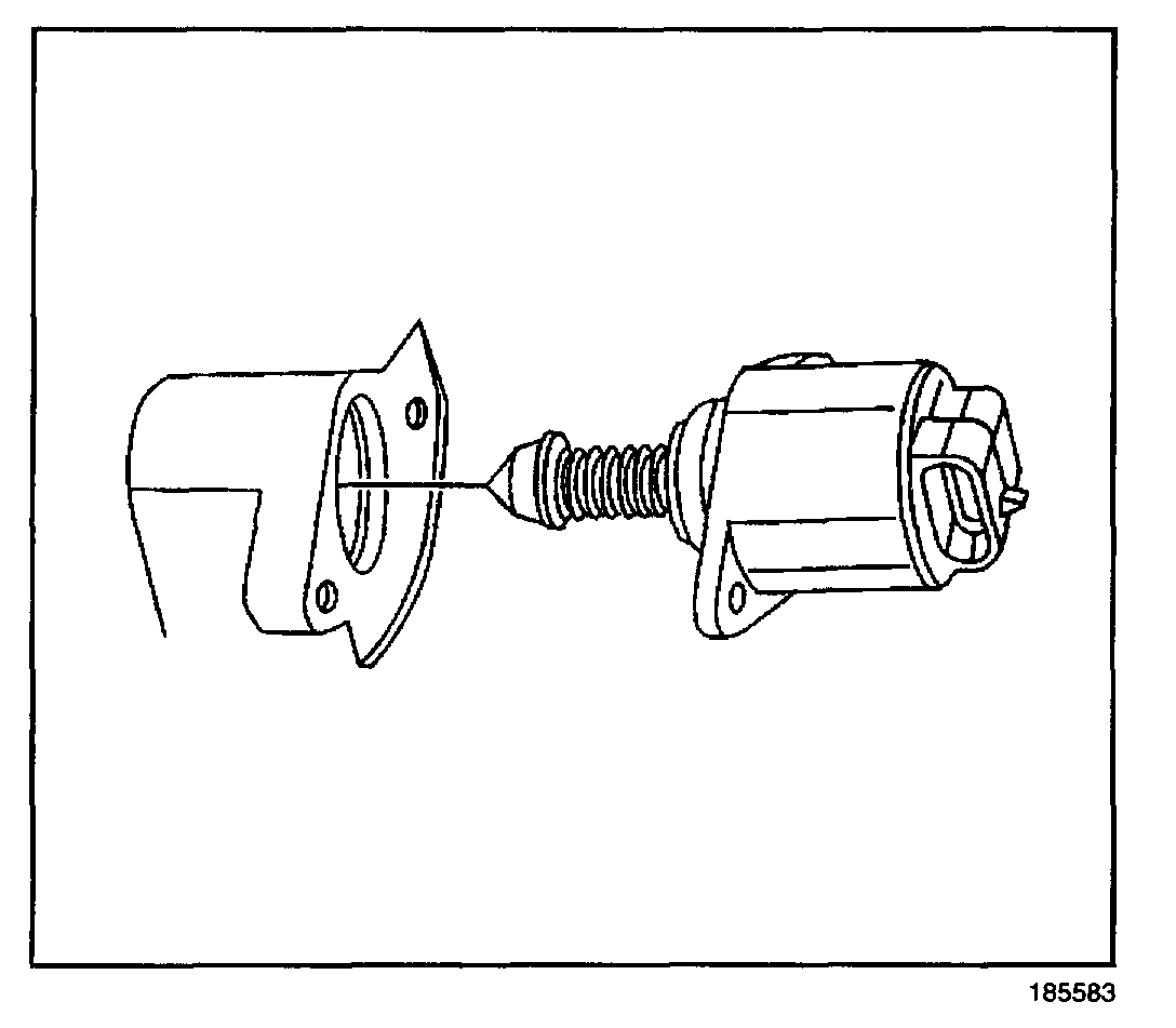

Next, here are the directions specific to your vehicle for IAC replacement. Again, at this point I only want you to remove and inspect it. The attached pictures correlate with the directions. In picture 3, I circled what is called the pintle and have a very sad arrow pointing into where the pintle goes. You need to check for dirt or carbon build up in there as well as on the circled pintle. The very last picture I attached shows where the IAC is located on the throttle body.

pic 1
1. Remove the throttle control cable bracket from the throttle body.
2. Remove the canister purge valve.

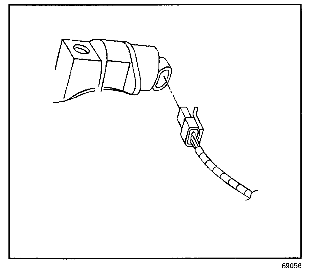

3. Disconnect the idle air control (IAC) electrical connector.

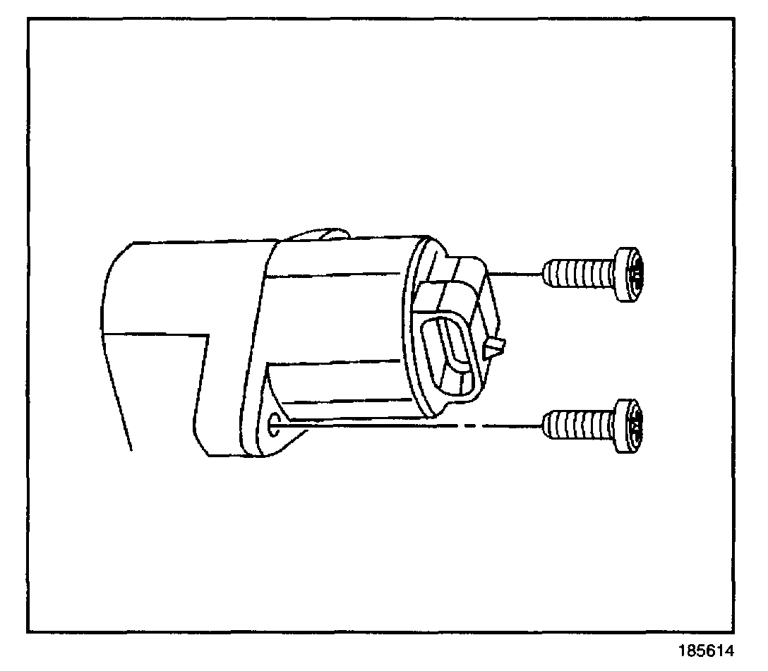

pic 2
4. Remove the idle air control valve attaching screws.
pic 3
5. Remove the idle air control valve.
pic 4
6. Remove the idle air control valve O-ring.

pic 8
4. Connect the IAC electrical connector.
