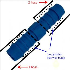

The green coolant/antifreeze in the car was clean and clear.
But while I was connecting new hose coupler(attached photo)between two cooling hoses(in order to build a
shape of hose that I didn't find in the stores)i was creating some rubber particles in the hoses(that was made from the pushing action of the hose coupler into the hoses).
I forgot to wash the final-made hose and I connected it back to the car(between the expansion tank and the metal flange tube, but while I added fresh anti freeze I saw
some rubber particles in the expansion tank(that were washed from the hose and now they are flowing in the cooling system. After some miles of driving the particles slowly disappearing but they are, still, flowing in the system.
My question:May these rubber particles in the cooling system be a problem?
The coolant is new and all the system was clean. There are only those rubber particles that made by me, since I
forgot to wash the inside of the hose before connecting them back.
And I really would like to avoid making flush to the system just because of that(as I mentioned, the coolant was new and clear before)if it may not be an issue.
BTW, one of the hose that is connected to the hose couple is new and the other is old.
So, I guess that most of the particles was made from the old hose.

IF THEY ARE TINY PARTICLES, I WOULD NOT WORRY ABOUT THEM!
IF THE HOSES ARE CRUMBLING IN THAT MANNER, IT MIGHT BE TIME TO BREAK DOWN AND REPLACE THEM, BEFORE YOU ARE EYEBALLING A RUPTURE ON THE SIDE OF THE ROAD!

FROM THE WAY YOU DESCRIBE THE PARTICLES, THEY ARE AS SMALL OR SMALLER THAN "STOP LEAK" (THAT RESEMBLES "GLITTER") USED IN RADIATORS TO PLUG HOLES.
THE BARBED HOSE COUPLER FITTING SCUFFED OFF A SMALL AMOUNT OF DETERIORATING HOSE
I'D SAY THAT IF THE PARTICLES CAN EZily TRAVEL THRU THE RADIATOR VANES THEY WILL HAVE NO ILL AFFECT ANYWHERE ELSE.
IF YOU ARE REALLY WORRIED, WHY DON'T YOU FLUSH THE COOLING SYSTEM?

Yes, they small enough to flow through the radiator vanes.
The problem is that after I made a flush(was made, unfortunately, before I connect the new hose), change the hose and refill a new expensive green coolant, I realized that I forgot to wash the new hose.
So doing the whole thing again is too much.
I understand that if they can easily flow through the radiator they will have no ill affect anywhere else, like at the engine block passages, the heater etc.
What about the tiny hole in the cooling systen thermostat(the hole that let the air pockets to get out)should I be worry that it will be blocked?
It is much smaller than the radiator vains, but I don't if the cooling system built in that way, that prevent the tiny hole to be clogged?

YOU COULD DRAIN IT DOWN, USE A PAINT STRAINER OR EQUIVALENT TO STRAIN OUT THE PARTICLES.
FLUSH THE SYSTEM WITH WATER, THEN RE-INSTALL THE COOLANT YOU JUST STRAINED.
HOWEVER, I STILL SEE NOTHING BAD HAPPENING AS IT IS NOW!
