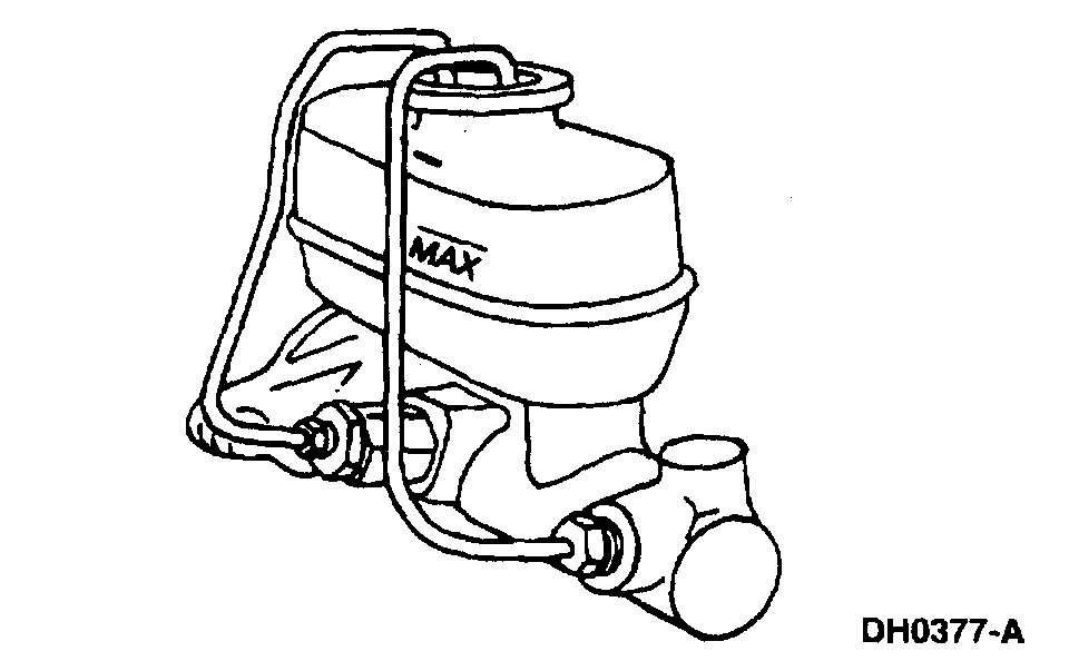

Here are the directions for bleeding the master cylinder. Note that the directions show both in vehicle and out of vehicle bleeding. The attached pics correlate with the directions.
____________________________________________
2000 Ford Mustang V6-3.8L VIN 4
Master Cylinder Priming - In-Vehicle or Bench
Vehicle Brakes and Traction Control Hydraulic System Brake Bleeding Service and Repair Procedures Master Cylinder Priming - In-Vehicle or Bench
MASTER CYLINDER PRIMING - IN-VEHICLE OR BENCH

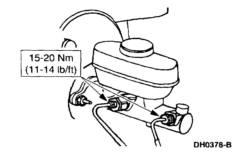

Note: When a new brake master cylinder has been installed or the system has been emptied, or partially emptied, it should be primed to prevent air from entering the system.
pic 2
1. For in-vehicle priming, disconnect the brake lines.

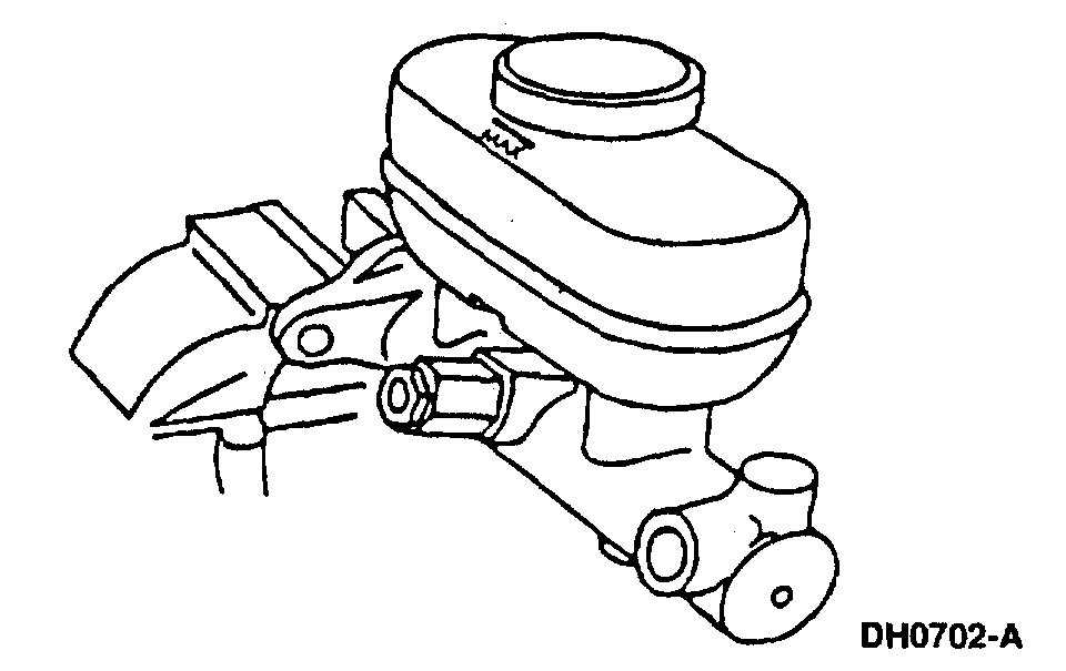

2. For bench priming, mount the brake master cylinder in a vise.

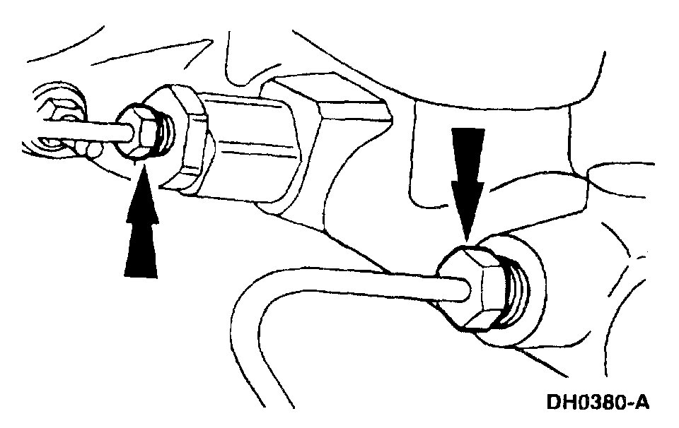

3. Install short brake tubes with the ends submerged in the brake master cylinder reservoir, and fill the brake master cylinder reservoir with High Performance DOT 3 Brake Fluid C6AZ-19542-AB or equivalent DOT 3 fluid meeting Ford specification ESA-M6C25-A.
4. Have an assistant pump the brake pedal , or slowly depress the primary piston until clear fluid flows from both brake tubes, without air bubbles.
