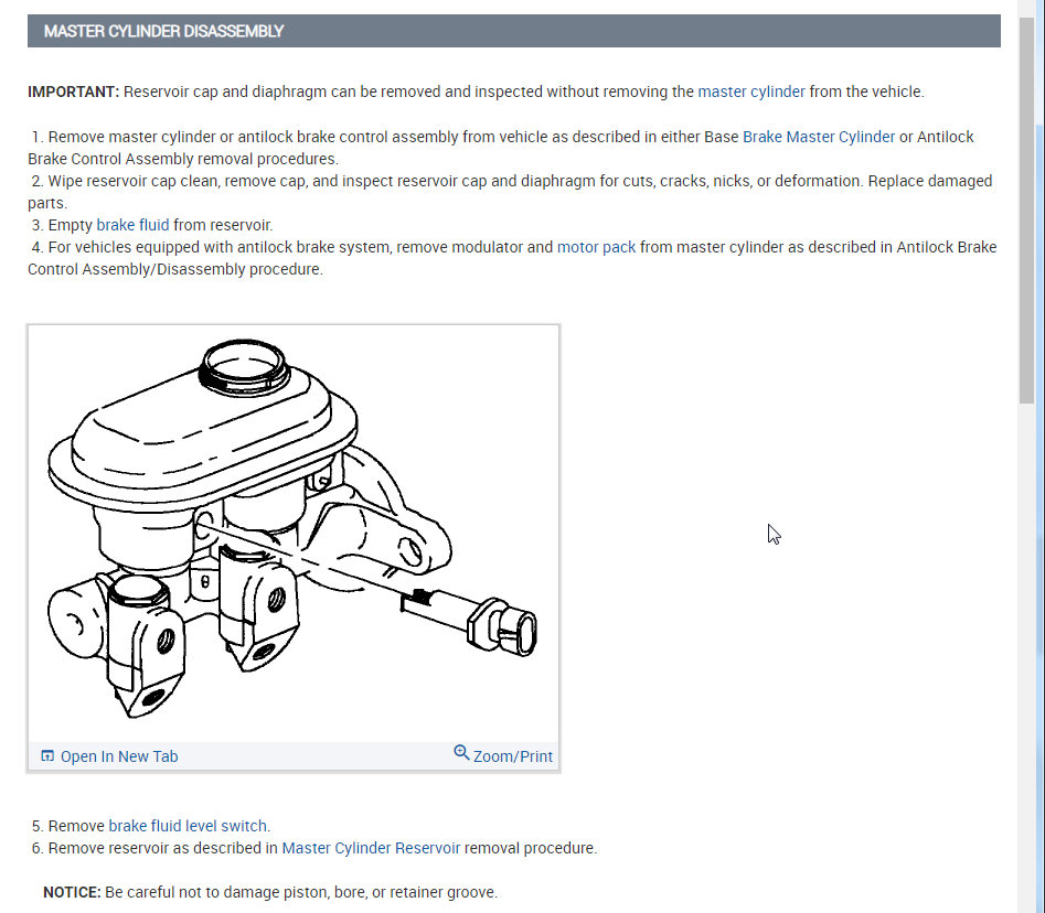

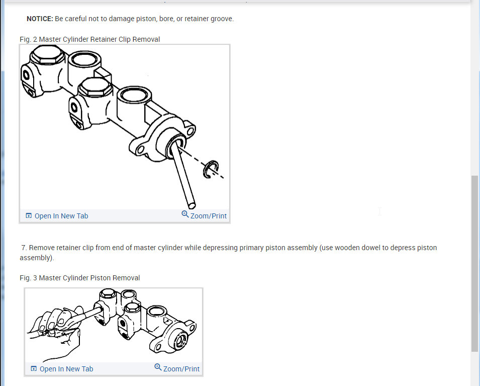

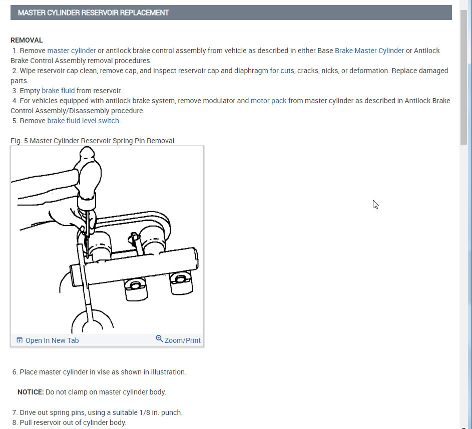

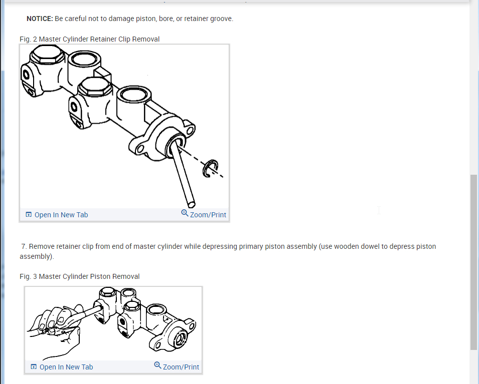

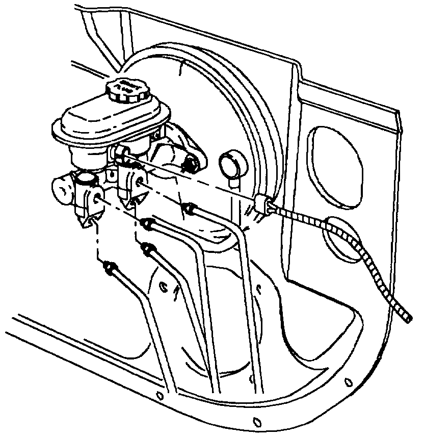

I'm having brake issues. my brake pedal goes to the floor before the car fully brakes and stops. I took the master cylinder off and cleaned it completely. All the o rings and springs and pistons appeared to be be in fine working order with no corrosion, rust, or break down, other than the rubber seal that goes under the brake fluid cap. The rubber seal has 2 very large cracks in it. My boyfriend said that seal doesn't make a difference in the brake pressure but why else would it look like a diaphragm if it wasn't meant for pressure some how? Also, where are all the locations of all the rubber fittings on the master cylinder and reservoir tank? I think mine may be missing quite a few.

If there are no leaks, chances are the master cylinder is bad. Read through this link:
https://www.2carpros.com/articles/brake-pedal-goes-to-the-floor
What I would suggest is to confirm there are no leaks anywhere. If the master cylinder is staying full, then suspect it is bad and fluid is bypassing the piston o-rings.
Here are the directions for replacement specific to your vehicle. The attached pics correlate with the directions. After the replacement directions, I will include the directions for bleeding the system. One last thing. Here is a link that shows in general how one is replaced. Look through it because it explains how to bench bleed the new master cylinder. You will need to do that.
https://www.2carpros.com/articles/how-to-replace-a-brake-master-cylinder

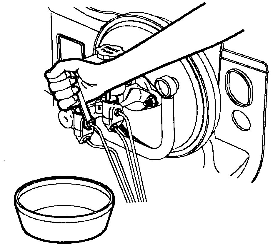

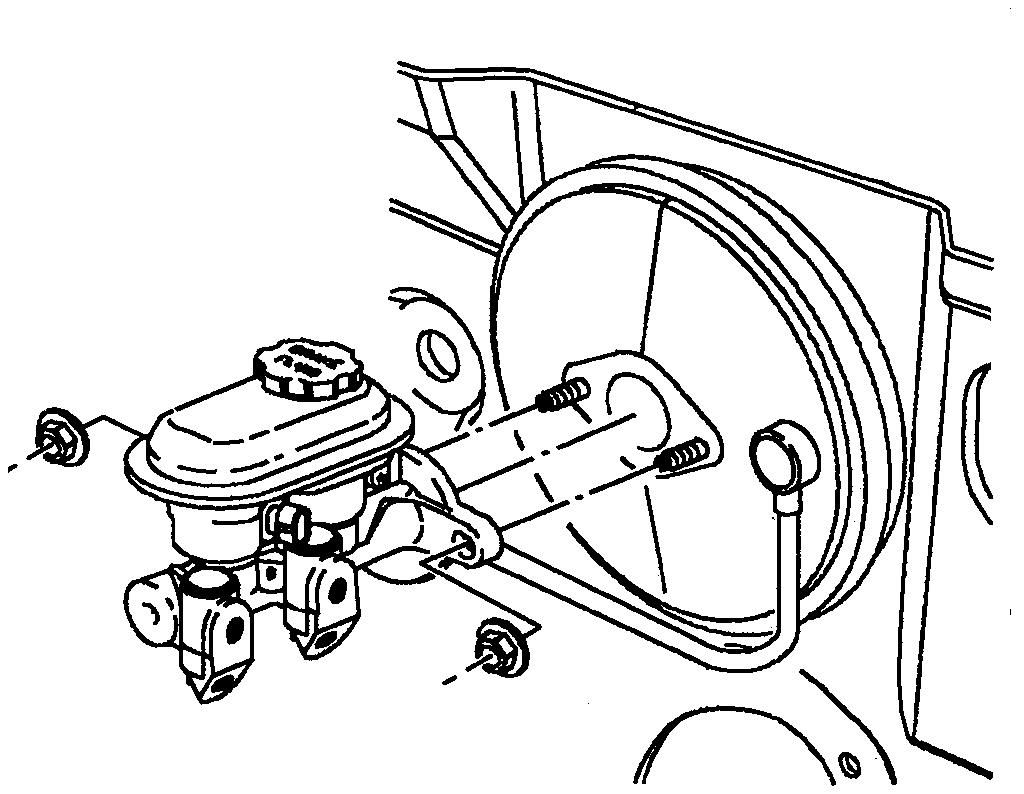

1. Disconnect negative battery cable.
2. Remove brake fluid level switch electrical connector from master cylinder reservoir.
pic 1
3. Remove brake pipe nuts from master cylinder.
NOTICE:
^ After removing brake pipe nuts, do not excessively pull or bend brake pipes away from master cylinder.
^ Plug open brake pipes to prevent brake fluid loss and contamination.

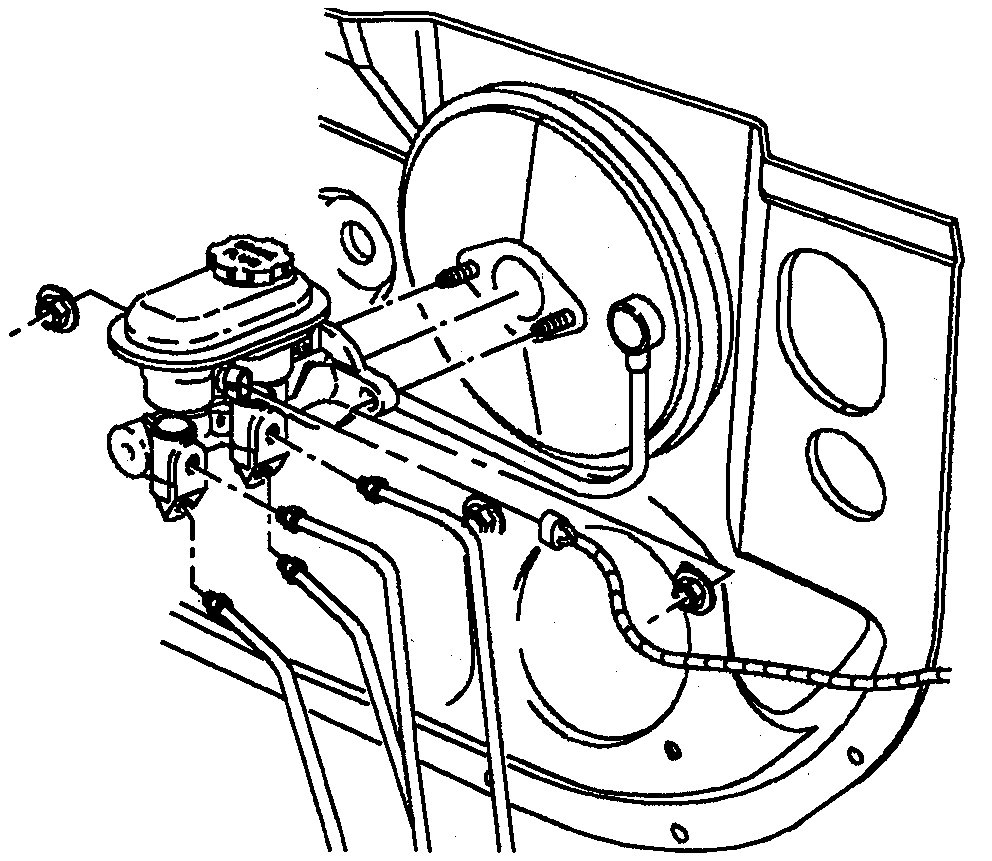

pic 2
4. Remove two master cylinder-to-brake booster attachment nuts.
NOTICE: Be careful not to bend brake pipes.
5. Remove master cylinder.

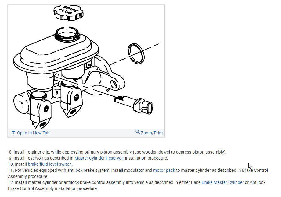

INSTALLATION
1. Position master cylinder onto brake booster studs and install fastening nuts.
^ Torque: 27 Nm (20 ft. lbs.)
pic 3
2. Position brake pipes into the master cylinder and secure brake pipe nuts.
^ Torque: 32 Nm (24 ft. lbs.)
3. Connect electrical connector for brake fluid level switch.
4. Connect negative battery cable.

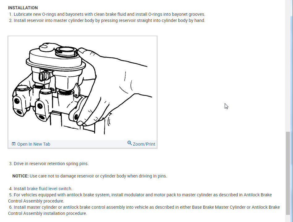

MANUAL BLEEDING PROCEDURE
Conventional (Base) Brake Bleeding
pic 4

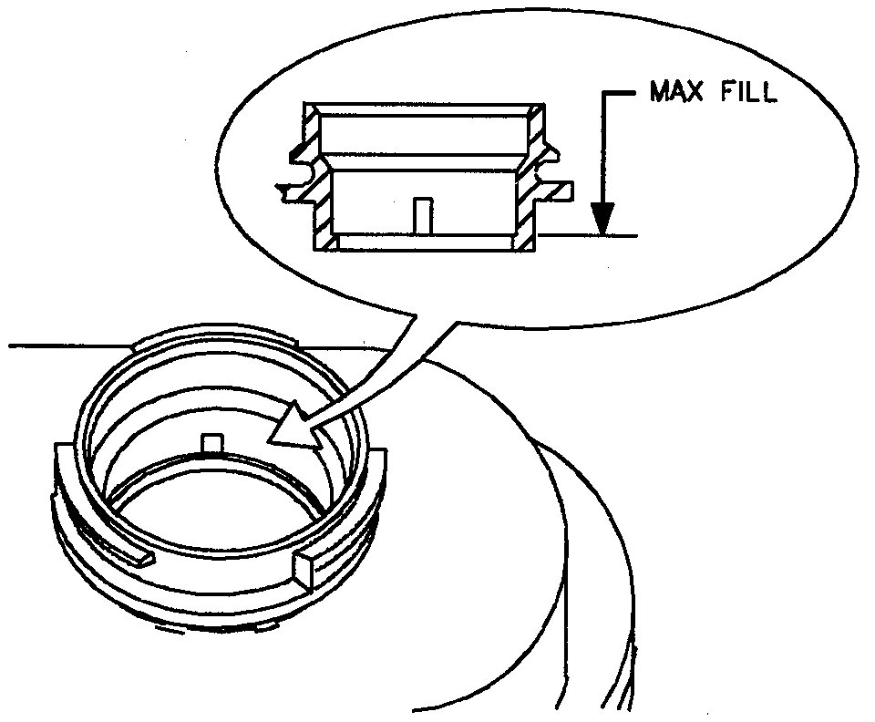

1. Fill the master cylinder reservoir with brake fluid. Keep reservoir at least half full during bleeding procedure.
NOTICE:
^ Brake fluid is corrosive to painted surfaces. Take care not to allow brake fluid to contact painted surfaces on vehicle.
^ Use only DOT 3 brake fluid from a clean, sealed container. Do not use any fluid from a container which is wet with water. Do not use DOT 5 silicone fluid.

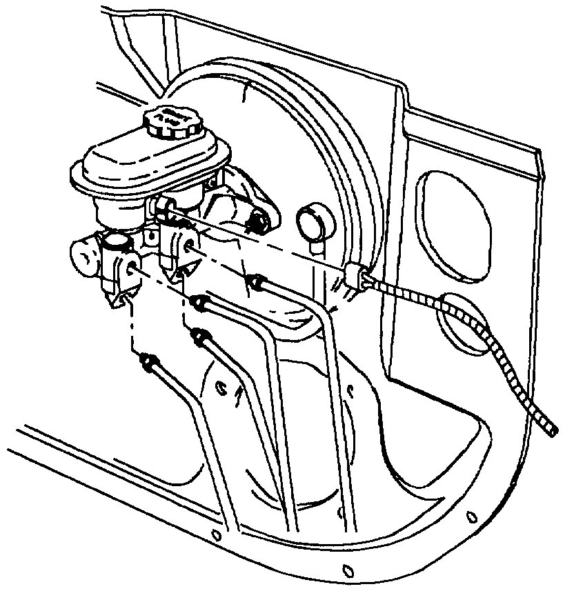

pic 5
2. If the master cylinder is suspected of having air in its bore, it must be bled before proceeding to brake line bleeding.
a. Loosen left front brake pipe (front upper port) at master cylinder.
b. Allow brake fluid to flow from front master cylinder port.
c. Tighten left front brake pipe into master cylinder.
d. Loosen left front brake pipe at master cylinder 1/4 turn.
e. Depress brake pedal slowly until fluid is seen coming from the pipe nut.
f. Once again, tighten left front brake pipe into master cylinder, while pedal is being depressed.
g. Slowly release pedal.
h. Repeat sequence until all air is removed from front (secondary) master cylinder bore.
i. Loosen right front brake pipe (rear upper port) at master cylinder.
j. Allow brake fluid to flow from rear master cylinder port.
k. Tighten right front brake pipe into master cylinder.
l. Loosen right front brake pipe at master cylinder 1/4 turn.
m. Depress brake pedal slowly until fluid is seen coming from the pipe nut.
n. Once again, tighten right front brake pipe into master cylinder while pedal is being depressed.
o. Slowly release pedal.
p. Repeat sequence until all air is removed from rear (primary) master cylinder bore.

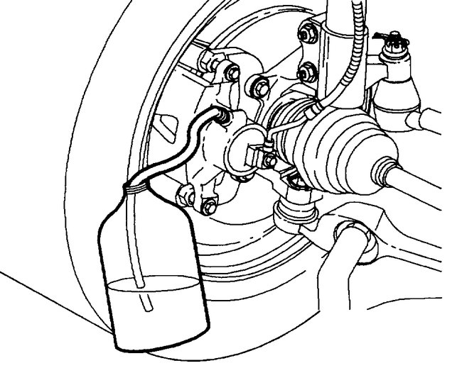

3. Bleed individual calipers and wheel cylinders.
a. Place wrench over bleeder valve.
b. Attach transparent hose over bleeder valve nipple. Submerge other end of hose in a transparent container of brake fluid.
c. Loosen bleeder screw.
d. Apply brake pedal slowly and hold.
e. Tighten bleeder valve.
^ Torque: 11 Nm (97 inch lbs.) front
^ Torque: 7.5 Nm (66 inch lbs.) rear
IMPORTANT: To assist in freeing entrapped air, tap lightly on caliper casting with a rubber mallet.
f. Release brake pedal.
g. Repeat sequence until all air is removed from brake pipes.

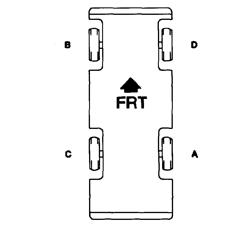

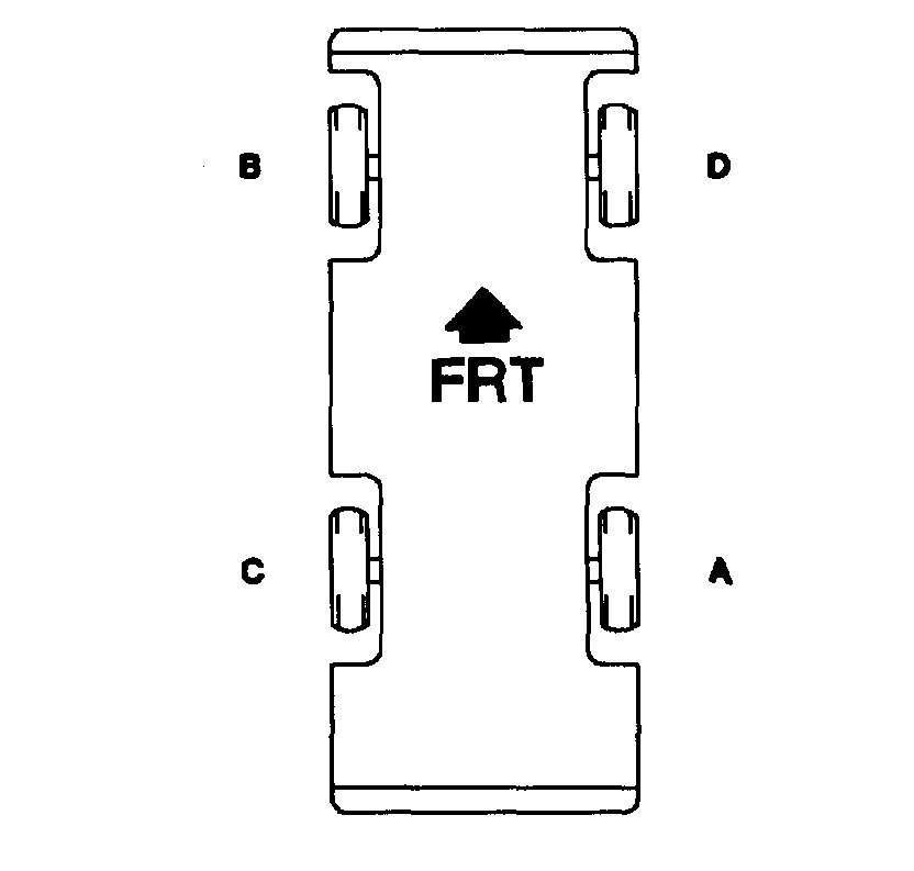

4. If more than one brake pipe is being bled, bleed in the following sequence:
a. Right rear
b. Left front
c. Left rear
d. Right front

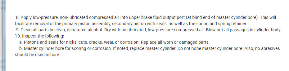

First of all, I commend you for digging into this and trying to figure out what could be wrong with the master cylinder. However, I think you are attacking it from the wrong approach.
The master cylinder could be the issue and is the most likely cause if there are no external leaks or air in the lines.
Here is a guide that will help with this issue:
The way we want to come at this is to identify the issue on the vehicle that is causing it before taking it apart. If the master cylinder is the issue, I doubt you will physically see it unless you find a cut seal.
So what I would do is disconnect all the lines off the master cylinder while it is still on the vehicle and cap them all with bolts that are the same size and depth so you don't bottom them out and then press the brake pedal.
Does the pedal still go to the floor? If so, replace the master as it is leaking internally. If not, then start connecting the lines back on one at a time until it drops to the floor again.
However, if you want to rebuild it, below is the process on how to do that.
Feb 2, 2021 at 10:04 AM

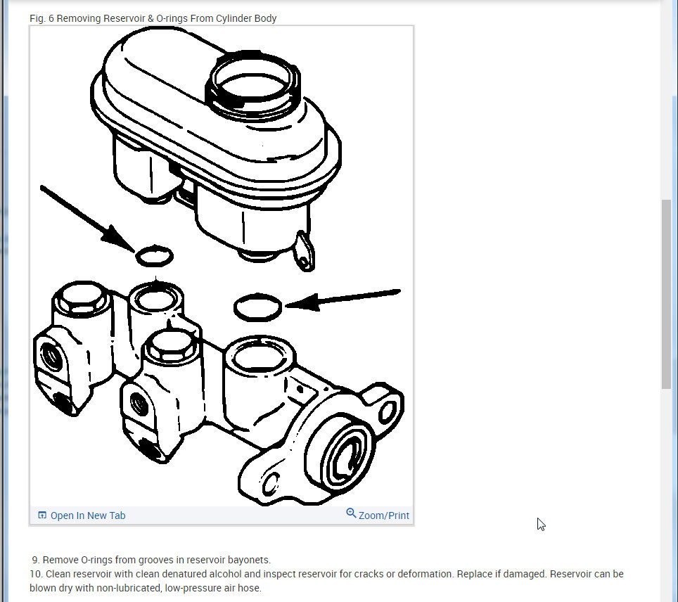

Okay. I'm going to go out and check everything you suggested to do and see what kind of outcome I get. But you did answer the question I had about the importance of the rubber seal that's under the reservoir having no cracks in it. I think there's where the good majority of my problems are coming from because the one under my cap is darn near ripped in half. I'll let you know how it turns out here shortly. Thank you!
Feb 2, 2021 at 10:34 AM

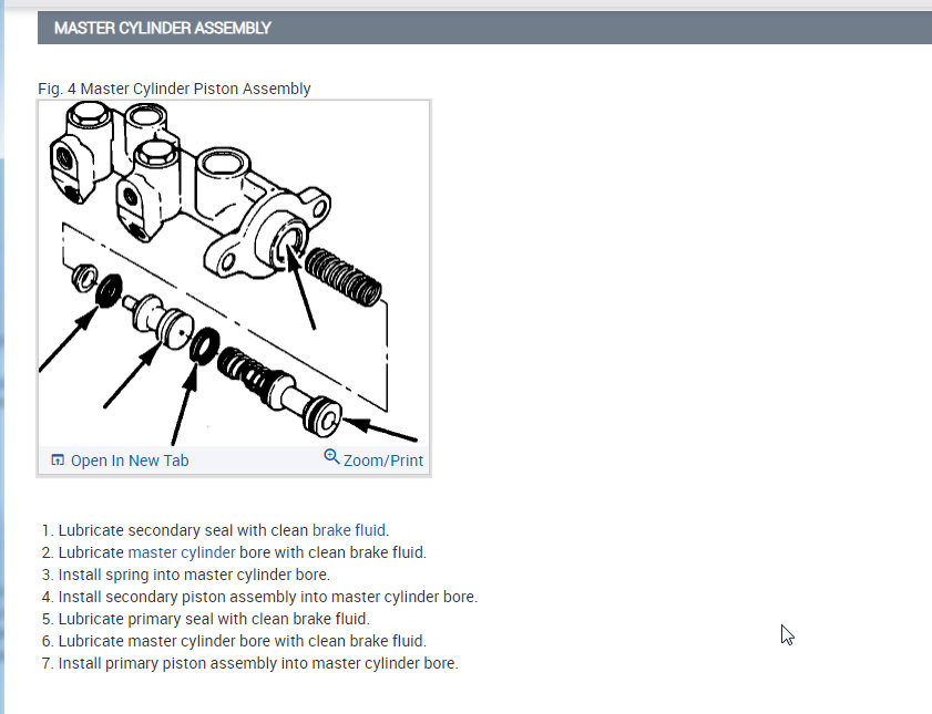

Sorry if we didn't answer that. You mean the o rings shown in the second picture attached below? If you have cracks in those then I would assume you would have a leak.
Or are you talking about the rubber diaphragm under the cap? If that is damaged then yes, you need to replace that. This is responsible for keeping air and moisture out so you may just have water in your fluid which will require flushing the fluid.
https://www.2carpros.com/articles/how-to-bleed-or-flush-a-car-brake-system
Keep us posted. Thanks
