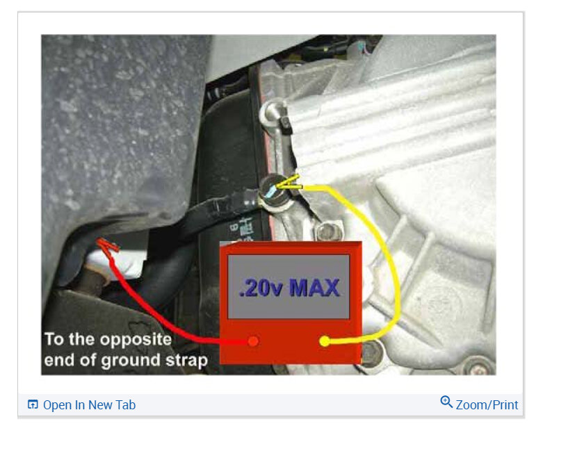

Put a clutch and throw out bearing in amongst a bunch of other things over the past 2 months, but I put the transmission back together it drove great for about one day, and then I was driving, and it just conks out. then I noticed the wires heated up and melted on the crankshaft position sensor so I rewired those wires but the car still won't start. I got it to idle for a minute or two at a time and change the motor in the fuel pump but here's the codes that came up is there any one of these codes that would keep the car from starting.2419, 2401,1562,1505,1507,0030,31,36,37.

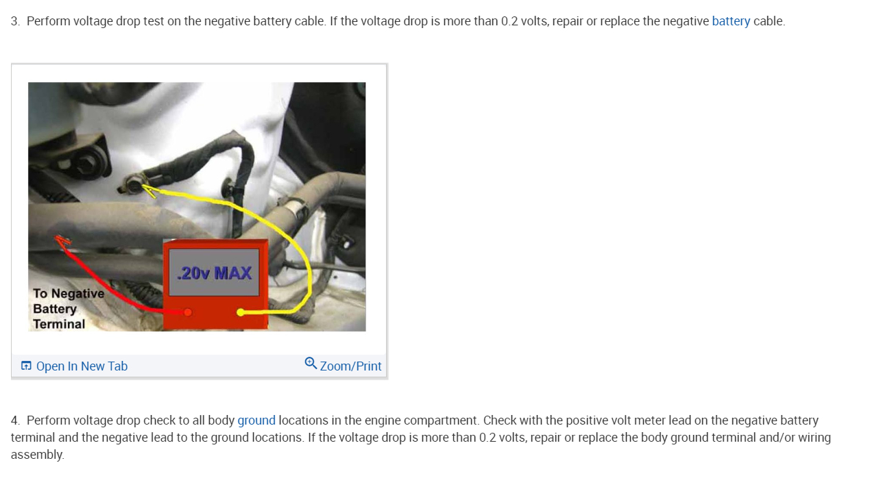

So, this can happen when the engine/transmission ground has been left off of the engine so when you crank the car over the grounds are forced through the computer system which makes the wires melt and cause codes. In severe cases the computer will need to be replaced but we should fix the problem first and then clear the codes. Here are images of the ground straps so you can check it out. Check out the images (below). Please let us know what happens.
