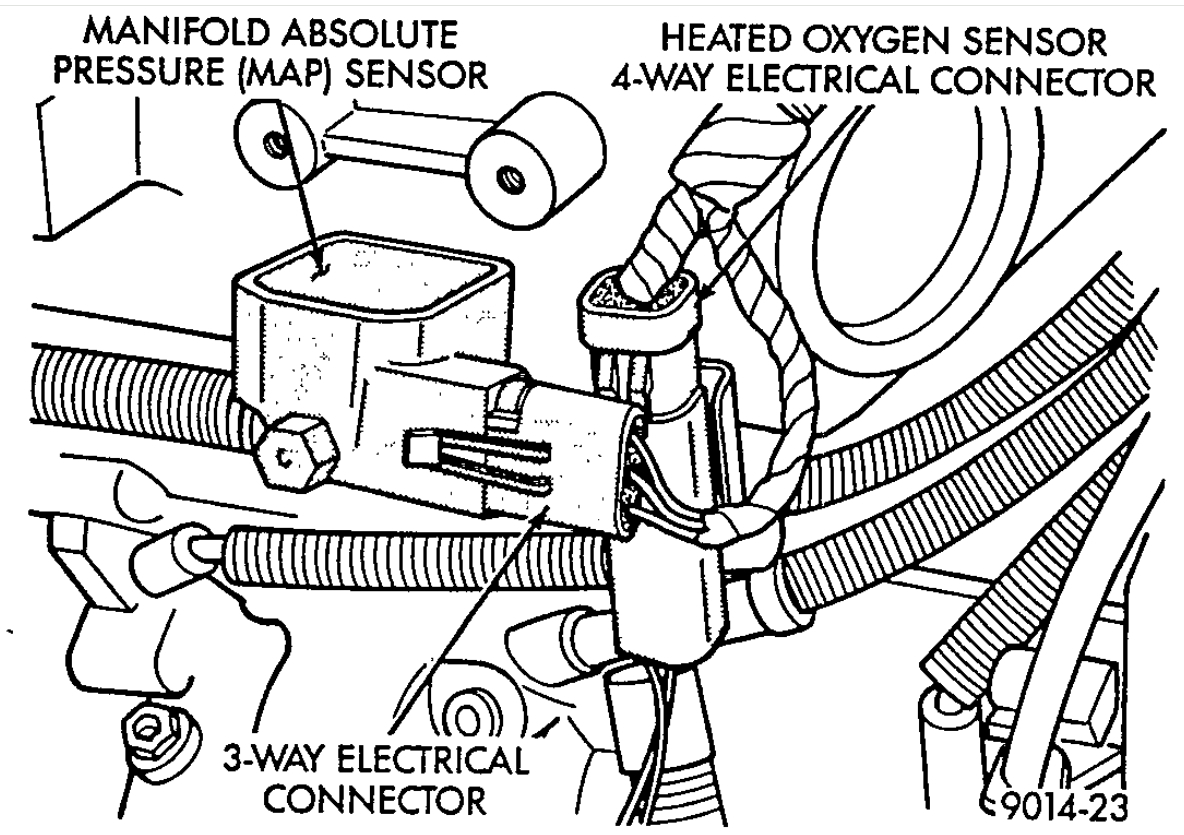

i still can't get this started. but i found that the MAP sensor was only partially screwed in. and it was covered in an oily substance. so, i screwed it all the way in. Why would it not throw a fault code? Can these be cleaned? and brought back to life? thanks
Jul 6, 2024 at 2:49 AM
  • 55,447 POSTS

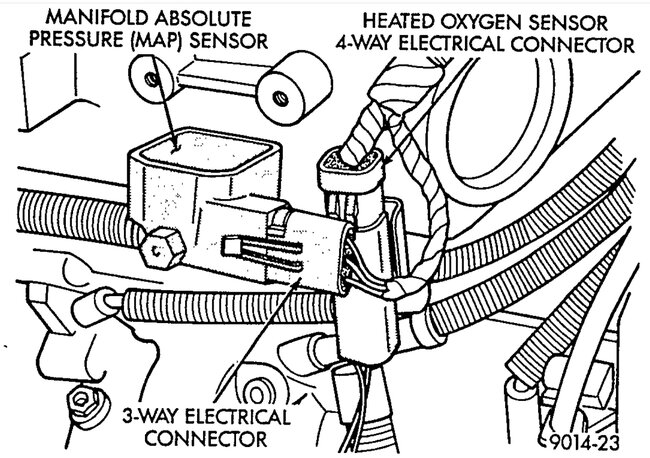

Just because the MAP sensor was not plugged in completely doesn't mean it will have a code. It will just report back to the PCM that has low vacuum. You can clean it and reinstall it, which should help, if there are no codes after installation you should be okay. Here is the correct way to install the MAP sensor and its location. Check out the images (below). Let us know how it goes.
