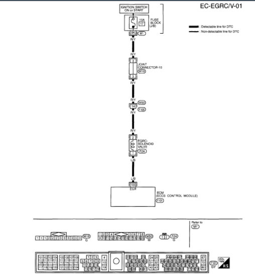

Engine shut off while driving, code P1400
1996 NISSAN MAXIMA
230,000 MILES • 3.0L • 6 CYL • 2WD • AUTOMATIC
LYNTAVIUS MACK

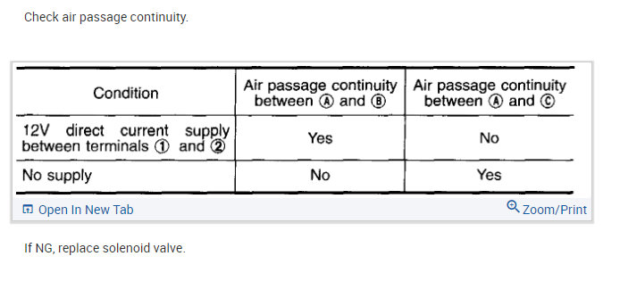

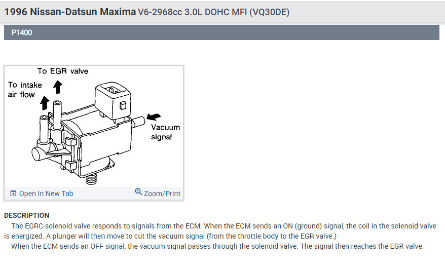

While driving around 45 MPH my car turned off and have started back since. Motor turns over but won’t start it forever stalled around certain speeds. Plugging it up to scanner and received manufacturer code P1400 after doing some research code P1400 comes back to the EGR solenoid valve and actual EGR valve itself. I purchased a brand new egrc valve that I will be installing tomorrow but my question is, will the EGR valve cause car to cut off while driving and not start back?
Feb 18, 2021 at 1:57 PM
DANNY L
  • 5,648 POSTS
Hell, I'm Danny.

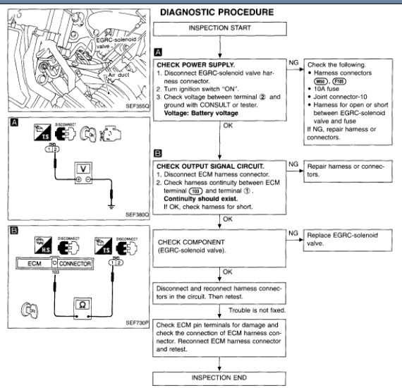

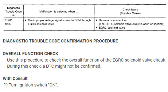

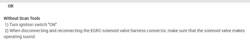

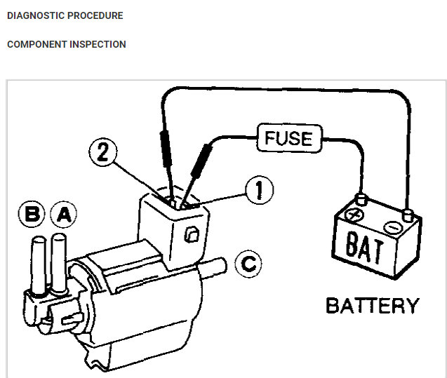

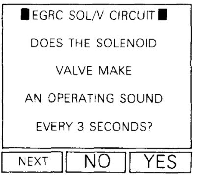

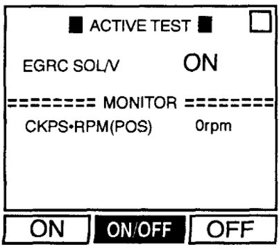

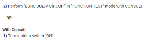

To answer your question, yes. A faulty EGR valve will cause your car to stall, not start and cause all kinds of drivability issues. I've attached below picture diagnostic steps for the EGR fault code P1400 on your car. Here is a wire testing tutorial for you to view:
Hope this helps and thanks for using 2CarPros.
