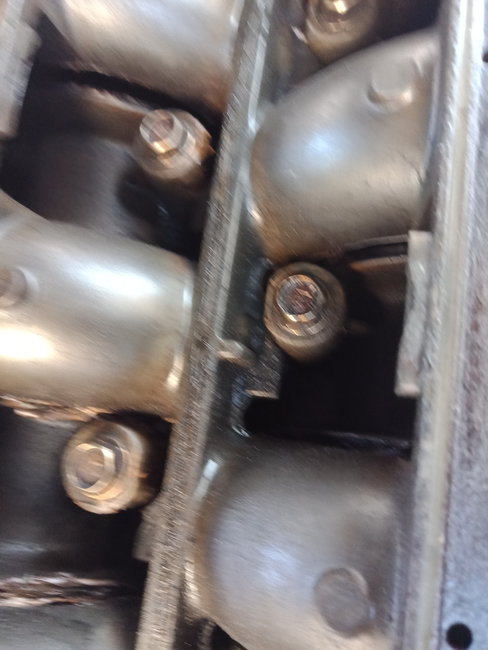

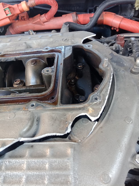

JOABEDALHADI
This is manifold.
Apr 22, 2019 at 10:44 AM
  • 110,241 POSTS
That appears to be the intake manifold. Honestly, that is as unusual as they come. Was the vehicle running properly prior to this happening? Was there any backfiring indicating a timing issue? Also, I have to wonder if the manifold was properly tightened in sequence and to the proper specifications.

JOABEDALHADI
Yes, well, this problem has been repeated twice a month. I do not know the reason for this problem. I want to know the causes of this matter and I checked the Bojaji Slim Eridium and I checked the gasoline sprays properly. I do not know the cause of this matter.
Apr 22, 2019 at 11:47 AM
  • 55,402 POSTS

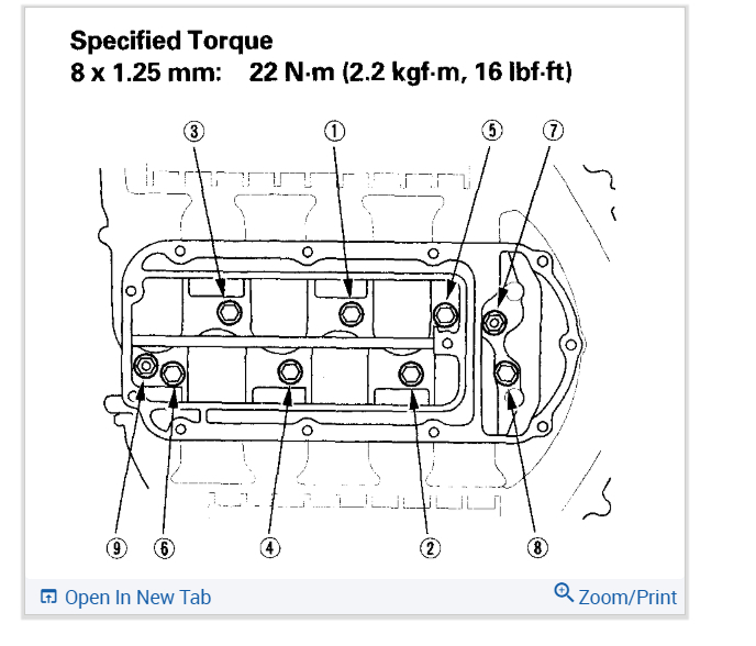

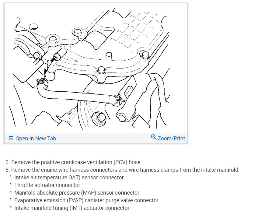

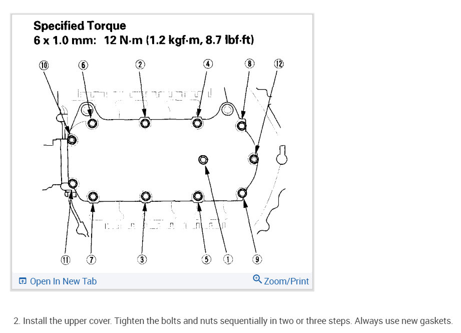

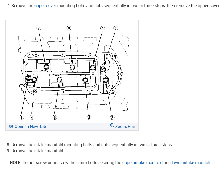

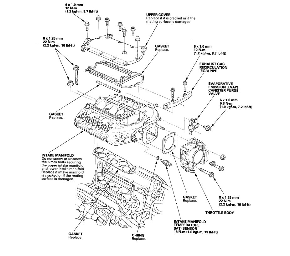

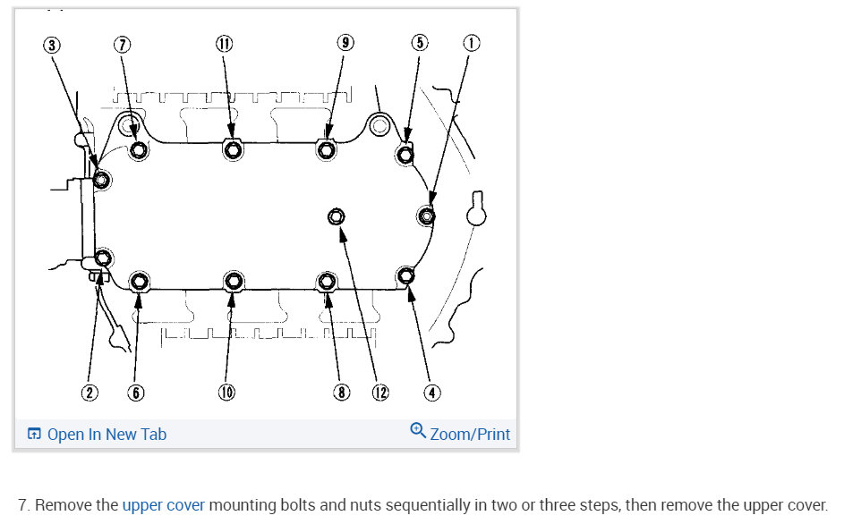

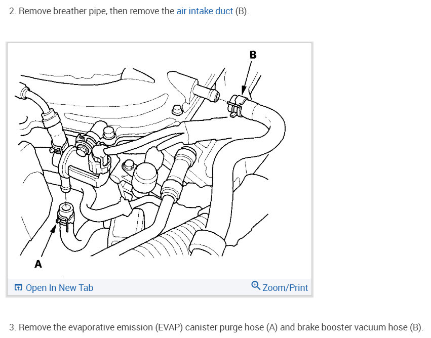

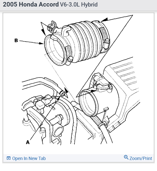

That is a good one, have not seen the intake blow up like that. Before this how did the engine run? Could it be someone is messing with the engine? Can you please shoot a quick video with your phone so we can see what's going on? that would be great. You can upload it here with your response. Here are instructions and diagrams so you can replace the intake manifold. Here is a guide to help walk you through the steps with steps for your car below:
https://www.2carpros.com/articles/replace-intake-manifold-gasket
