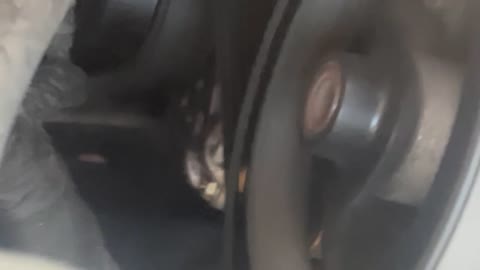

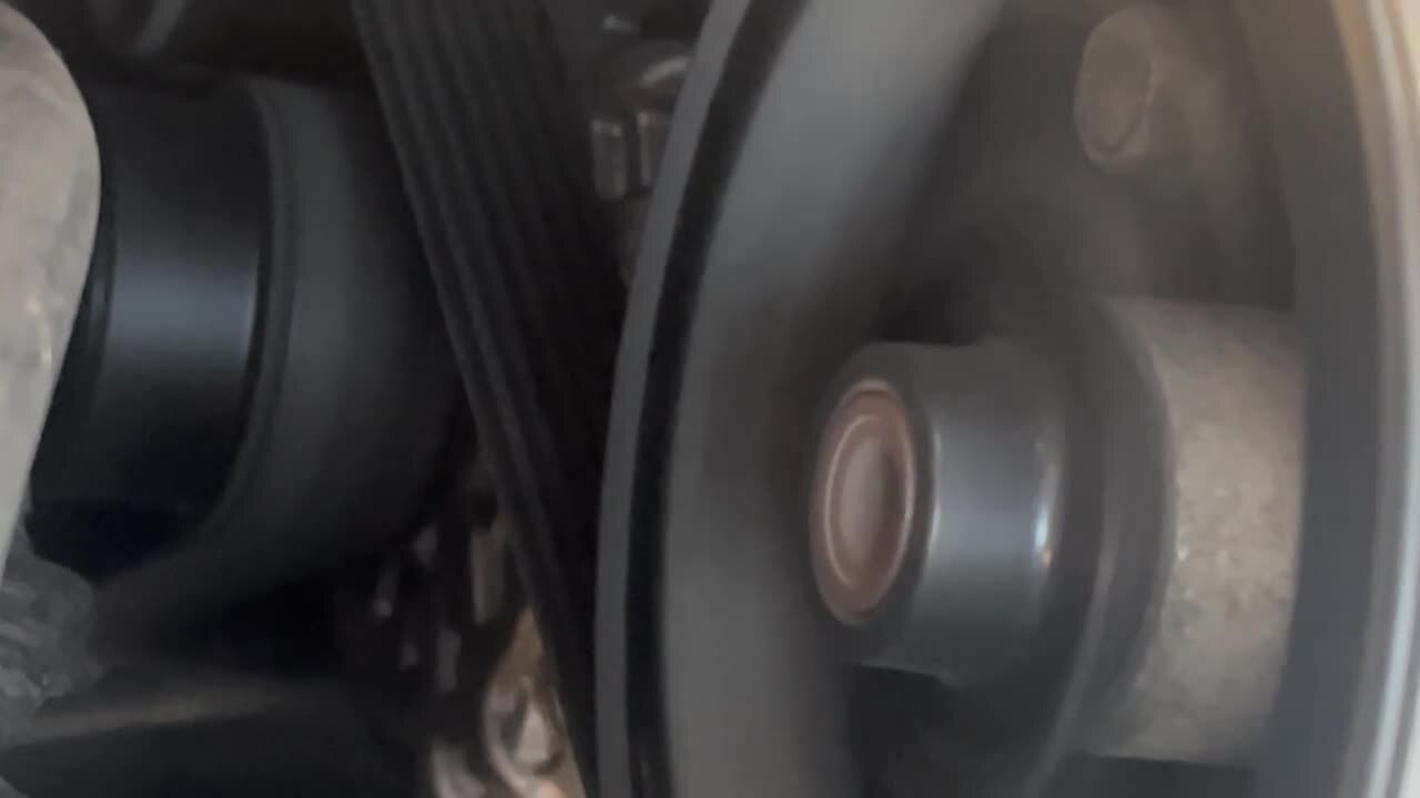

Had my alternator was replaced in Feb 2023 and about 2 weeks ago started making this noise! Please help.
Apr 25, 2023 at 4:45 PM
  • 55,214 POSTS

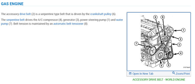

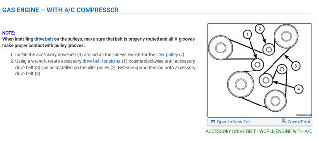

O' boy, thanks for the video. It sounds like the new alternator is defective and needs to be replaced again. To be sure I would remove the serpentine belt and rotate the pulleys individually. You should be able to feel the rumbling in one of them, try the alternator first.
Here is how the belt is removed:

Hello, it’s a $200.00 unit and yes, but just not as loud. In my video I posted does the belt look like it’s on right?
Apr 29, 2023 at 3:45 AM
  • 55,214 POSTS
Yes, the belt looks like it is on correctly. I would remove the belt and tun each pulley by hand to help confirm the noise is coming from the alternator and if so may try a different brand or try to get another one.
