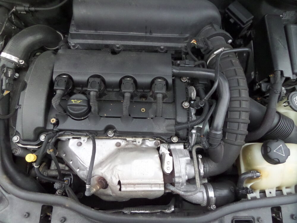

First, thank you for your information. I suspected that might be the case. I was able to take a look under the car, but with only minimal knowledge and lack of a schematic, i’m not sure what component has the leak. The drip seems to be emanating from the middle front of the engine. Does the turbocharger live somewhere in that vicinity?

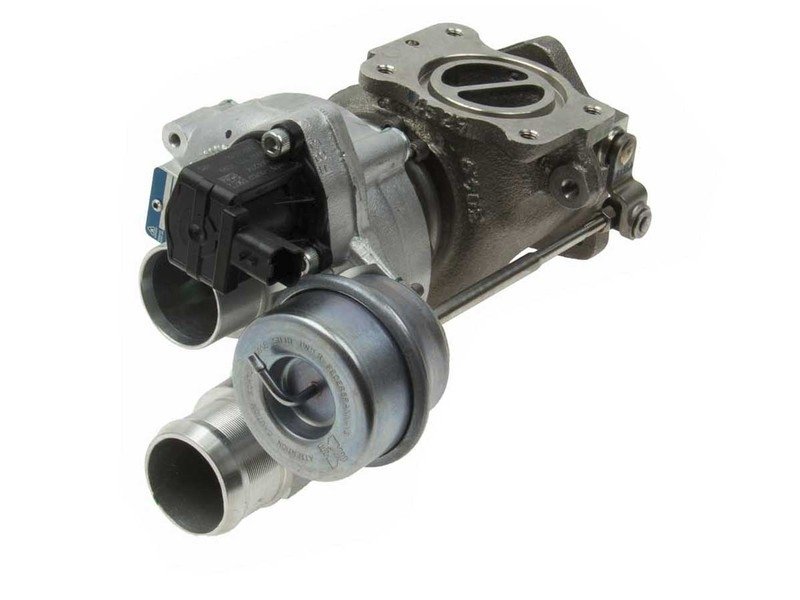

The turbo is mounted under the heat shield in the front of the engine, just about in the center. The pictures are what the turbo looks like in the open and installed. The bright shield is over the turbo. The catalytic converter bolts to the bottom of the turbo.
