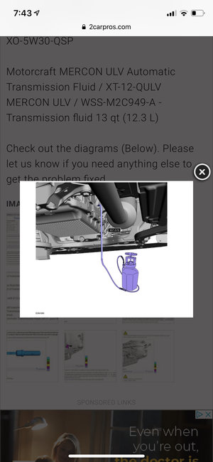

I have seen images like this, what is this things purpose if not to drain transmission fluid?
Dec 31, 2018 at 10:44 AM
That is for removing the fluid from the pan. not needed.
When you remove the bolts, tilt the pan toward the drain pan to remove the fluid.
Use a funnel to install the fluid.

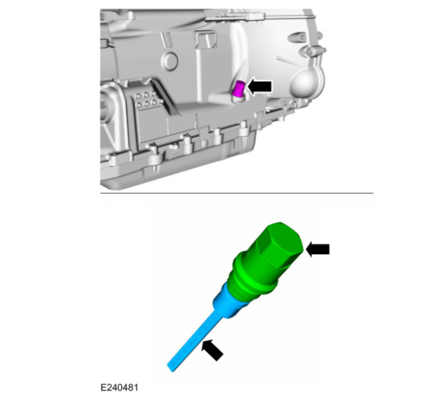

I am sorry. This transmission gets filled from under the car at the fill plug.
There are two transmissions and the one for yours shows this. I attached a picture for you to view.
the pump you showed earlier looks like a good tool to use to add the fluid. just be sure you do not overfill the fluid level.
