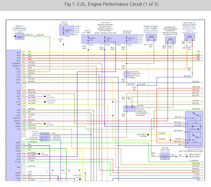

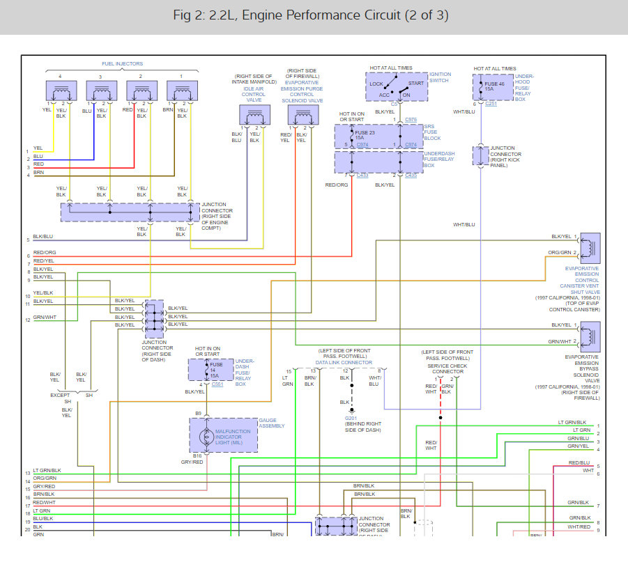

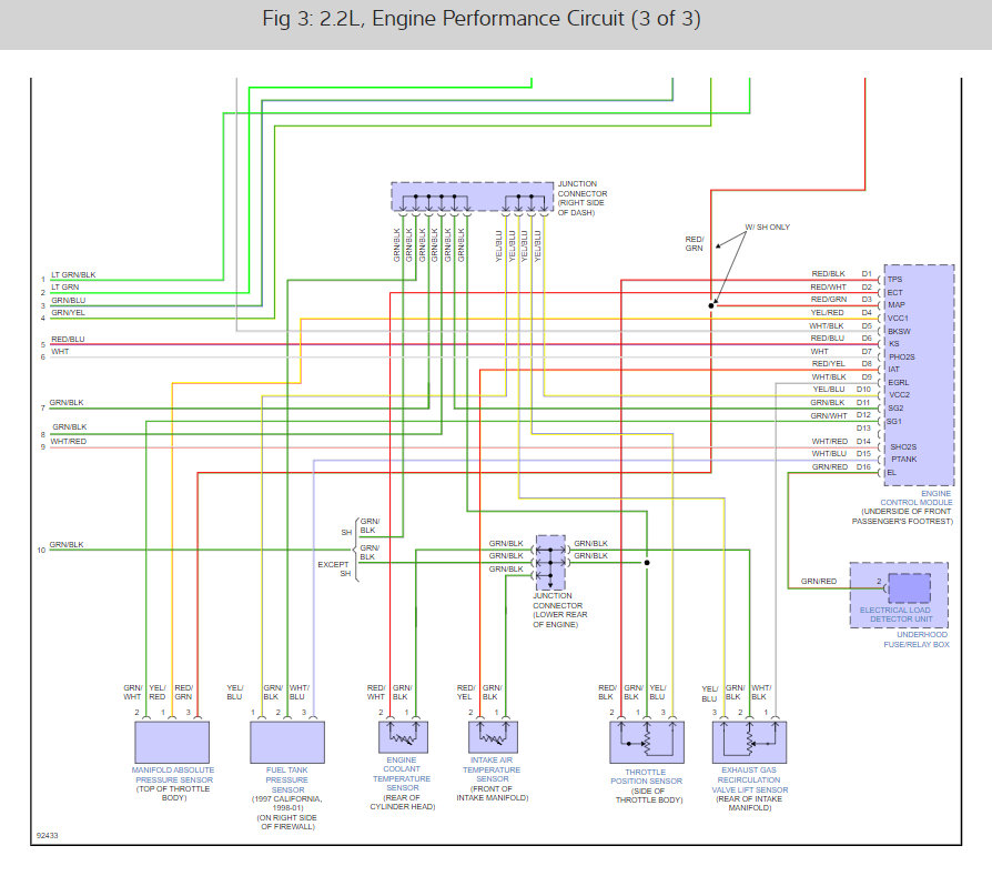

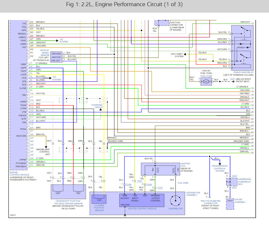

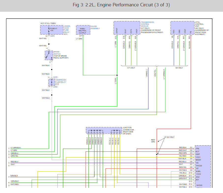

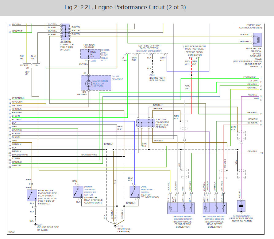

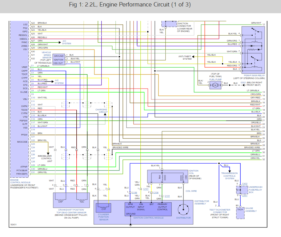

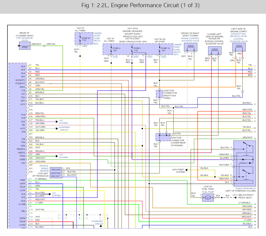

Can I get the main relay wiring diagram?
200,000 MILES • 2.2L • 4 CYL • 2WD • MANUAL
DLUDER
H23a 11.5 comp pro1 cams tuned on Hondata.
I had it tuned perfectly, but it started getting lean at times and bucking at cruise. I replaced the entire fuel system, sensors, a lot of wiring, ECU, hondata, distributor, checked tune multiple times, re-tuned, had professional check tune. I think something is causing interference or back-feed to ECU but no Check Engine Light. However, it'll get a solid Check Engine Light with chrome chipped ECU. I'm lost and I need help. Relay wiring diagram would help.
Aug 13, 2022 at 3:12 AM
  • 55,694 POSTS

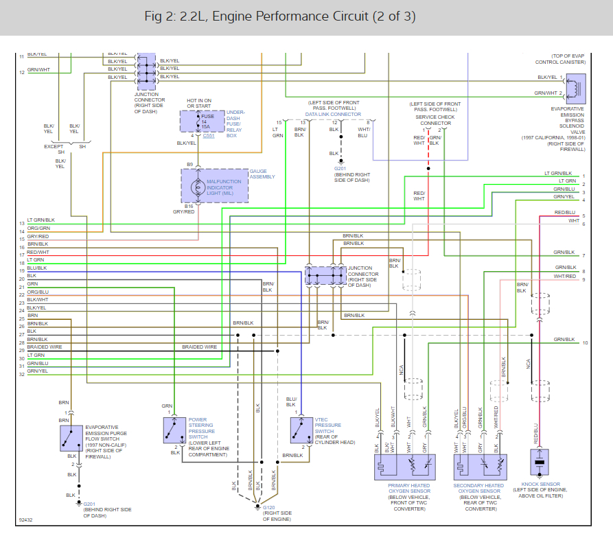

Does the car have any codes? This guide will help you run them also, recheck all engine and body grounds. Here is a guide and the engine with main relay wiring diagrams for your 2000 Honda Prelude in the images below. This guide can help you test the connections.
