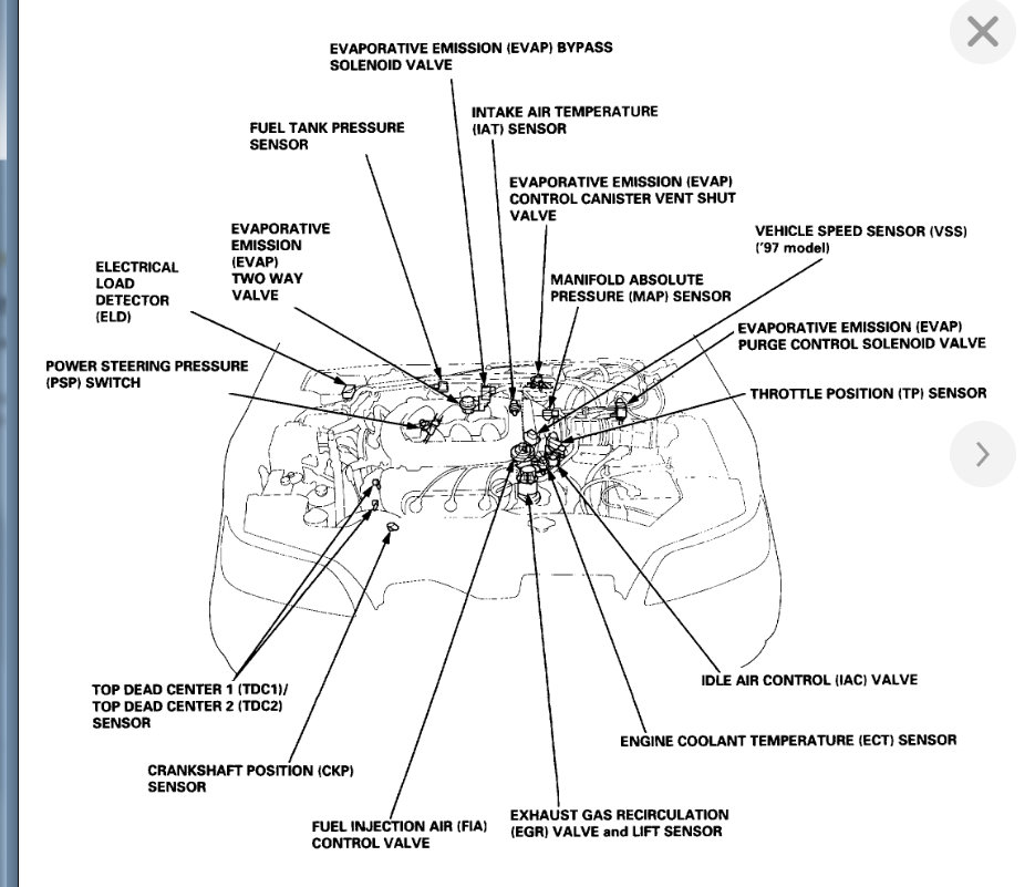

Rough idle. Where is the MAF sensor location? How to remove it?
Jul 4, 2020 at 10:12 AM
Here is a guide on how to clean a MAF sensor:
https://www.2carpros.com/articles/mass-air-flow-service
However, it looks like your engine uses a MAP sensor which achieves the same information but operates differently. A mass air flow sensor measures the air passing by it. A manifold absolute pressure sensor measures the vacuum in the intake and calculates the amount of air flow.
The reason this is important is you cannot clean a MAP sensor like a MAF sensor.
So if you have a rough idle let's start with checking for codes and then check for a vacuum leak and other common causes of this. Here are some guides that will help with this:
