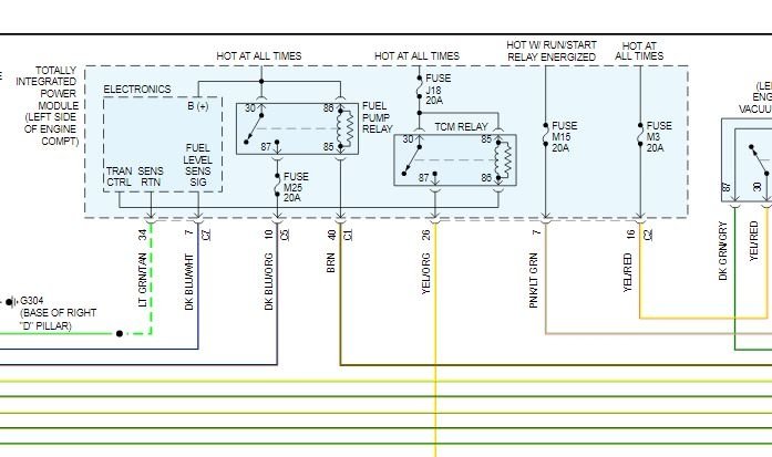

I just had the fuel pump replaced. I’d replaced alternator and battery then figured a parasitic draw finally. Car battery drained next morning. I finally heard a noise from the back right of the car after is off. I pull fuse M25 marked fuel/dsl lift pump. Noise stops. Help? It is rather quiet sound could it just be the DMTL?
Oct 25, 2020 at 6:01 PM
STEVE W.
  • 15,201 POSTS
I would suspect you have a bad Totally Integrated Power Module, the fuel relay is a common fault on them as on many other Chrysler products as well. The relay fails with the contacts welded on and removing the fuse stops the power from going to the pump.

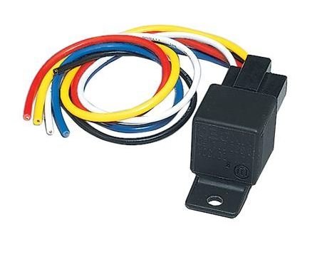

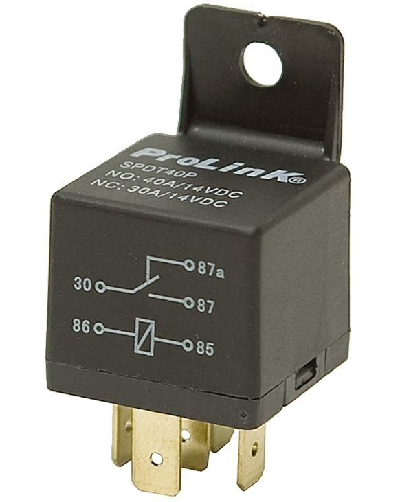

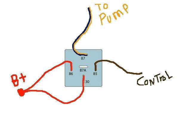

If you wish to do the bypass you need a relay with a socket similar to the ones shown. Then you need to look at the wiring that goes into the TIPM. You will need to find the fuel pump control wire, that is a Brown wire that goes into connector 1 pin 40 under the TIPM, Next you need the power feed to the fuel pump itself, That is a Dark Blue wire with an orange stripe that comes out of pin 10 in connector 5 under the TIPM.
Now you need to mount the relay in an area where you can reach it with those 2 wires. Then you will need an inline fuse holder to fit the fuse from M25. You will also need a ring terminal that fits the stud on the TIPM as that will be where you draw power from.
The ring terminal will attach to two of the wires on the relay socket, those go to pins 30 and 86 on the relay and provide power. Then you take the inline fuse and connect it to the wire that goes to terminal 87 on the relay. The other end gets connected to the dark blue wire with orange stripe from the TIPM harness, it will provide power to the pump from the relay.
Then you connect the wire from pin 85 on the relay to the Brown control wire that grounds the relay and turns the pump on and off. With everything connected the pump should operate properly for a long time.
This site shows the process with the OE kit but the kit gets wired in a bit different, and depends on another light duty relay in the TIPM to do the switching.
https://us.autologic.com/news/chrysler-total-integrated-power-module-tipm-fuel-pump-circuit-failure
