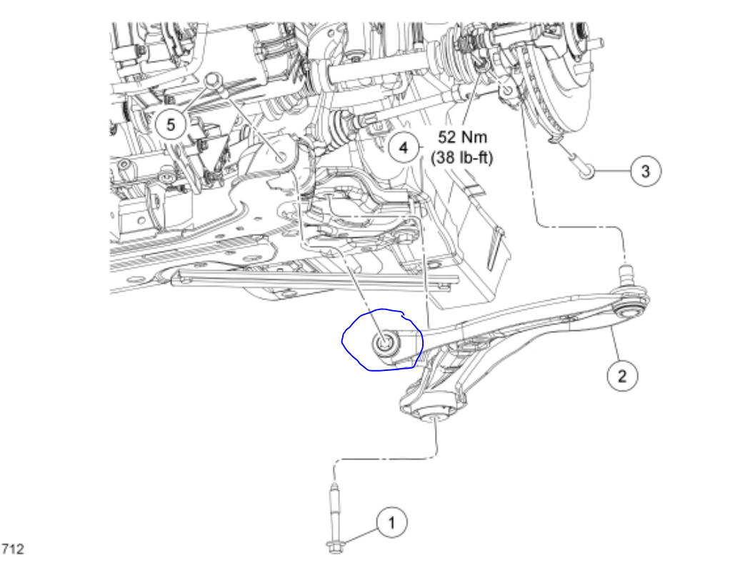

My neighbor is trying to change his lower control arm bushing. he got the bolt off where it goes attaches near the rotor but it is seized on . He got the bolt off for it but it's still not wanting to come off. We tried wd-40 to penetrate it but still nothing. please help.
Jul 26, 2021 at 3:28 AM
Good evening,
The bushing is pressed into the control arm. You need a bushing press to remove and install the bushing.
https://www.2carpros.com/articles/lower-control-arm-bushing-replacement
I attached a picture of the arm and circled the bushing for you.

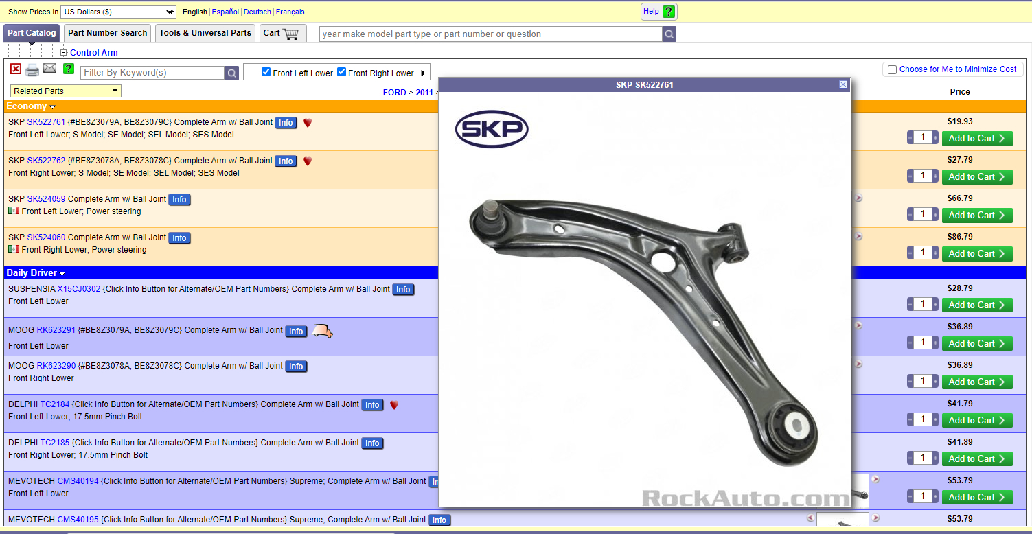

It would be better to replace the entire arm. Rock Auto has a replacement for $20.00. I attached a picture for you.
