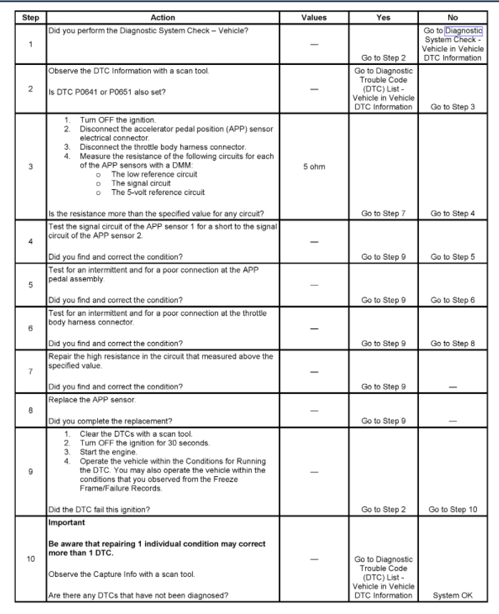

No acceleration, replace the acceleration pedal sensors, didn't help too much. I cleaned MAF sensor. i got 3,500 RPMs in neutral. I was coming home one day last week, and it lost acceleration. The engine starts up fine, when I press on the accelerator in park the engine will top at 3,500RPMs then lower to 2,500RPMs at full throttle. Harold Billiot

When i put it in gear it does move, some but the engine whines. I didn't push it too hard, and just drove it for about 5 minutes. These were the code's: p1791 (pending), p0700 (pending), p2138 (pending), p1125, p2120, p2125, and p2138. When have it in park and give it gas, 3,500 RPMs and engine surge's, from 3,500 to 2,000 rRPMs.

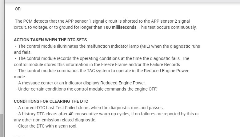

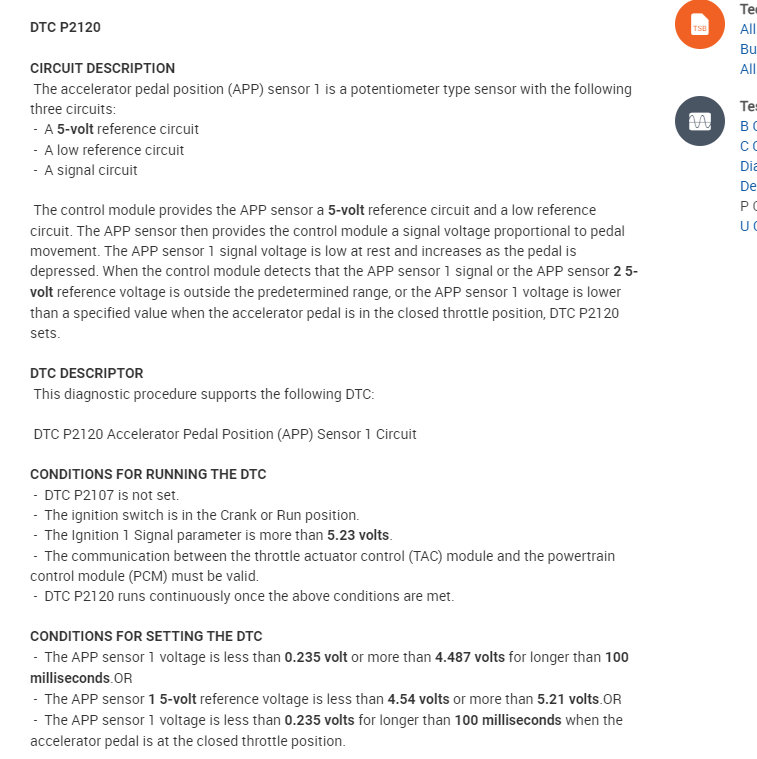

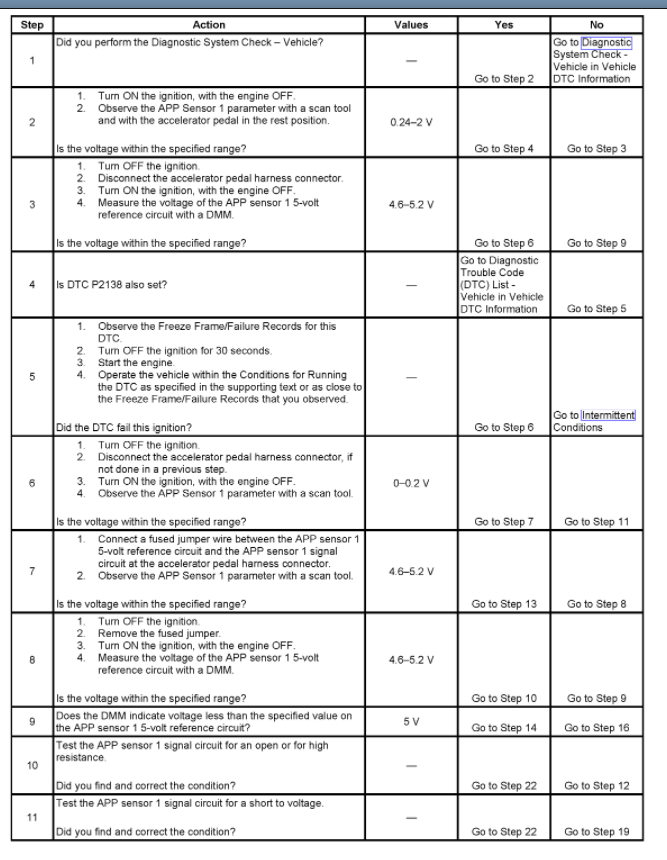

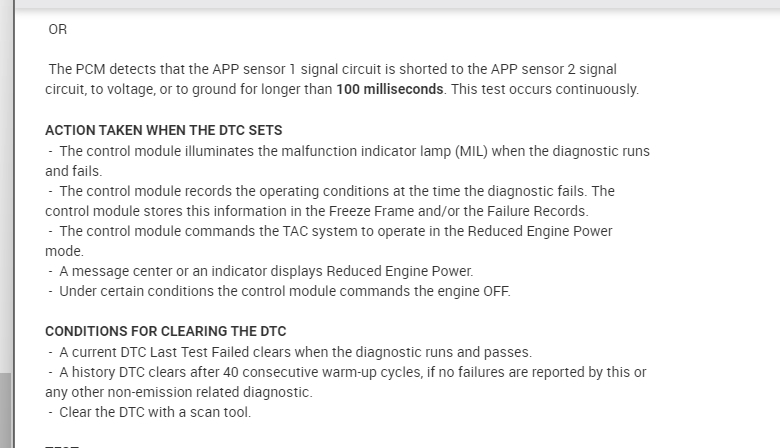

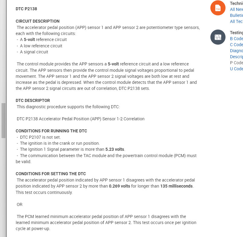

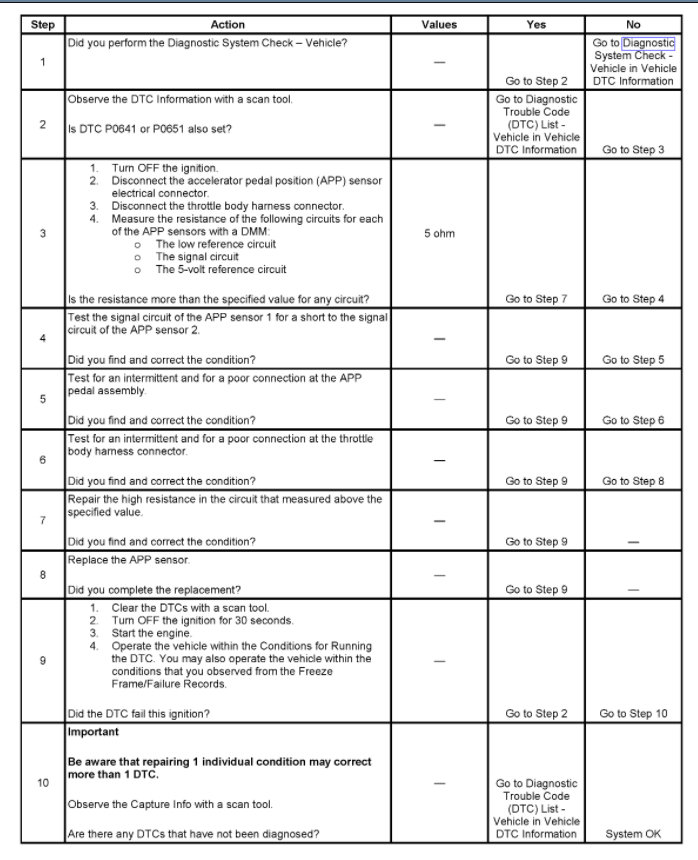

Okay. That is great info.
We have a 5-volt reference issue.
So, we need to run through this testing which basically points you to the P2138 code. I attached all this testing below for your review.
Please run through this and let me know what questions you have on this.
Thanks

i replaced the transmission fluid with premium full synthetic BG automatic transmission fluid pn..31232cc.. it runs good and strong. thanks
Jan 23, 2022 at 6:35 AM
That is great news. So those 5-volt reference codes were most likely old codes that have not cleared yet.
