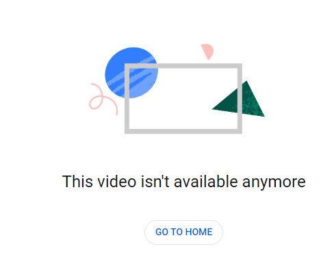

I tried to watch the video, but it indicates that it's no longer available. See pic below
