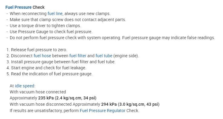

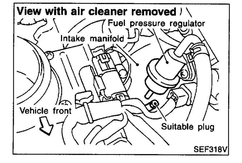

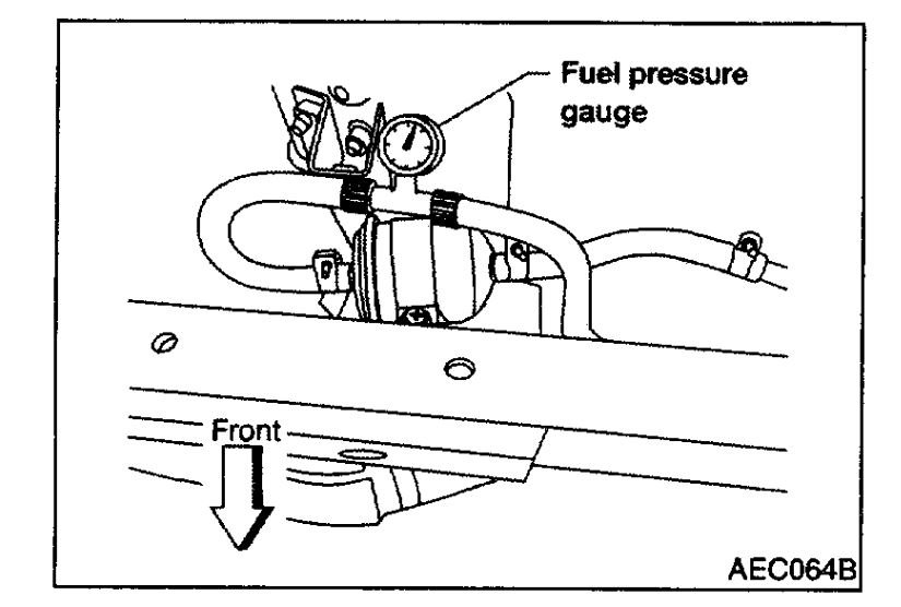

Good morning,
This could be from low fuel pressure. I would check the actual pressure.
It could also be a clogged catalytic converter. If it is blocked, the engine cannot breathe and will result in low power.
https://www.2carpros.com/articles/engine-has-low-power-output

Okay, back to fuel pressure.

Before i replace fuel pump, I noticed i could hear fuel pump come on. does that mean fuel pump is okay?
Feb 26, 2020 at 7:39 AM
No, it does not. You can have the pump working but if the pressure is too low, it will cause your issue.
