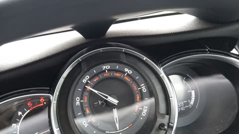

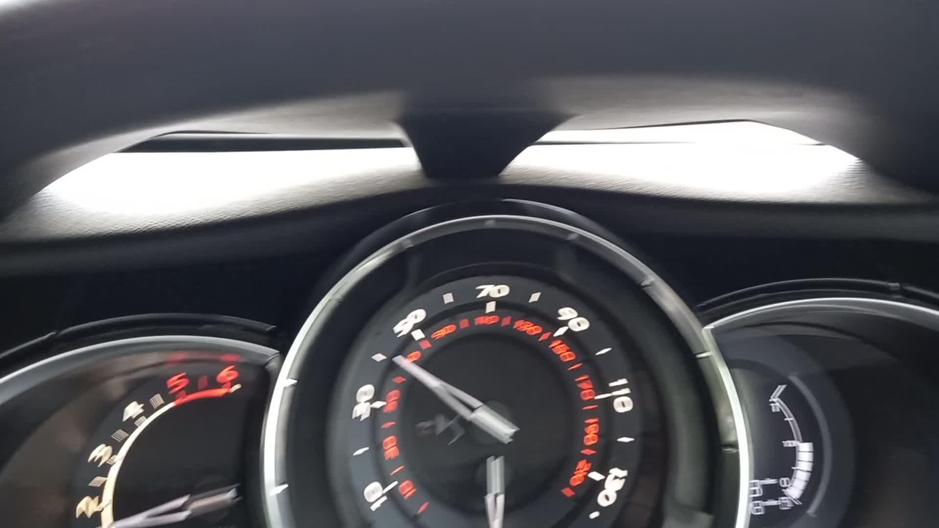

JONNYHJ
Hi thanks for the reply! Very much appreciated.
I've discovered it's actually loudest at 52 MPH in 4th. This is what the recording is of. Makes no difference if hot or cold. Think though it does on and off make it in most gears between 42 and 52 but engine noise and road noise make it harder to hear.
It does make a whine at other speeds and gears but it seems to be random when and where etc. So it's easier just to say 4th at around 52 MPH.
It does get quieter when I take my foot of the accelerator I think. Not sure.
It's done such low mileage and has been responsibility driven since new. Surely it shouldn't be a gearbox issue...that really sucks.
It pulls well through each gear and does seem to go away the faster it gets and I'm realising now it isn't noticeable at lower speeds as I said. Its very hard to pinpoint it. But I'll avoid sitting at 52 in 4th and accelerate past it, or stick in 3rd until I can sort it.
Thanks again, hope the recording is clear enough.
Hope you can hear the background whine in the video.

  • CAR REPAIR CONTRIBUTOR
I can make that out. It may sound unlikely but I think that is tire noise. It is not uncommon for tires to make that faint whining noise in all different speeds and gears.
If I am correct then I suspect it will get worse until the point it is doing it basically all the time.
I would suggest starting with checking the tires and see if there is any wear on them. Below is a chart that will help with this.
Then I would suggest rotating the tires and see if the noise moves to the rear of the vehicle.
