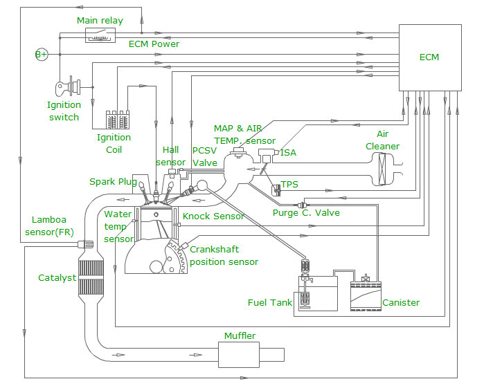

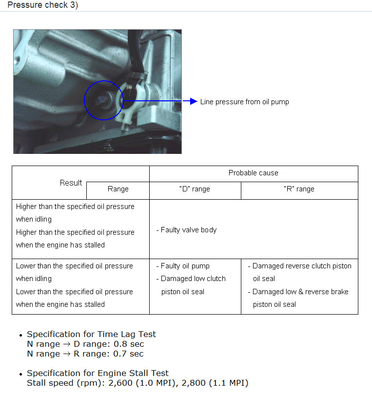

Unfortunately, I do not think it has on either. The only sensor diagram I could find was this one. See attached.
May 7, 2016 at 11:26 PM
HAWX
  • 33 POSTS
Hi Ed,
Unfortunately, I do not think it has on either. The only sensor diagram I could find was this one. See attached. The one previously uploaded was in the tech troubleshooting manual.
May 7, 2016 at 11:27 PM
