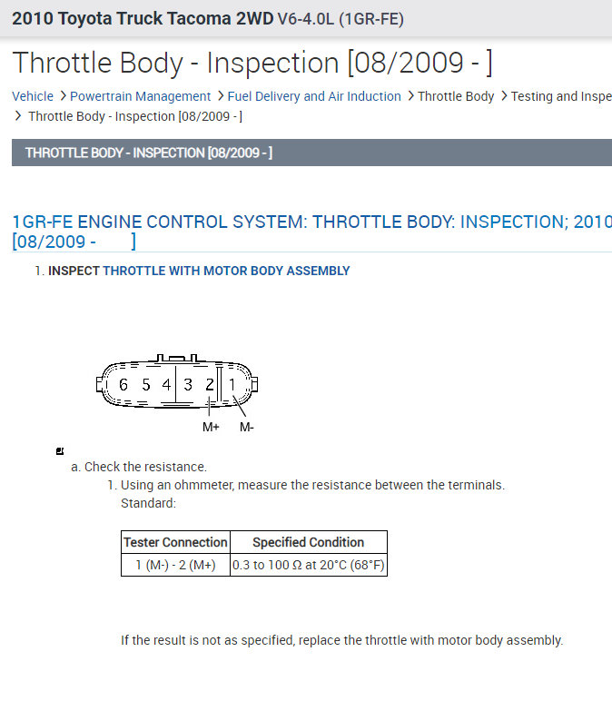

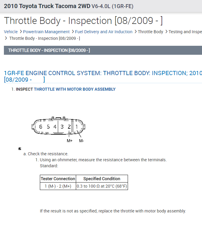

This could be due to a calibration issue with the throttle body. If the resistance value is off then it can impact the idle speed. As this is a drive by wire, there is no manual adjust like the cars of the past.
Sep 10, 2021 at 2:14 PM
EALBA27
  • 6 POSTS
I had replaced the throttle body awhile ago, and figured that might have been the issue and used the warranty to get a new one and it’s still doing the same thing. I’ll check the calibration with an ohmmeter and see if it’s off.

The calibration was fine, now the problem is the RPMs drops pretty low to only 550 RPMs when I press the brake pedal while in drive and it’ll pop up for like 5 seconds and go back down to around 500 RPMs. if I let go of the brake pedal it’ll go back to normal range. I have no codes. Could it be a shortage ? The idle is now fine in drive or neutral regardless if A/C is turned on or off.

The calibration was fine, now the problem is the rpm drops pretty low to only 550 rpm when I press the brake pedal while in drive and it’ll pop up for like 5 seconds and go back down to around 500rpm if I let go of the brake pedal it’ll go back to normal range. I have no codes. Could it be a shortage ? The idle is now fine in drive or neutral regardless if A/C is turned on or off.

Usually when the RPM drops when depressing the brake pedal, it points to a vacuum leak. As you have to use the brake booster vacuum to operate the brakes.
Most of the time, when the throttle actuator is faulty it will trigger the check engine light.
