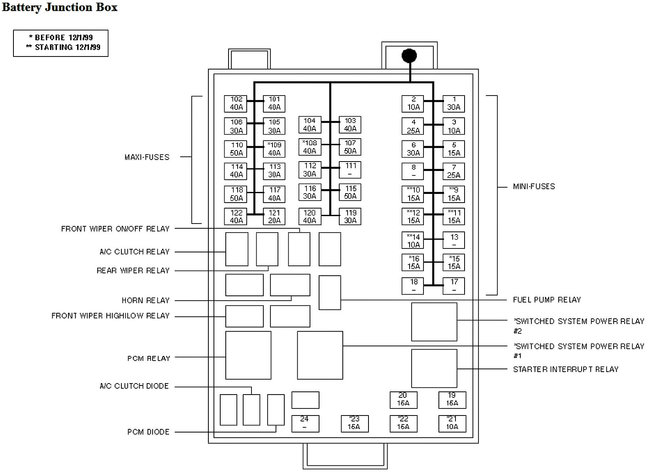

Replaced the bulb and checked fuses, both high beams work but drivers side low beam does not work at all.
Monday, October 29th, 2018 AT 5:05 AM
3 Replies
  • 109,885 POSTS

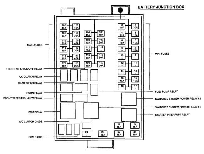

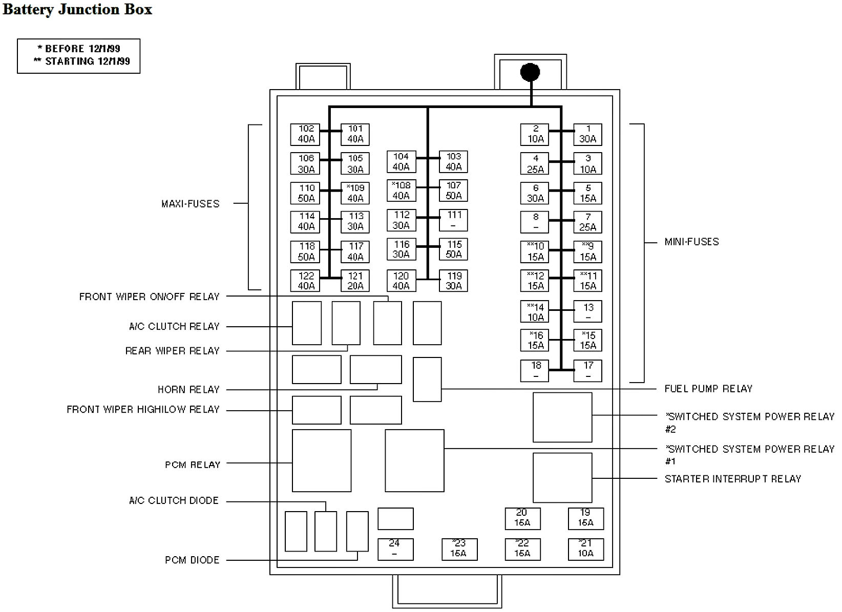

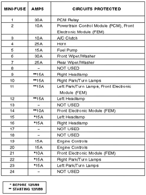

First, did you check both fuses in the under hood fuse/relay box? One is for the left and the other the right. See the attached pictures.
If you are confident that is not the issue, then you need to check if there is power to the light socket itself. You can use a test light for this.
If there is power, suspect a bad socket. If there is no power, I then what you to switch switched power relay 1 with a different relay in the box that has the same part number. See picture 3 for relay location.
Do this and let me know what you find.

I did check the fuses. One fuse controls both high and low beams on a single side so that is not the problem, the high beam still works. But my husband found and fixed the problem! The white wire had been severed! Thanks for the help, both high and both low beams work like a charm, even shut off the 'light' light on the dash!
