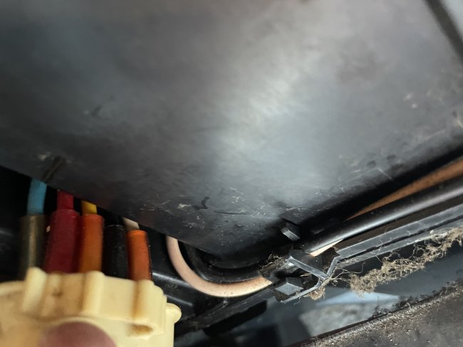

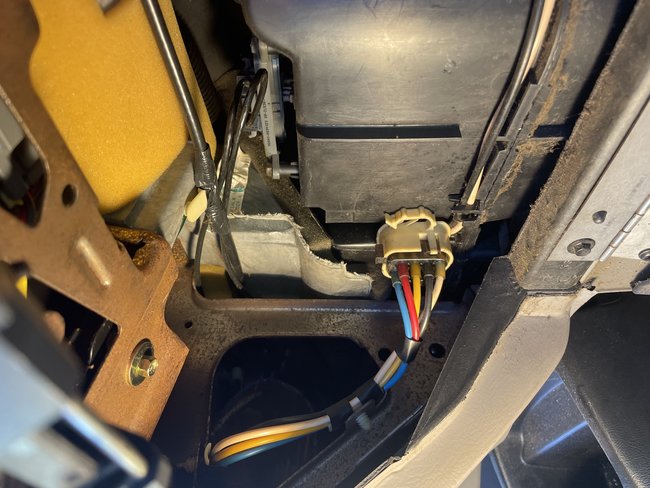

The airflow direction is controlled by a vacuum-operated mode door. There is a chance the vacuum is weak, there is a small leak, or the actuator is going bad.

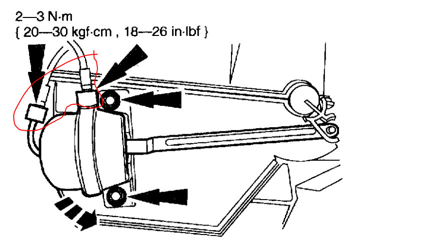

If you look under the dash, there are two actuators to look for. One is the panel/defrost and the other is the panel/floor actuators. I attached pics below.
Here is what I need. First, pay attention to see if there is any airflow from a different location when the panel is selected. If there is, the first pic is the panel/floor actuator and the second is the panel/defrost. Focus on the one that seems relevant.
If there is no air coming from a different location, with the engine running, see if you can hear a hissing or anything that could indicate a vacuum leak.

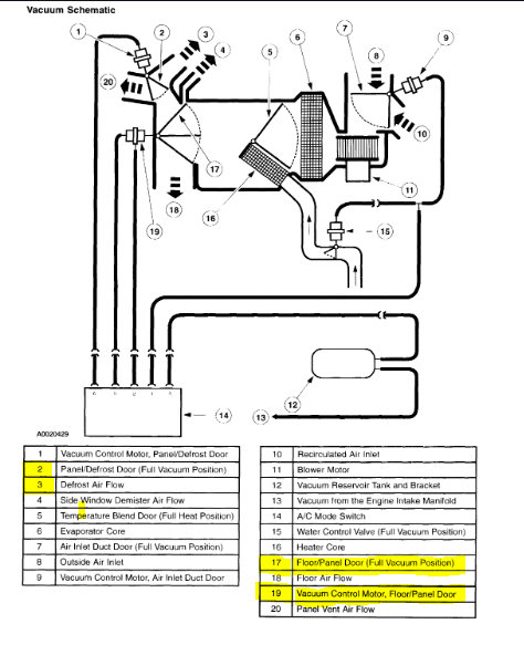

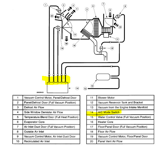

Do me a favor. Take a look at the schematic below and let me know if your vehicle appears to be set up the same way. Everything I'm seeing shows the mode doors are vacuum and there is more than one.
See pic below.

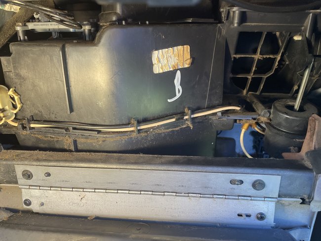

Good vacuum. Checked the line from reservoir and there was still vacuum when I pulled off hose. No other vacuum actuator, only fresh air on right.
I do believe there is a solenoid actuator right next to the blend actuator.
The solenoid does get warm. You can see it in one of the pictures.
P/n 1F20-61-K1Z
Sunday, August 21st, 2022 AT 7:03 AM
  • 109,878 POSTS
Which picture are you referring to? Is it one that you already attached?
If the vacuum is good, have you watched to see if the actuator is responding? Also, everything I have shown is more than one vacuum actuator. I looked at your second pic above and there are five vacuum hoses I see in the pic. Where do they all go?

Here is s pic of vacuum fitting.
Monday, August 22nd, 2022 AT 7:38 AM
  • 109,878 POSTS

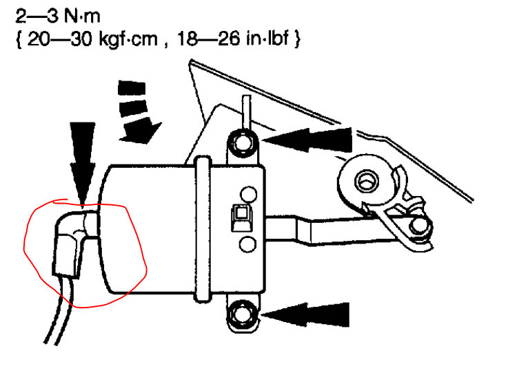

That appears to be the A/C mode switch. It shows the vacuum going to the panel/defrost actuator. I highlighted it in the pic below.
If that actuator is getting vacuum and not leaking, there could be an issue with the door itself.
See pic below.

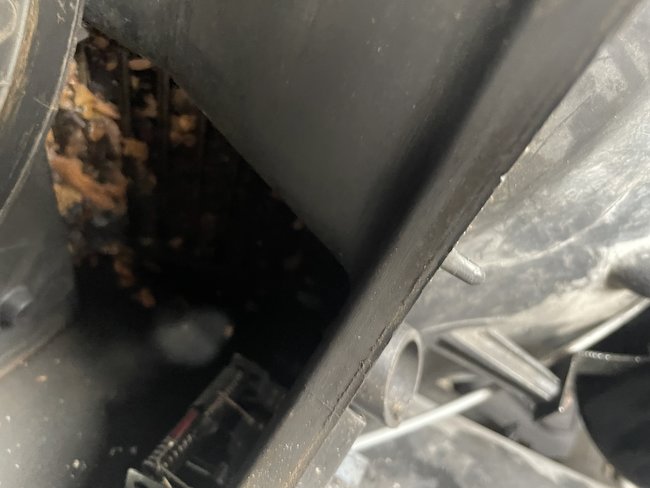

Mystery solved.
Removed blower motor and found a clogged evaporator core. I took a shop vac and a garden hose to flush out debris.
Thanks for your help in trouble shooting this issue.
Full air flow now.
Saturday, August 27th, 2022 AT 11:27 AM
  • 109,878 POSTS
Thanks for the update. It certainly looks clogged. Regardless, I'm glad it's cleaned out and working properly for you.
