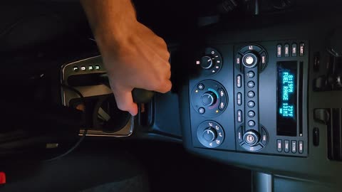

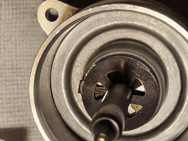

Is this a symptom of bad mount, or transmission going bad it something else?
I've noticed "hard shifting" for a while, but this is much louder with extra clunk after draining transmission fluid and replacing filter.

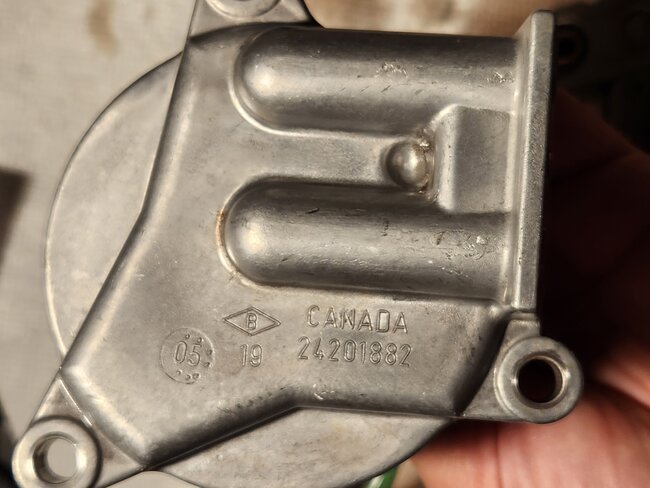

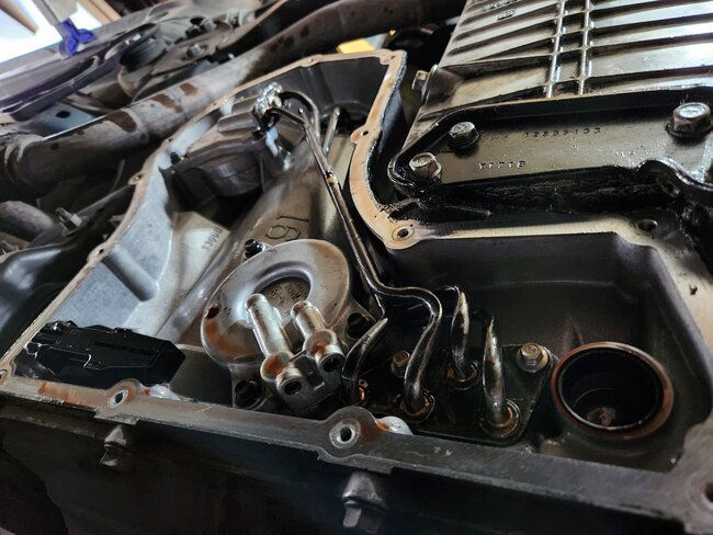

From your pictures, it looks like you removed one of the band servos. If there is a fluid leak from the servo, it could cause the symptom you are having due to loss of fluid pressure or possible aeration of the fluid. I would make sure there are no damaged o-rings or seals.

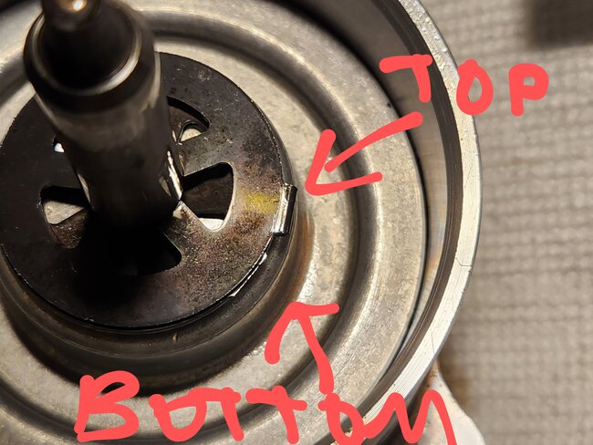

In that servo there are two metal rings with holes that are on top of each other. Are they supposed to be connected or not? It kind of looks as if they were two pieces joined by a lip that broke off? But maybe that's how it is supposed to be? The two pieces rotate independently...

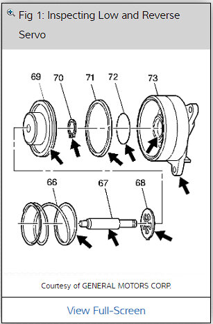

So, your transaxle is the 4T45-E. The '65' is used with the 3.9l engine. Here is a disassembled view of the Low-Reverse servo. The springs you are referring to were probably joined by that metal tab to make it easier for assembly at the plant. Replacement springs come as two pieces. It's hard to tell from the pictures, but is there any scoring or gouging of the servo pin? It needs to be smooth.
