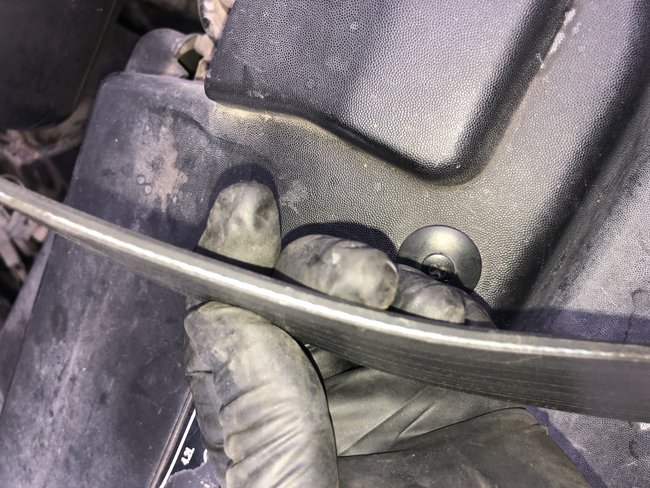

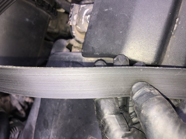

The video is helpful. I certainly hear it. If you have a line on the belt indicating wear, are you certain the belt pullies are aligned, and the belt is riding flat on all pullies?
Open the hood and locate the wear mark and then by eye, follow the belt around to see if it is not aligned on one of the pullies. Also, if you could upload a pic of the belt wear mark, it may help me.

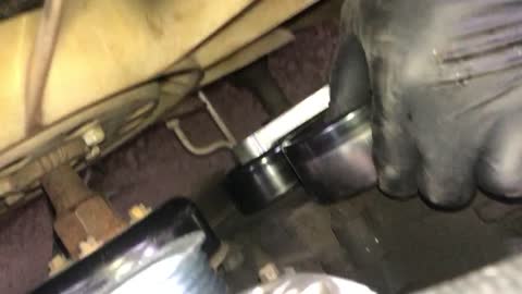

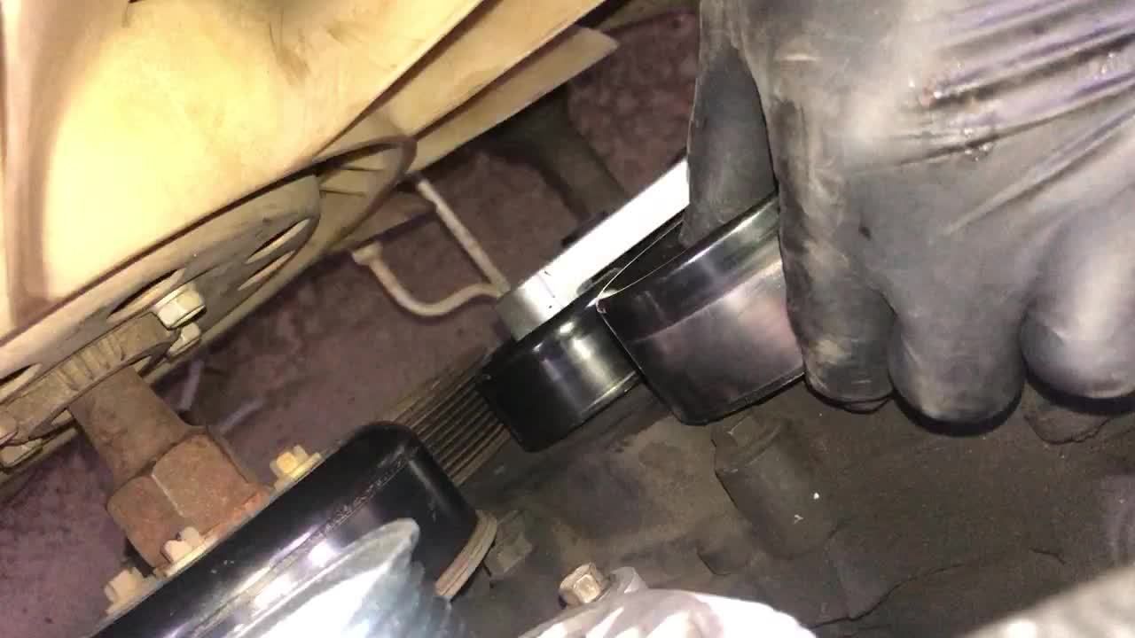

Okay. so, I have a very slight in and out and up and down movement in the water pump but have a large amount of in and out on the power steering pump pulley. I have attached videos of those and also pictures of the belt which has less than 500 miles. Thanks in advance for the help. Also in the video is the idler pulley I put when belt was changed. Thanks in advance for the help. FYI, I’m in south Louisiana and pertaining to the clutch fan it’s done it whether it has been hot or cold outside. that said last week we had a 33-degree temperature drop in 8 hours.

Here are the photos of belt.

The power steering pump shouldn't have that much play. The water pump has a bit more than I would like to see, but if it isn't leaking or making noise, it's likely fine.
The mark on the belt, was that toward the engine or away from it?
Let me know. I have a feeling the pump is bad. Make sure the pulley itself isn't loose.
