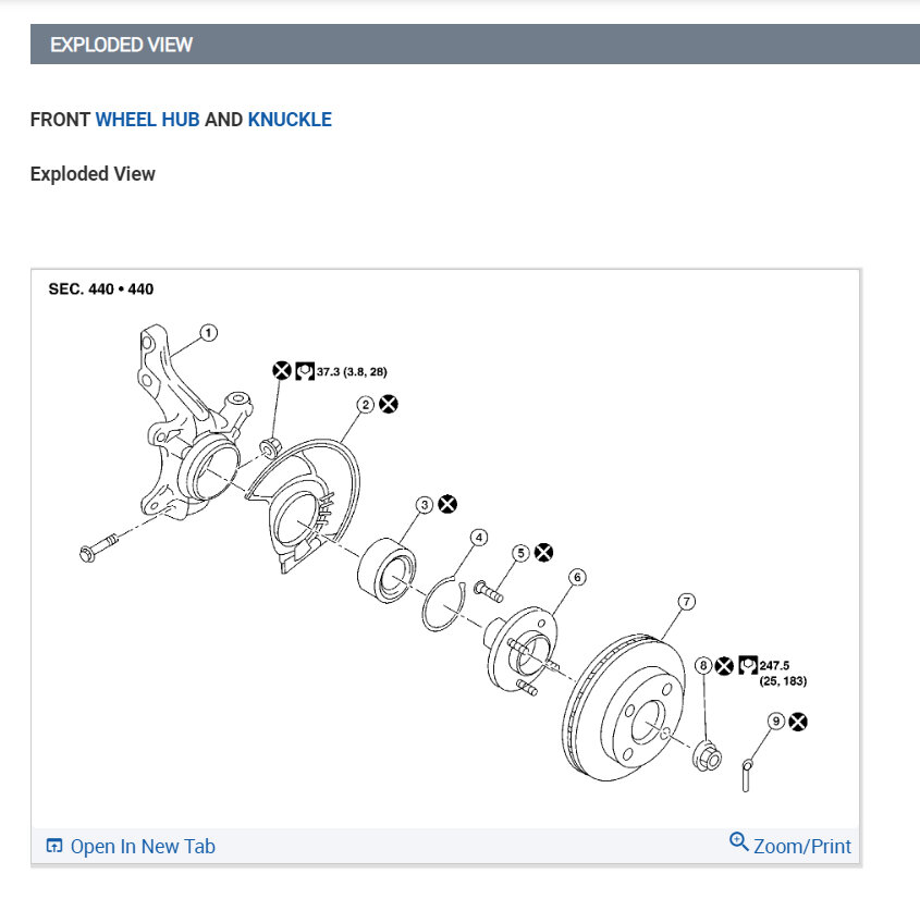

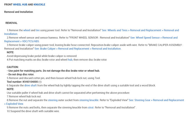

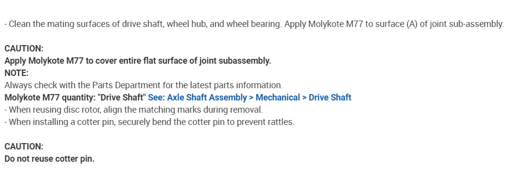

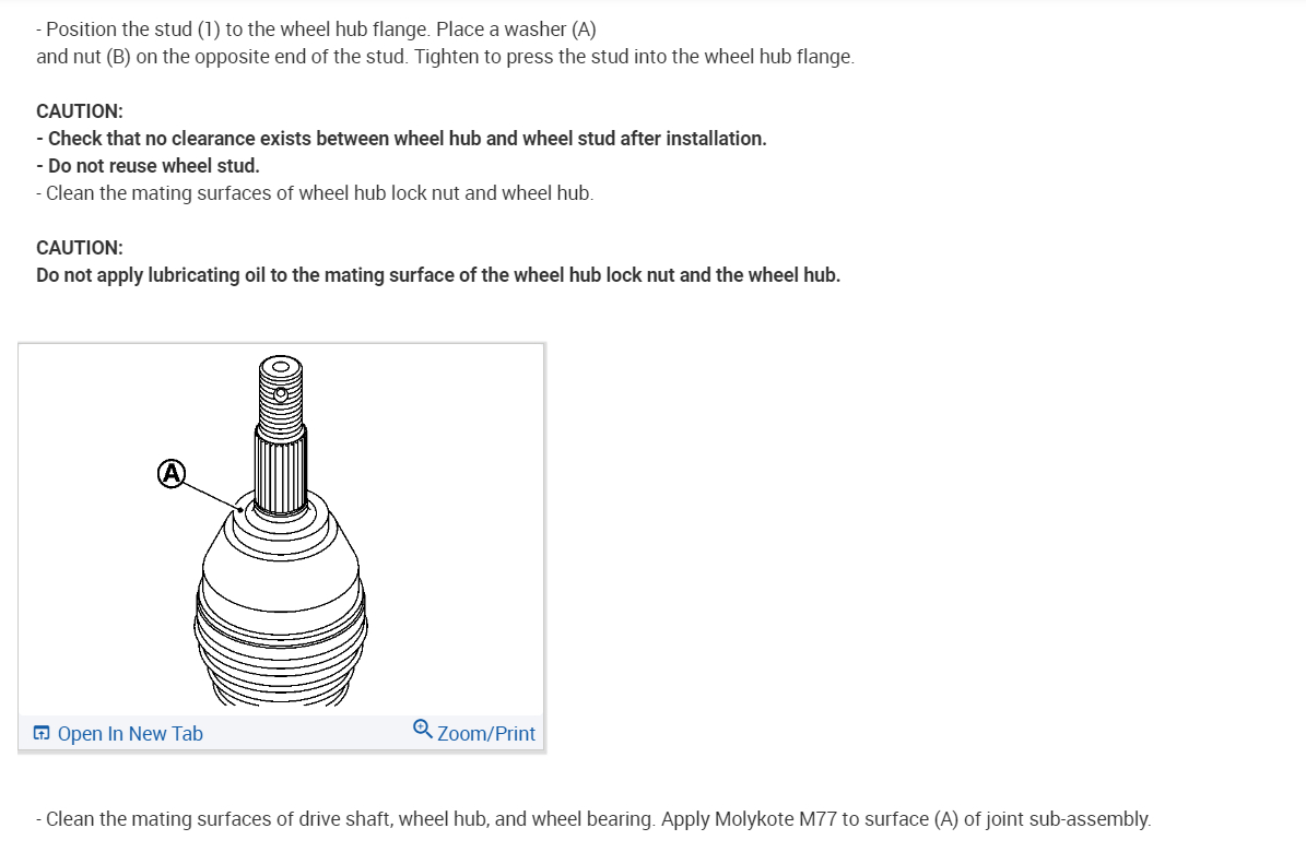

It sounds like you have a bearing hub that has gone bad, when you go around corners does the noise change. If so, this is a good indication that the bearing hub is bad. Raise the front of the car and grasp the wheel to see if there is play in the bearing.
Can you please shoot a quick video with your phone so I can hear the noise? That way I can tell for sure what's going on. You can upload it here with your response. Check out the images (below). Please let us know what you find. We are interested to see what it is.
