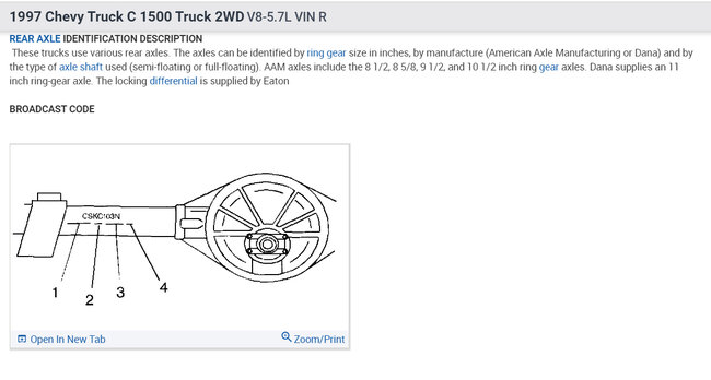

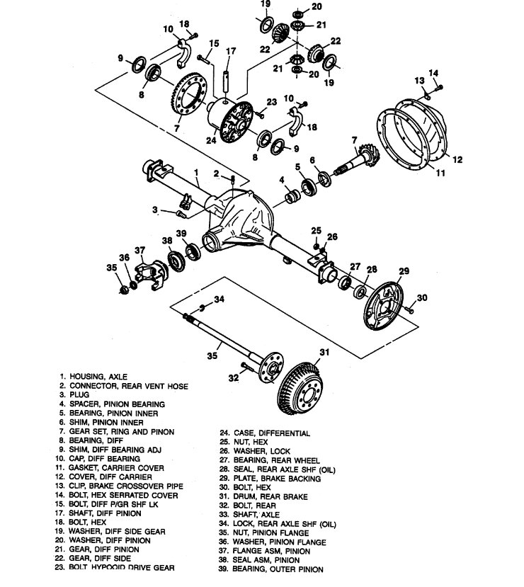

You are on the right track with the rear end swap. It sounds like the ring and pinion are worn out which is common when towing, please check out the information and instructions to do the job, make sure the gear ratio is the same FYI. Check out the images (below). Please let us know what happens.
