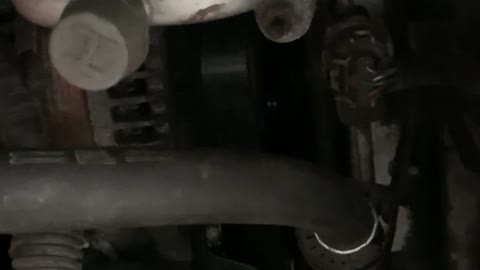

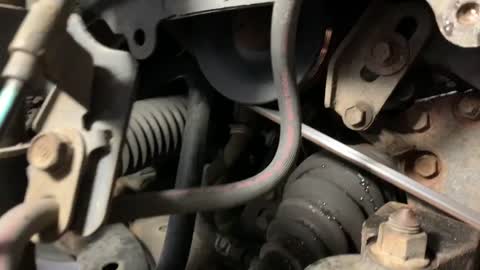

Every time I start the car, I could a hear really loud belt squeal. I replaced the belt with a belt from advance auto parts store and it was still doing it. So I bought OEM belt from Toyota and installed it and is still doing the same thing. This never happened with my original belt. When the car is running, it doesn’t make that noise. I don’t see any pulley misalignment. I’m not getting any battery light or check engine lights.

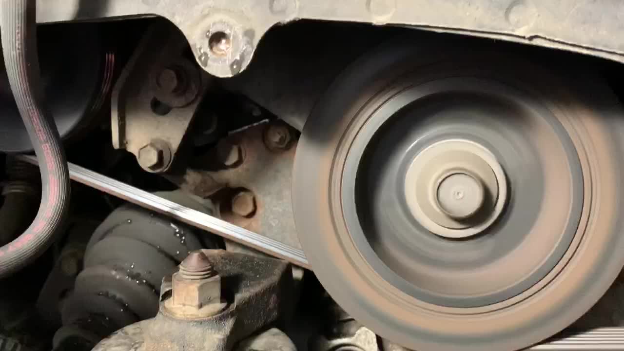

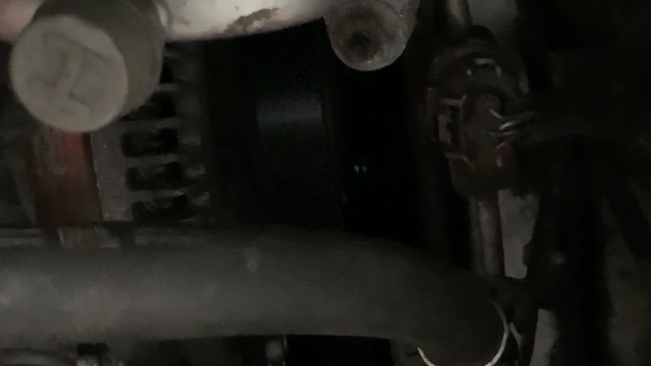

Hello, I recorded a video for you. If you listen closely you could hear a rubbing noise. I checked all the pulleys and they are solid and not moving.
