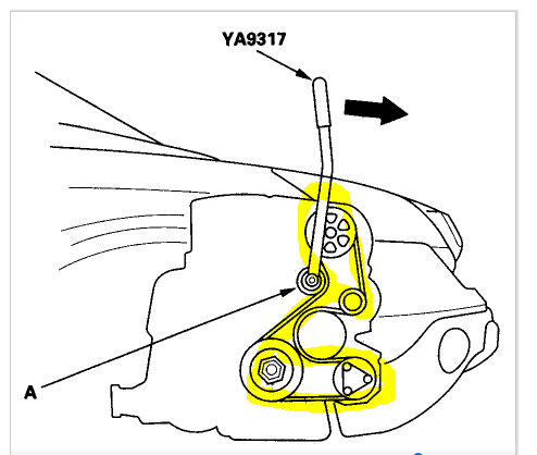

Do me a favor. Take a look at pic 1 below. I need you to open the hood and inspect the serpentine belt. Make sure it is in good condition and tight. (Engine off).
Next, if that appears good, I need you to check the alternator. You will need a multimeter or voltmeter to do this.
Here is a link that explains how it's done:
Let me know what you find.,
