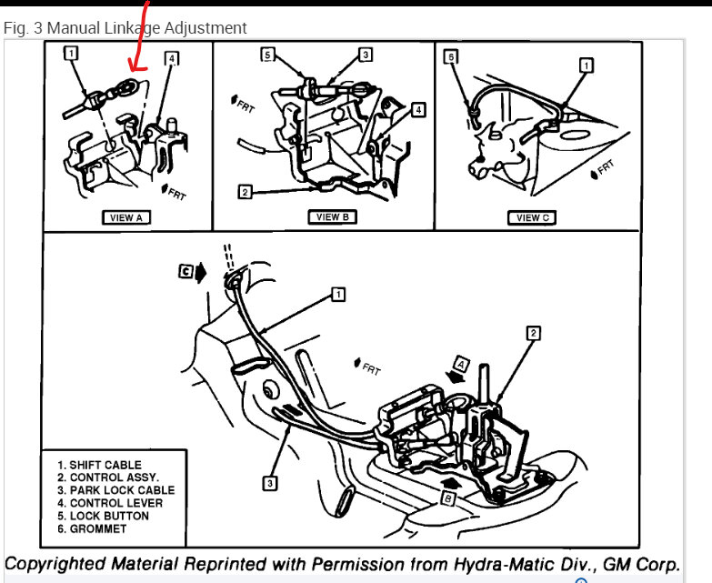

This vehicle is my 95 yr. Old father-in-law that is being donated to the American Cancer Society. He lost the keys and I need to move it out of the garage for pickup. The car has not been driven for 7 years. Battery drained. I cannot find info on what to do.

Can I ask if the front wheels are straight? If so, you can use a floor jack and raise the rear of the car and roll it backwards out of the garage. please check out this video to help show you how:

Let us know what happens and please upload pictures or videos of the problem so we can see what's going on.

Yes, tires are straight. I need to get it in neutral. I can chock the wheels and have someone inside with a foot on the brake and the parking brake engaged. I need to find the gear linkage to disconnect so I can move it out of park. It's so old. I have no idea whether I have to jack it up or go under the hood. Any info would be appreciated!

Here is how to disconnect the cable from inside the car. Check out the images (below). Please let us know what happens.
