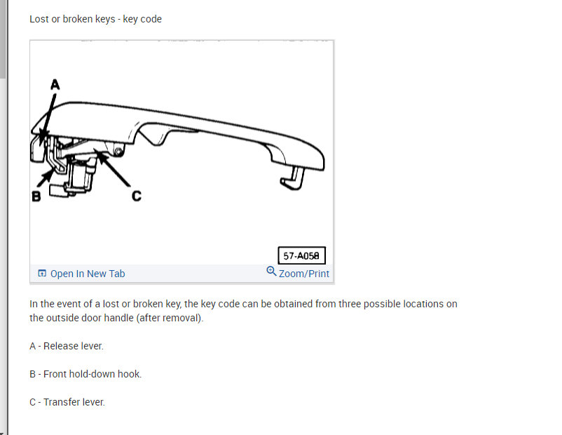

The car keys are lost so now I'm looking for a cheap key programmer and key.

We may have an issue with the year of the vehicle you selected. They did not have programmed keys in 1982 that I am aware of. Please let us know what the correct year is, and we can help figure out the solution and what is needed in order to get a key programmed.
Once we know what is required then we will know what steps to take.
However, if this is a 1982 then it appears all you need is the key code in order to figure out what the ignition is set too. I attached the info below on where to find this code so that you can have a key cut.
The easiest thing to do is contact a lock smith and they have a tool that can decode your ignition cylinder and then they can just make a key that will fit it.
Let us know if you need different info.
