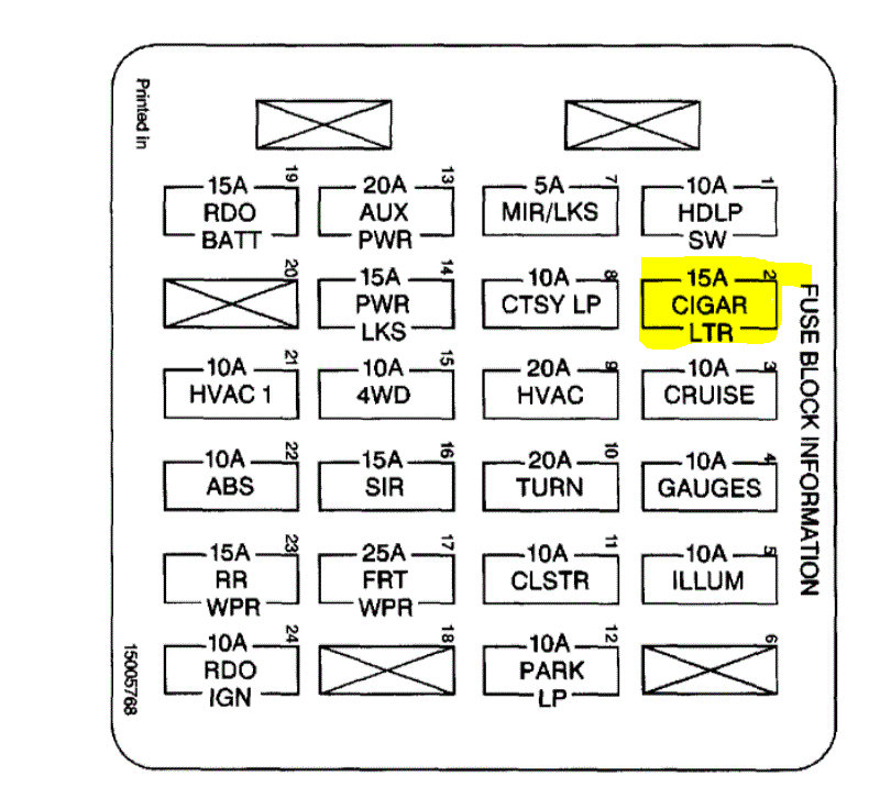

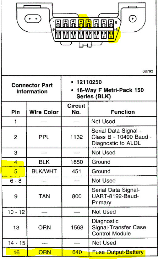

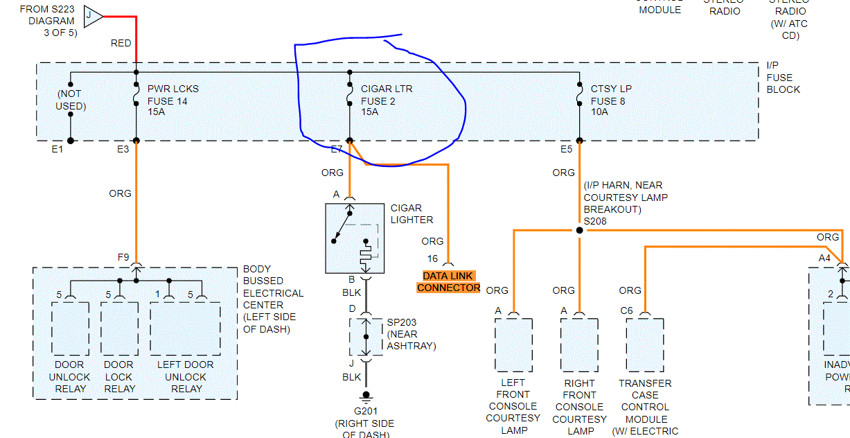

I did notice that while going up hills and crowding the gas pedal it sounds like there is no cover on the throttle body.
Dec 5, 2020 at 6:23 AM
  • 110,240 POSTS
Yes, there could be a blown fuse. Take a test light and see if there is power to pin 16 in the data link connector (DLC). If there is, then I need you to confirm ground with a multimeter. You will set it to ohms and see if there is continuity to a known good ground location. See pic 1
If you look at pic 2, it shows that power to pin 16 on the DLC comes from the same power supply as the cigarette lighter. Pic 3 shows the fuse location. In addition to just checking the fuse, make sure there is power to and from it. Here is a link you may find helpful:
Let me know what you find.
Dec 5, 2020 at 12:09 PM
JOHNSONAPE
  • 22 POSTS

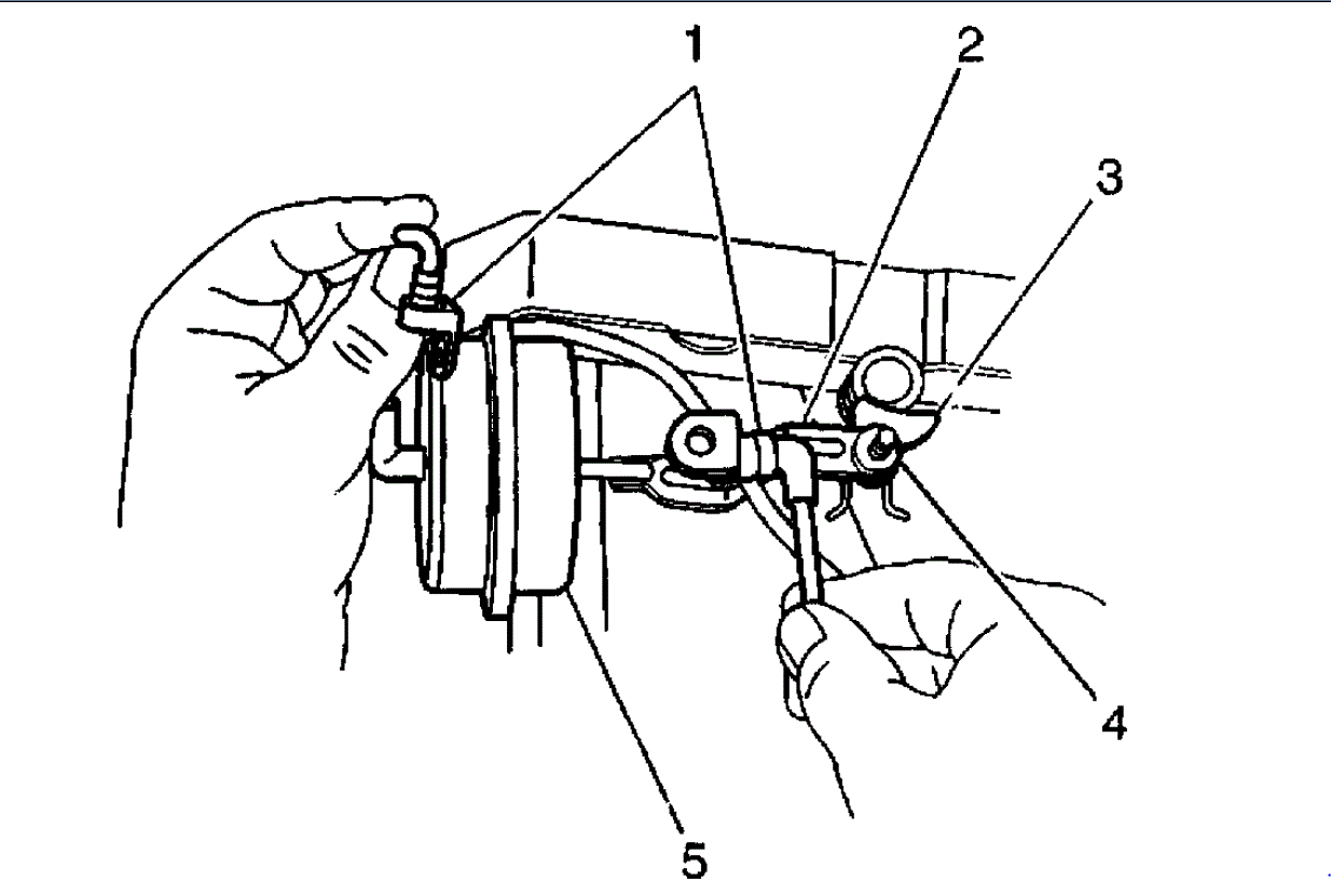

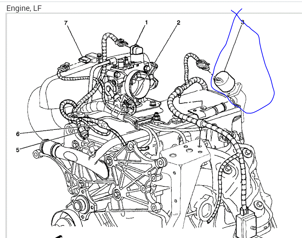

Oaky Joe, that was the problem (blown fuse) codes came up. 141,200,404 and 405. first place I was going to look was the EGR valve but I cannot locate it. I did find a 5 pin connector dangling at the back of the motor but upon inspection with a mirror and light I cannot see that the EGR valve was removed and covered with a plate. I cleared the codes, took it for a spin and after the engine light came back on I ran another scan and only got the 405.Question is, if the EGR valve has been removed since I bought the truck I'm wondering why the loss of power on inclines suddenly. It has always run strong for a 4 cylinder. This seems to have happened after I changed the oil and filter (which should have nothing to do with it). Any help appreciated.
Dec 6, 2020 at 2:36 AM

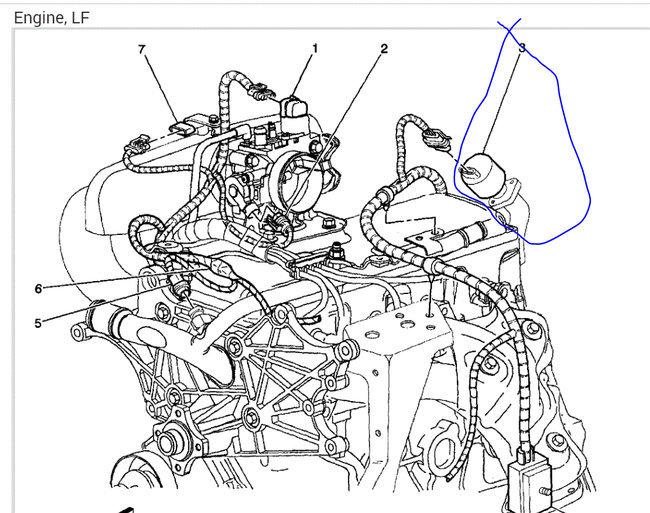

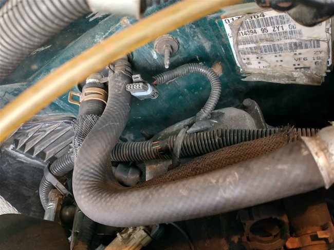

The codes you listed, are they P codes? For example, P0141.
As far as the EGR, it's on the rear of the engine. See the attached picture.
Dec 6, 2020 at 2:00 PM
JOHNSONAPE
  • 22 POSTS
Yes Joe, they are p codes. As I stated before after I cleared the codes and drove it I rescanned and only got the the p405. Here is a picture of my engine. The EGR seems to have been removed.
Dec 6, 2020 at 6:25 PM

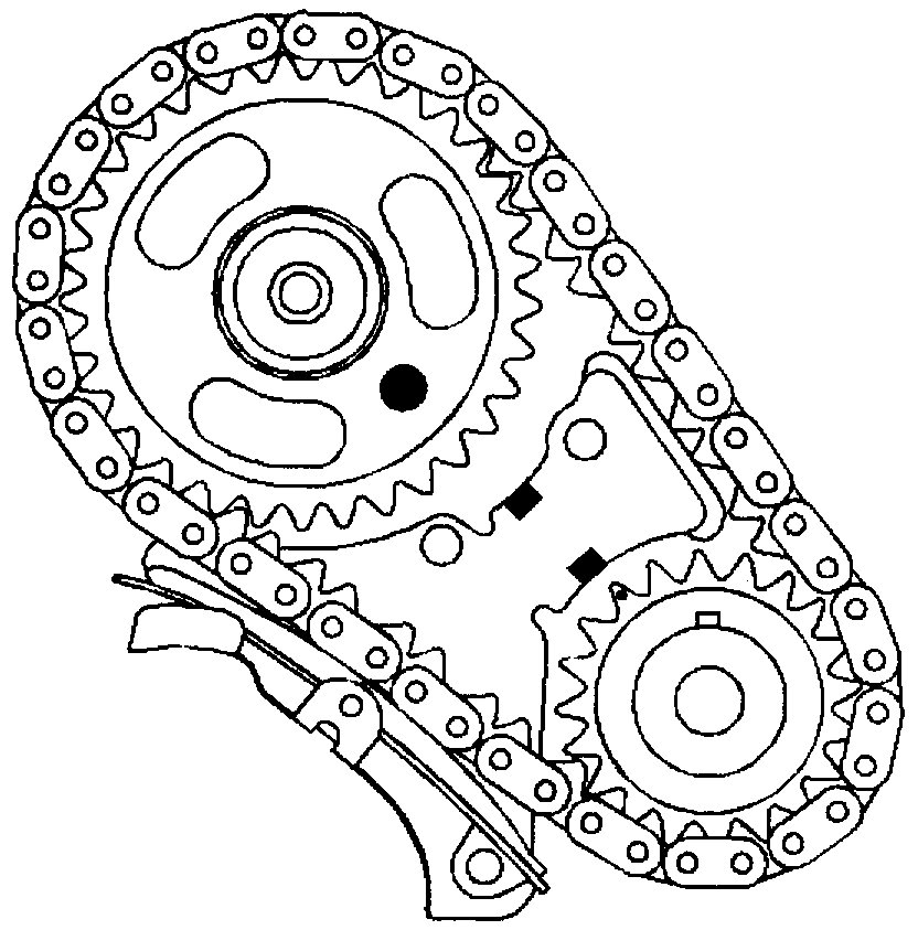

Hi Joe, I think I found the problem. My timing chain snapped this morning on my way to work. I'm sure it must have jumped out of time to cause the loss of power. Thanks for your help.
Dec 7, 2020 at 5:47 AM
  • 110,240 POSTS
Yep, that makes perfect sense. Thanks for letting me know. I don't know if you need them, but here are the directions for replacing the chain and sprockets. The attached pics correlate with the directions. I honestly would replace the sprockets and tensioner while it's apart.

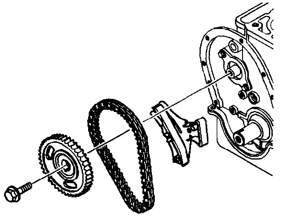

3. Remove the camshaft timing chain tensioner bolts.
pic 3

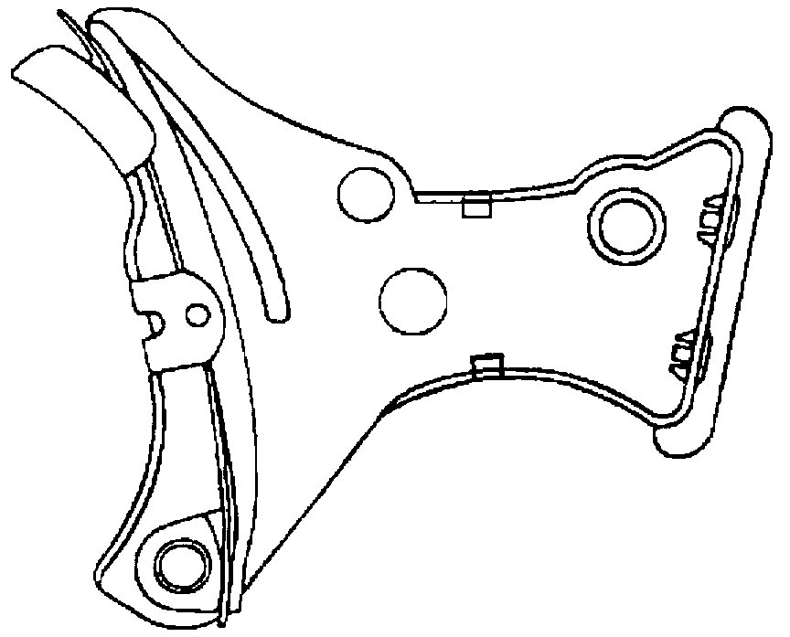

4. Remove the camshaft timing chain, tensioner and camshaft sprocket at the same time.
pic 4

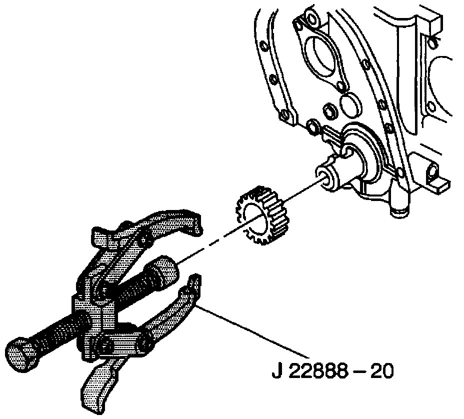

5. Use the J 22888 - 20 in order to remove the crankshaft sprocket.
6. Remove the crankshaft sprocket key, if necessary.

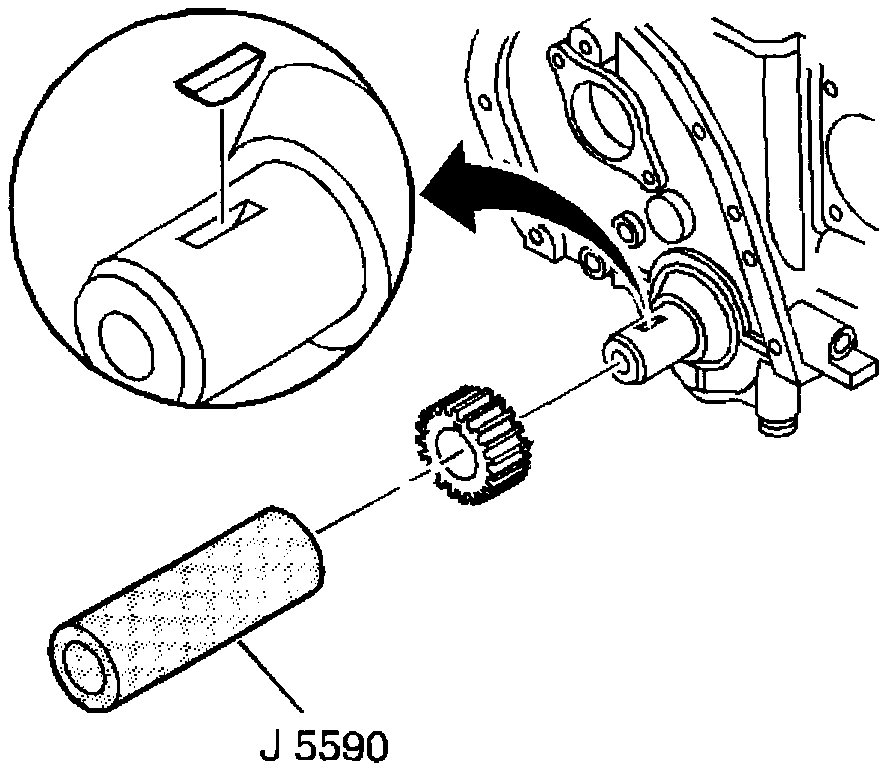

INSTALLATION PROCEDURE
^ Tools Required
- J 5590 Crankshaft Gear Installer
IMPORTANT: If any of the camshaft drive components are being replaced to correct a noise condition, replace all of the components in the camshaft drive system.

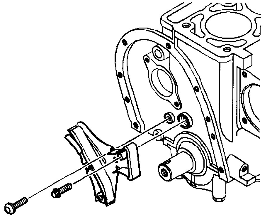

pic 5
1. Install the crankshaft sprocket key, if removed.
2. Install the crankshaft sprocket with the timing mark facing away from the engine, using J 5590 and a hammer.
Make sure that the crankshaft sprocket is seated against the crankshaft.

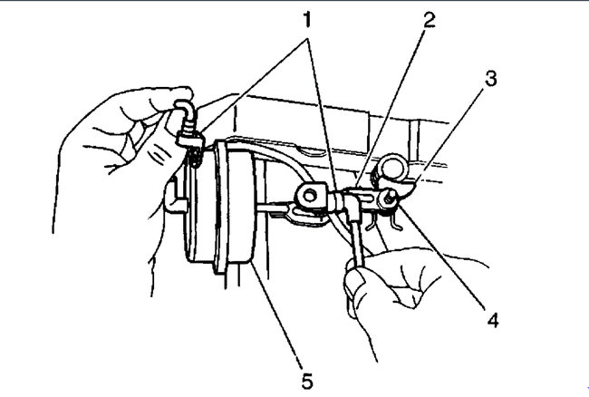

pic 6

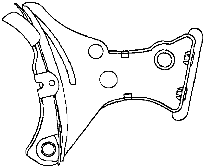

3. Compress the timing chain tensioner spring.
4. Insert a cotter pin or a nail into the hole in the tensioner in order to retain the timing chain tensioner shoe.
pic 7
IMPORTANT: Do not tighten the timing chain tensioner bolts.
5. Install the timing chain tensioner.

6. Align the crankshaft sprocket timing mark, the stamped circle, with the tab on the timing chain tensioner.
7. Align the camshaft sprocket timing mark, the 8 mm hole, with the tab on the timing chain tensioner.
