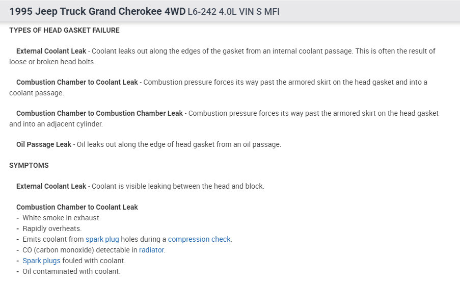

While driving down the highway all of a sudden it overheated, and Coolant went everywhere?
275,000 MILES • 4.0L • 6 CYL • 4WD • AUTOMATIC
ROBERTSON1991
The engine ended up losing compression. Just had my engine replaced after picking it up from the mechanic about an hour from home and it overheated, but I could restart. Reservoir is still full, no busted hose, and the drain plug is still there. Have no idea what happened.

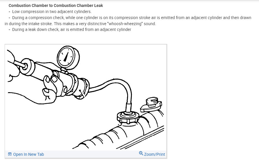

I'm confused. With the new engine, coolant went everywhere, but the reservoir is still full, is that correct? Have you checked the radiator to see if it is full as well?
Also, have you been able to locate where the coolant came from? If you haven't, fill the coolant and pressure test the system. Here is a link that explains how it's done:
https://www.2carpros.com/articles/radiator-pressure-test
You will need a pressure tester, but most parts stores will lend one to you.
Let me know what you find or if you have questions,

Refill the radiator and then pressure test the cooling system. You will need a pressure tester, but most parts stores will lend one to you.

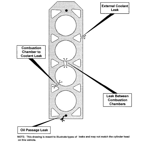

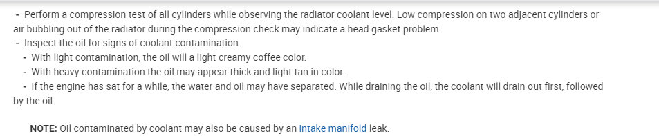

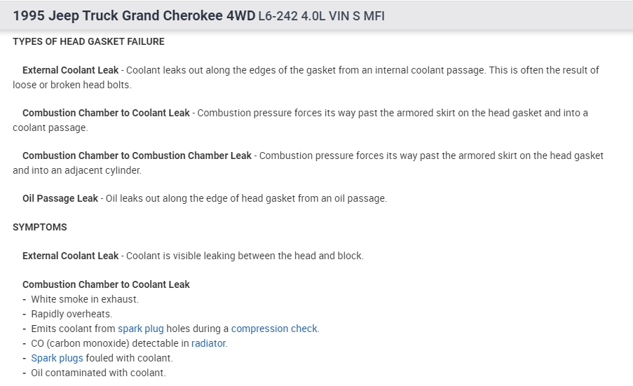

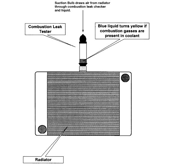

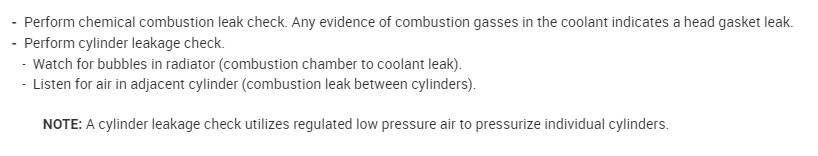

I have a feeling it could be a head gasket, so make sure the coolant isn't mixing with the engine oil also.
There were two years, and for the life of me I can't remember when, but the 4.0L were having issues with the cylinder head cracking between cylinders 3 and 4. I think it was 1999 and 2000, but I can be certain and I don't know what year the new engine came from.

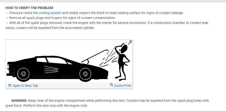

I attached the directions below right from the manual for testing for a head gasket leak. Take a look through them and let me know your thoughts. Also, pic 1 simply shows where a gasket can leak. It's for reference only.
