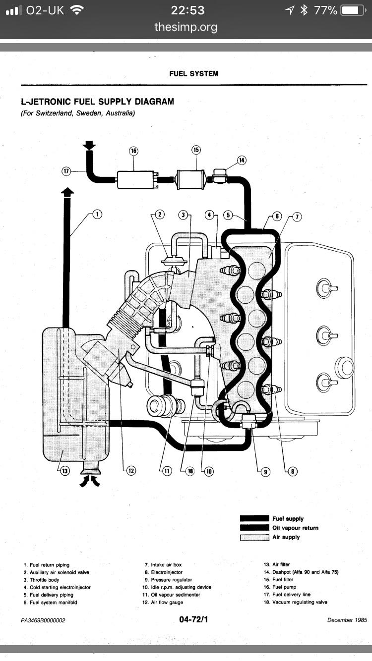

Check fuel return line. Is fuel flow here increasing? Is fuel dumping back into the tank? If a closed loop system, not a return line system. The problem will have to be at the pump still. I am trying to locate a schematic for this fuel system. It is a bit hard diagnosing with out knowing exactly how the system works.

JACKOCOOPER
See attached image. I hope you can read that.
I understand. The pressure regulator may be sending too much fuel back to the tank? Why would this only happen occasionally? When the car has been running a few minutes?
Tuesday, December 5th, 2017 AT 3:02 PM
MHPAUTOS
  • 31,937 POSTS
There may be silt or fine rust in the fuel rail and it is getting stuck under the pressure regulator metering valve.
