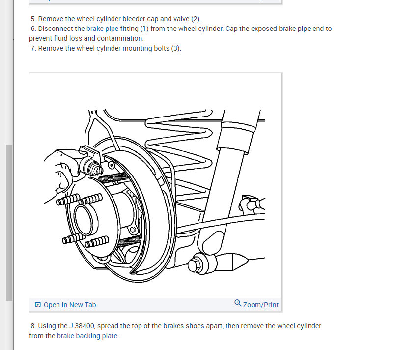

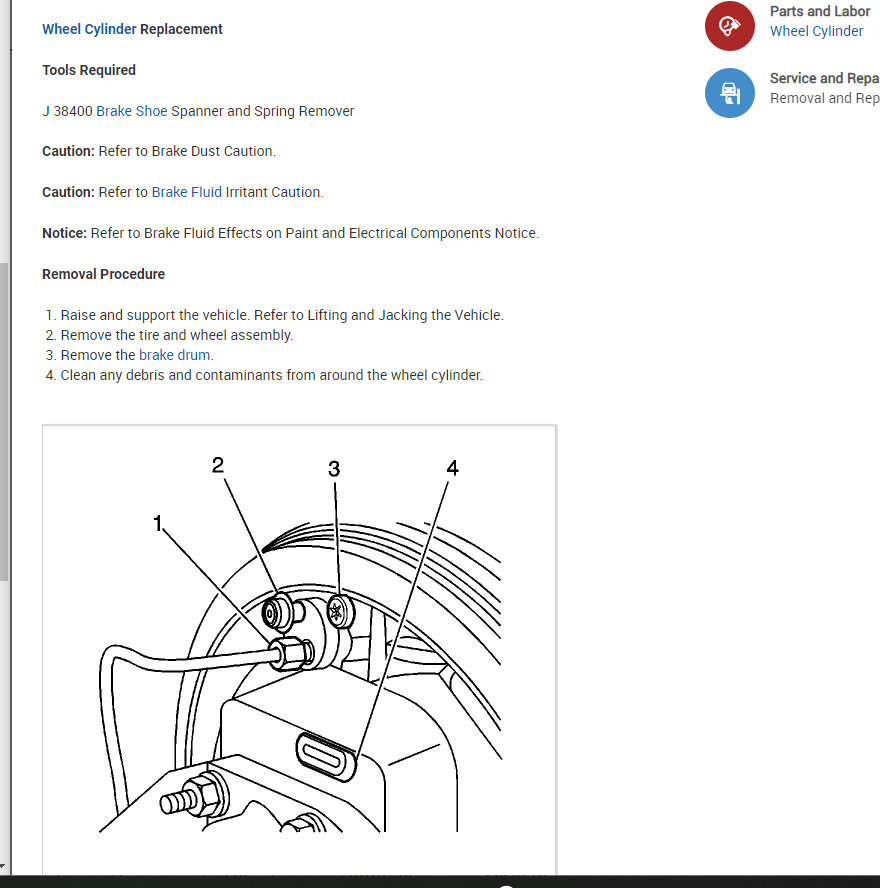

If you are adding an ounce of brake fluid, then that is the first issue that needs to be addressed. Clearly this is not a good thing because if that leak gets worse it could cause you to have no brakes one day while you are driving.

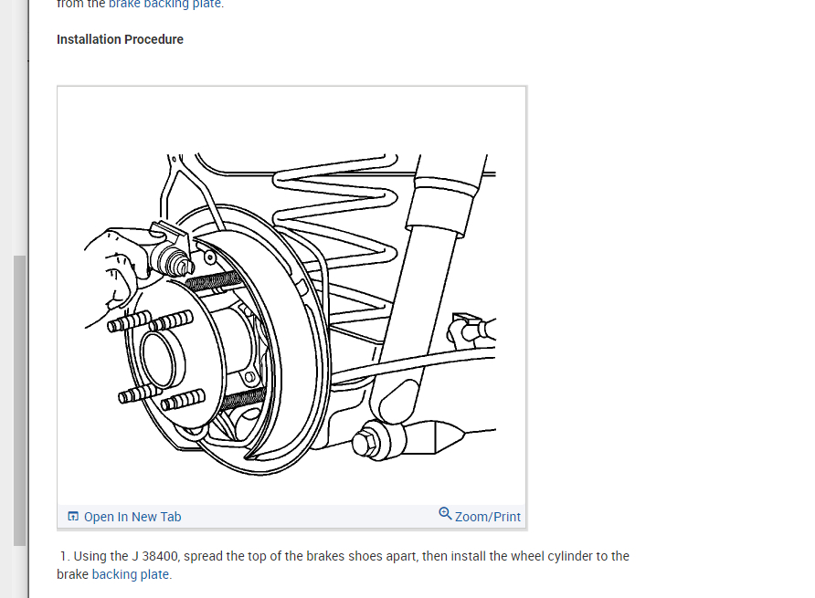

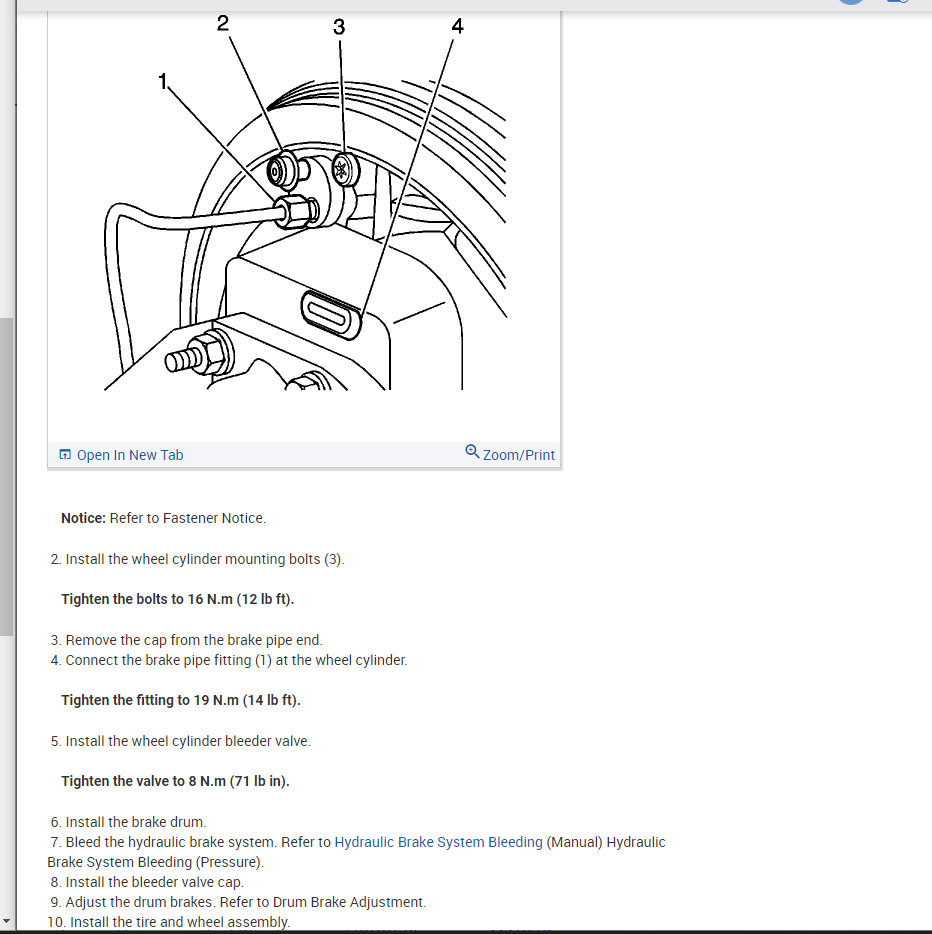

More than likely you have a wheel cylinder in the rear that is leaking so you may have to remove the drum to find the leak.
So, I attached the info below that will help with this.
As for the squeaking, if it is during a turn then it is most likely part of the steering system or the axles/hubs.
Here are a couple guides that will help with that, but I would start with the brake fluid issue and go from there.
https://www.2carpros.com/articles/bearing-hub-replacement
https://www.2carpros.com/articles/how-a-cv-joint-works
Below is this info that you will need. Thanks
