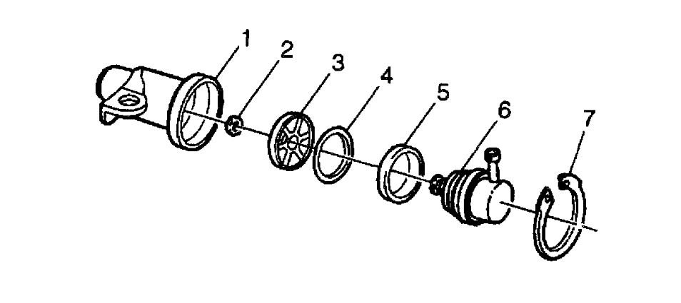

Procedure below:
1. Relieve the fuel pressure. Refer to Fuel Pressure Relief Procedure. See: Fuel Pressure Release > Procedures
2. Clean any dirt from the fuel pressure regulator retaining ring.
3. Remove the vacuum hose from fuel pressure regulator.
ImageOpen In New TabZoom/Print
4. Remove the snap ring (7) from the fuel pressure regulator.
5. Using a shop towel to catch any spilled fuel, lift and twist the fuel pressure regulator in order to remove the fuel pressure regulator (6) from the fuel pressure regulator housing (1).
6. Remove the regulator O-ring small (2).
7. Remove the regulator filter screen (3).
8. Remove the regulator O-ring large (4).
9. Remove the regulator O-ring back up (5).
10. Cover the fuel pressure regulator housing (1) to prevent contamination from entering the fuel system.
Wednesday, June 19th, 2019 AT 2:41 AM

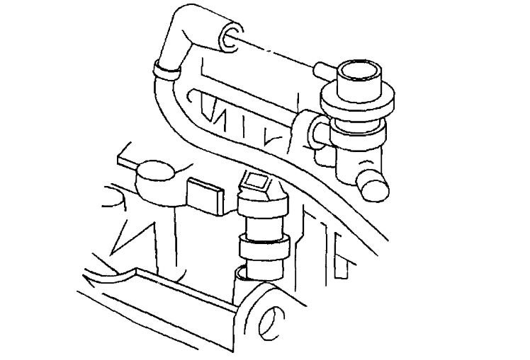

I was told I have to remove parts out of my car. The intake manifold gasket and such. That's what I'm the most confused about.
Wednesday, June 19th, 2019 AT 4:07 AM
  • 52,797 POSTS
That is inaccurate information.
The regulator is on the fuel rail in the back by the last cylinder at the firewall.
Wednesday, June 19th, 2019 AT 4:32 AM

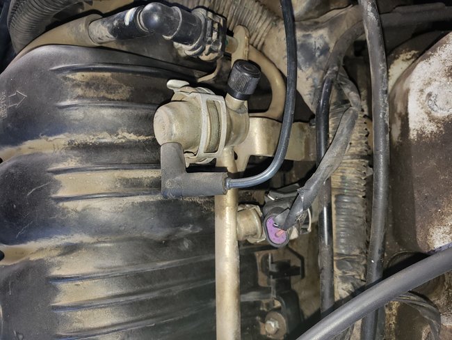

ASHLEE MARIE
  • 13 POSTS
This. Correct?
Wednesday, June 19th, 2019 AT 7:25 AM
  • 52,797 POSTS
Yep. That is it.
