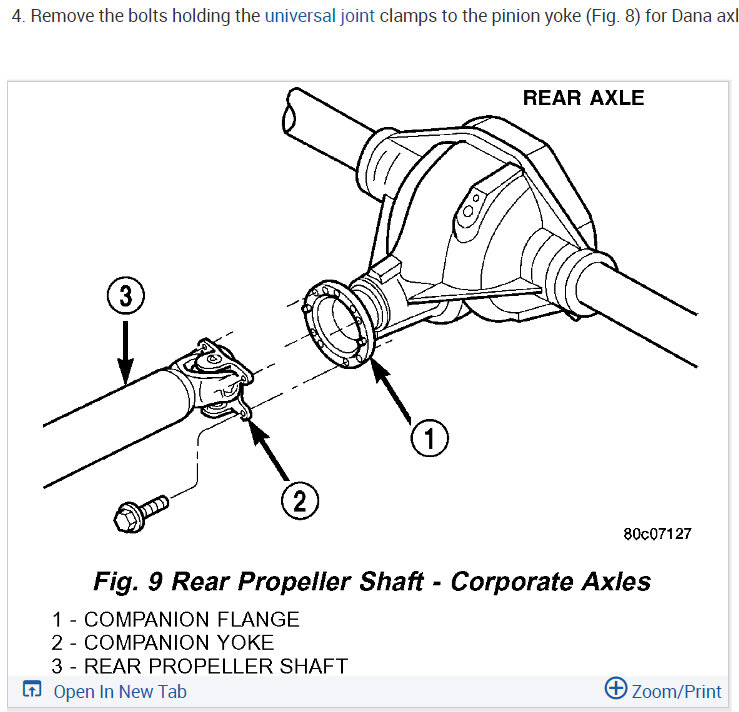

When accelerating it pops under driver seat and in the middle of the van. Usually between 15-30mph. It doesn't happen frequently until I drive and park restart a couple of times. It will basically drive fine for 30 mins at various speeds. It doesn't over heat but the coolant is a light brown. I have replaced fuel pump 2 years ago. Radiator 1 year ago. Recently replaced the EVAP emission lines and countless other things with the vacuum lines. Mechanic says it sounds like a blown head gasket but compression test checked ok. I usually replace the cap and rotor then all is fine but every 6 months or so they are corroded.

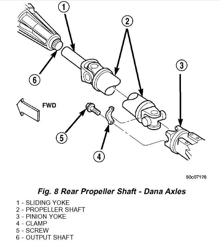

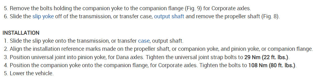

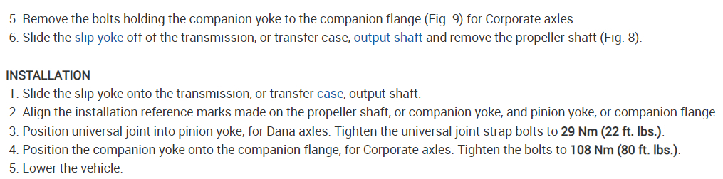

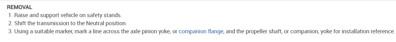

The fact that is pops under the driver's seat is telling me U joints. I would remove the driveshaft by following this guide to check the U joints.
https://www.2carpros.com/articles/how-to-remove-a-drive-shaft
and
https://www.2carpros.com/articles/how-u-joints-work
Please check the images below to show you how on your car. Check out the images (below). Let us know how it goes
