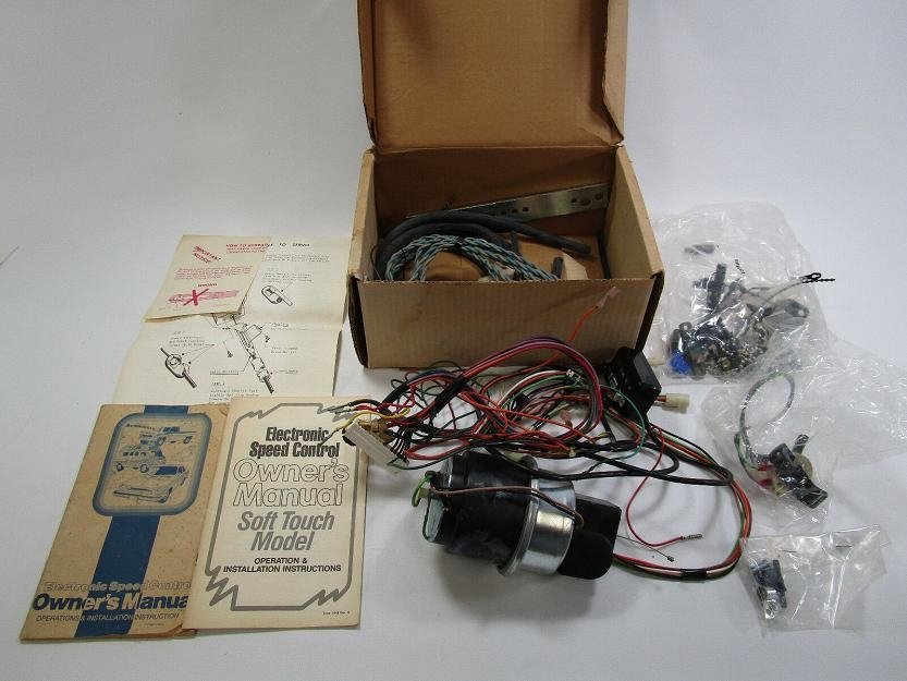

The first photo shows the Sears / Dana system. The servo is the round black part in the center / bottom. This one is vacuum-operated, the same as most original equipment models.

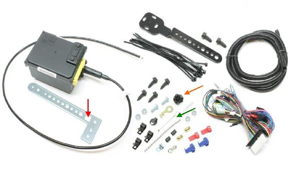

The second photo showsa a Rostra system that appears to be real popular. The hardware kit is similar to what we had in the '80s. The red arrow is pointing to the throttle cable bracket that has to be fashioned to mount to the engine. The Sears unit had multiple other ways to anchor the cable's casing, but it had the same bracket and the same plastic grommet, (orange arow).

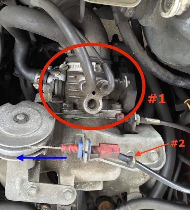

The third photo is what I found listed for the carburetor for your year and model. I also found references to injectors, so I don't know if you really do have a carburetor or a throttle body, but regardless, the blue arrow is pointing to the extra cable guide they used with the optional factory-installed cruise control. It is very unusual to see this cable guide laying horizontal on other car brands because when one cable pulls the throttle open, the other one is relaxed and could fall off. You'll notice these guides appear to be uncommonly deep, I assume to prevent that problem.
It's hard to see, but the orange arrow is pointing to the cable extension used with this type of cable guide. It looks rather short, so you'll have to see if that will work.
For pulling directly on the accelerator pedal, the Sears unit had a black plastic quarter-round snap-together bracket that could be bolted to the floor, then the bead chain is used as the cable extension and pulls on the pedal. We never used that because it was way too complicated and difficult to make it work right. If you're going to do it that way, you'll be smarter than me in that regard, and you'll have to be the expert who makes it work. I don't see that quarter-round bracket in the Sears photo, but there are definitely some parts missing. I don't see anything for this purpose in the Rostra photo either.
The Rostra unit doesn't use engine vacuum. That makes it nice for use with diesel engines that don't always have much vacuum. What concerns me though is how they pull the throttle cable. That can be done with a fast-acting electric motor, but it can also be done with an internal motor-driven vacuum pump. That is what they used on the Sears model I mentioned that lasted less than a year. (I mean it lasted as an inventoried item for less than a year). Those had a 100 percent failure rate of the pump assembly. Toward the end, we were sending our customers to Napa to buy the same Dana model cruise control package, with their name on the box), then we'd install it for them. No Sears employee tried to sell the miserable model to anyone. Also, if your unit is listed as it can mounted inside the car, it won't have a motor-driven vacuum pump. There's no way you would put up the horrendous noise those make.

- The third photo is what I found listed for the carburetor for your year and model. I also found references to injectors, so I don't know if you really do have a carburetor or a throttle body.....
In the USA, every Volvo 240 came with multipoint fuel injection; Mechanical 1976-1982, Electronic 1982-1993.
-...but regardless, the blue arrow is pointing to the extra cable guide they used with the optional factory-installed cruise control.
I have an automatic Volvo 240 parts car; that cable guide is for the transmission kick down cable.
