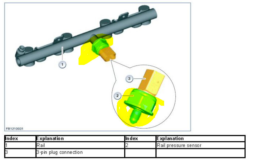

If the plugs are black, you are getting too much fuel. Did this happen right after the oil change? Is the air filter clean and not plugged?
If it did happen after the work was done, check the fuel rail pressure sensor. It is mounted on the fuel rail. Make sure the connector wasn't loosened or damaged. If disconnected, it will cause the fuel pressure to be off. However, the vehicle will still run. If the rail pressure sensor fails, the quantity control valve is activated in emergency operation so the engine will continue to run.
See pic below.

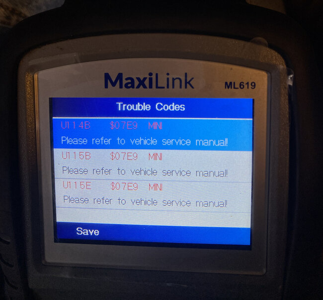

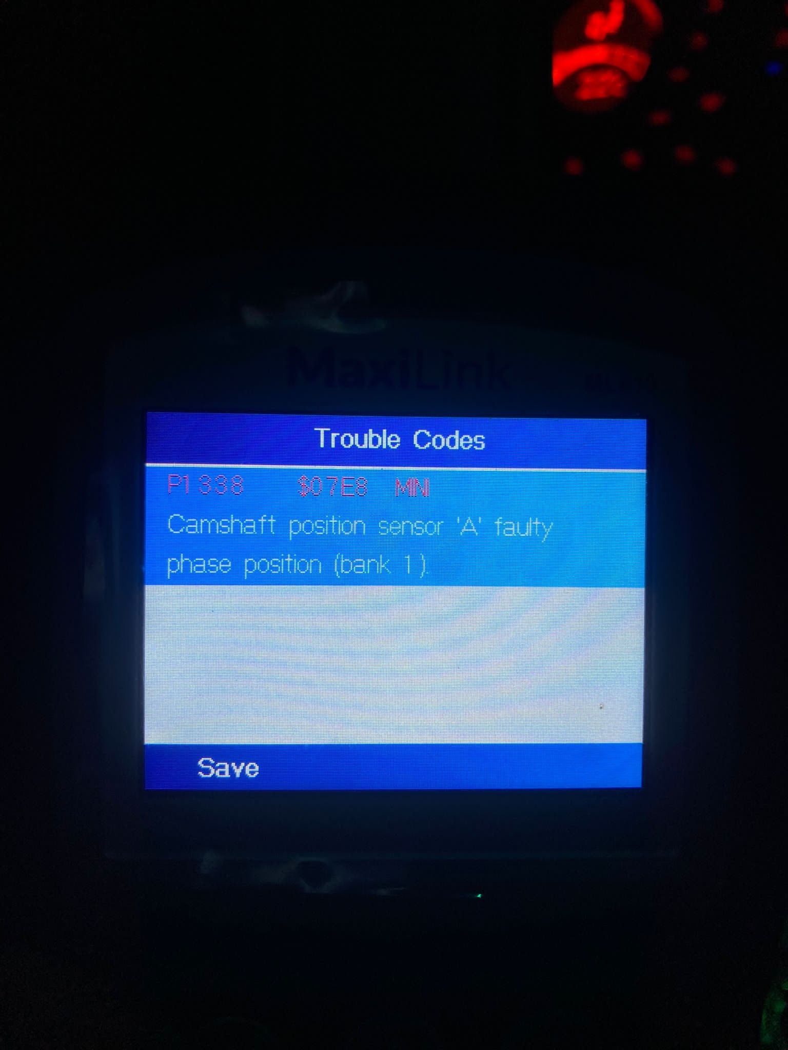

l am providing a we-transfer link as the process video is too big to attach here (this time there was only 1 code for cam shaft sensor, but sometimes the timing chain replacement codes appear)
Please notice how the long crank disappears after process- VIDEO 2
and somehow the Ventilation fans have stopped working, no AC no heat, do you think this could be linked?

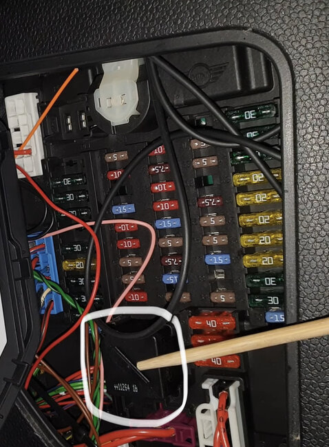

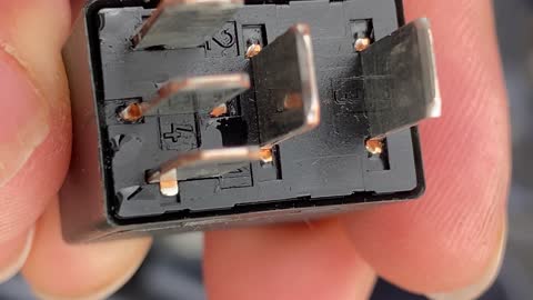

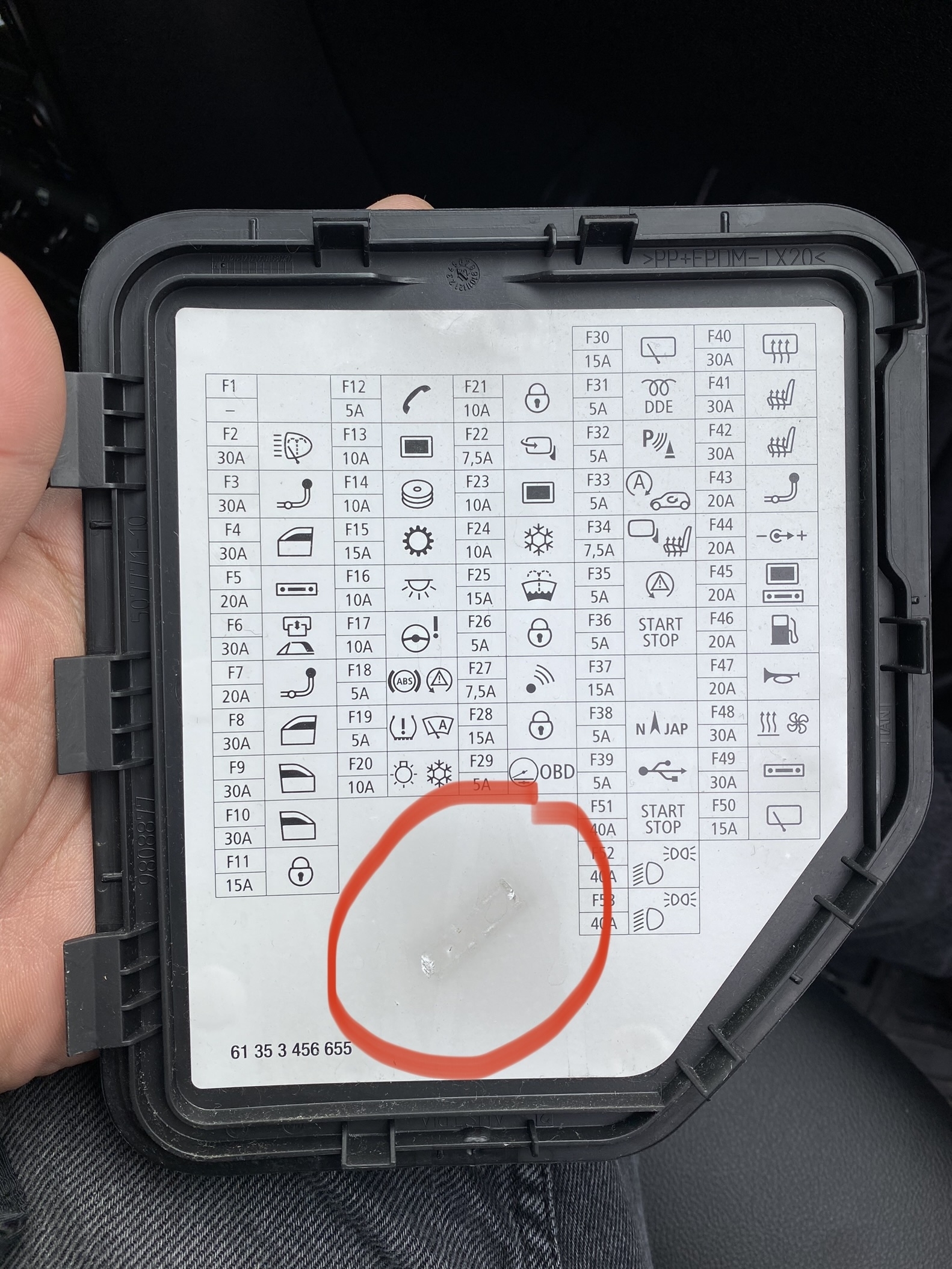

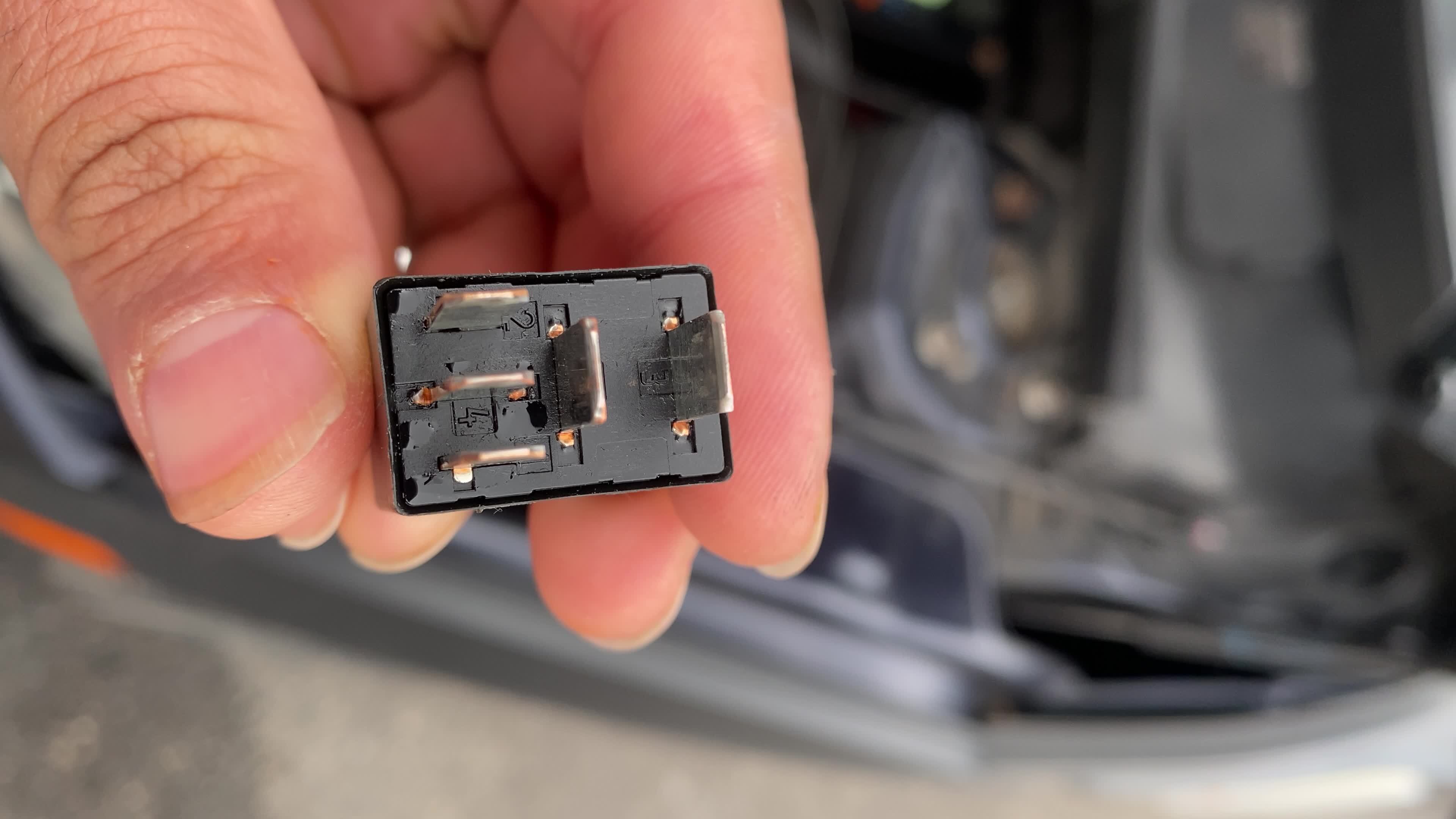

I have also found out that there is a sign of 1 relay (might be fuel pump relay) getting hot, I assume this because of the mark it left on inside of the cover, this relay's location is in inside (cabin) fuse box of mini - PHOTO 1, PHOTO 2

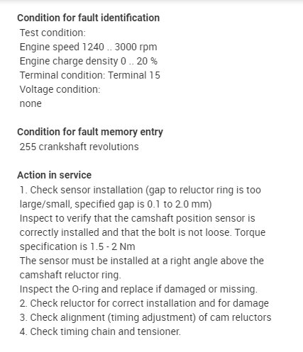

Photo 3 - Codes
Photo 4 - Codes

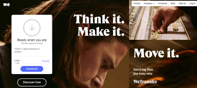

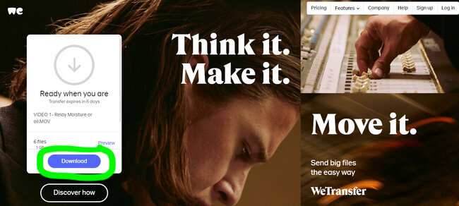

I tried going to the link you provided and could only get so far. See pic below. That is what I got when I agreed to their terms. How do I get to your information?
Let me know, and yes, there could be some form of electrical issue that is causing the new issues. I would really like to see the relay that appears overheated. That should only happen if there is too large of a draw or the relay is failing internally and creating more heat than normal.

You just need to click on download, and you'll be able to access the pics and videos. but be patient as the video size is big about 1 gb.

I got them this time. Sorry, I didn't realize I had to hit download. Ugh!!! I'm getting old. LOL

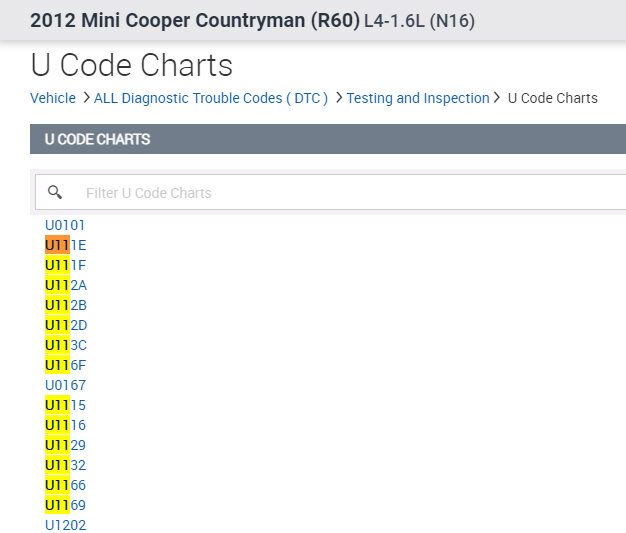

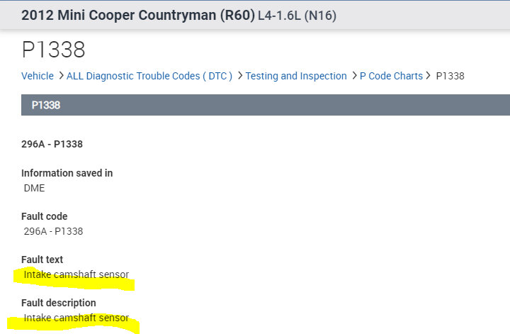

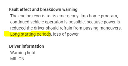

I have questions. First, was it the intake camshaft position sensor that was replaced? The code is specific to that one and not the exhaust. Take a look at the description of the code below.

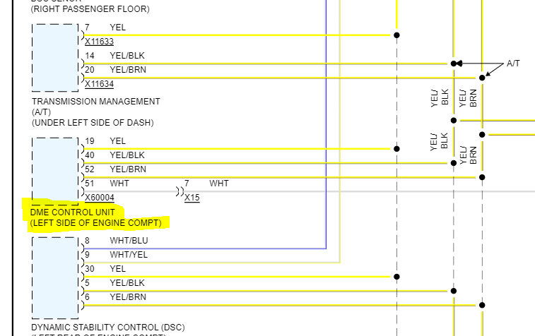

Now, I have a problem. If you look at pic 4 below, you'll notice that none of the U-codes are indicated for this year and model. I will tell you that U codes usually indicate an issue with the computer area network. In this case, I know the codes are related to the DME (digital motor electronics (also known as a powertrain control module).
The last pic below is from the controller area network schematic (CAN) This is where all the modules are tied together with a few wires. I need you to locate the DME and inspect the wiring and connector of the wires in the last pic.
Please understand this is a theory. But if we have a loss of communication with the DME, it can cause several different issues. However, since the codes aren't even listed for this vehicle (I'm not sure why), this is a guess. If the DME can't communicate, it could be causing a problem related to the cam sensor. Regardless, I would start with the cam sensor first to make sure it is seated properly, and the connectors are good. Also, make sure it was the intake sensor.
I hope this isn't too confusing. I've been trying to determine a possible cause, but the codes are throwing me off. That's what I'm indicating, it is a theory only.
