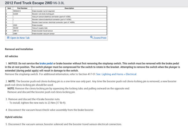

When i came to a stop or when taking off it seemed like my brakes were locking up. i looked at rotors and they were rusty so i changed them and the brake pads even though they were still like brand new, and my car still stops on its own when coming to a stop sign and when taking off. it doesn't pull to the left or right. so, I was wondering could both front calipers be going bad or is the brake booster going out? or do you have any other theories?

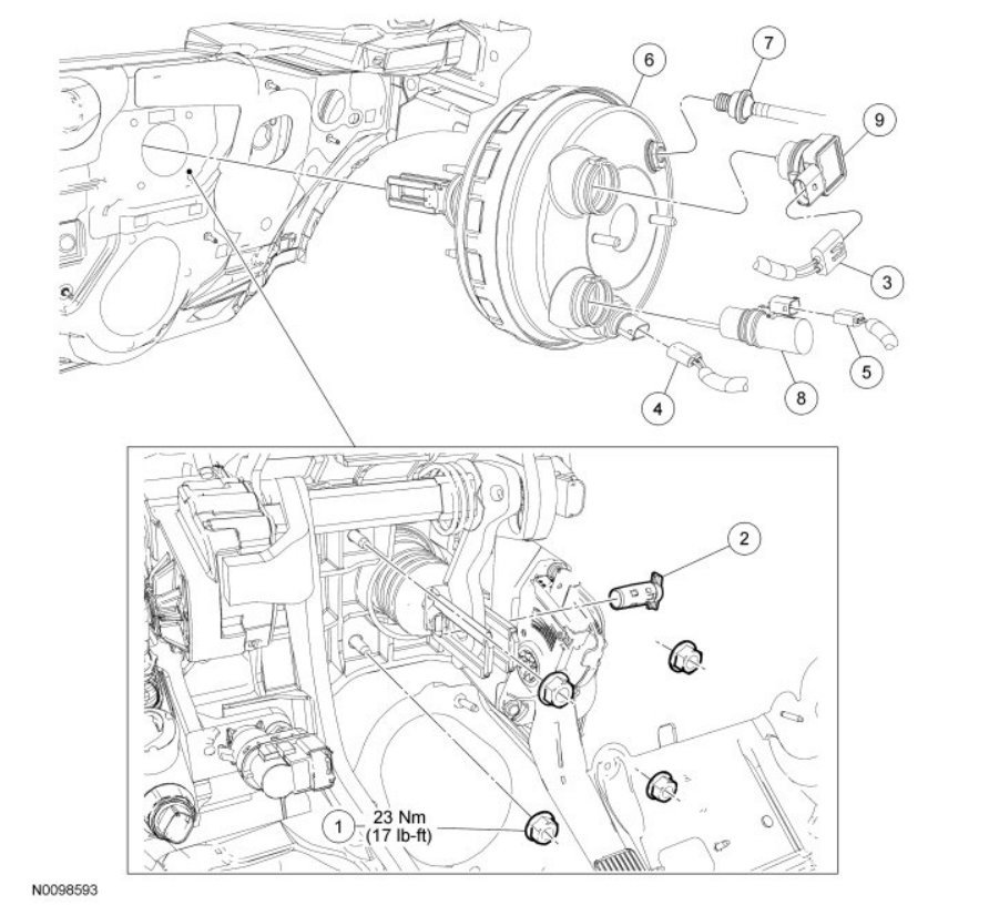

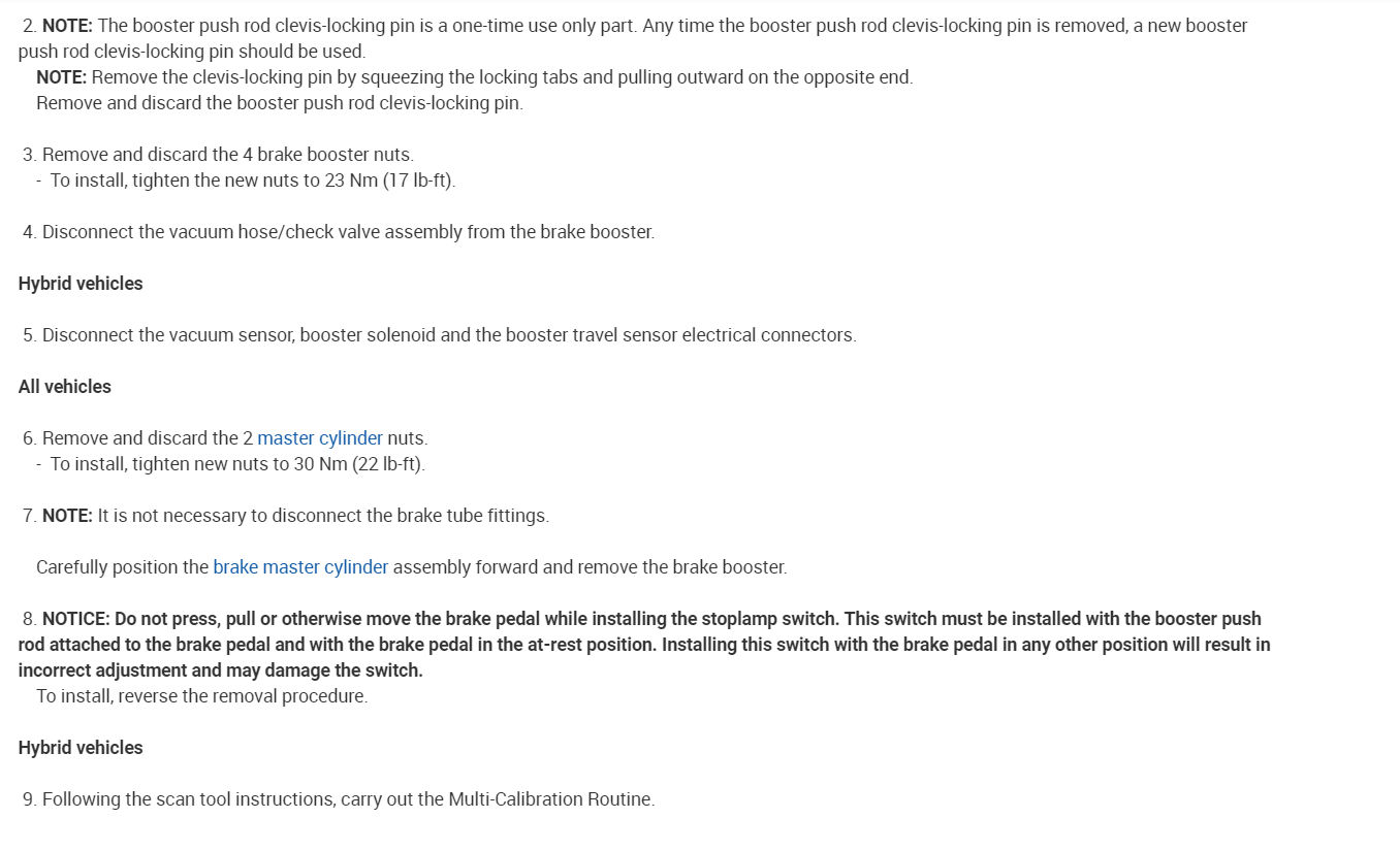

Okay, after changing the calipers and they wouldn't release. i loosened the nuts on the master cylinder and either a puff of air came out or suctioned and then the brakes released.
Aug 5, 2022 at 10:01 AM
  • 55,399 POSTS
okay, it sounds like the booster is bad, or on the outside chance the master is sticking and when you loosened the mounting nuts it released.
