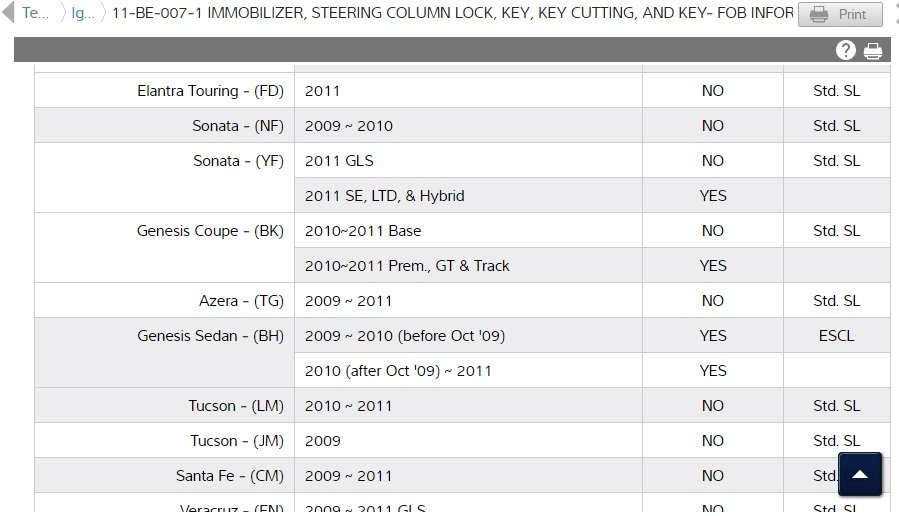

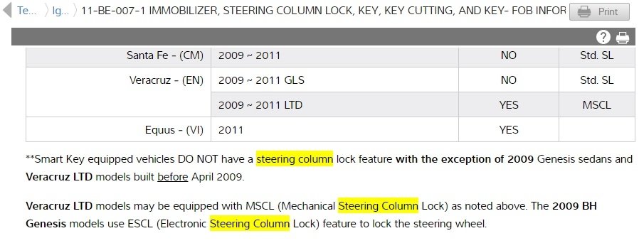

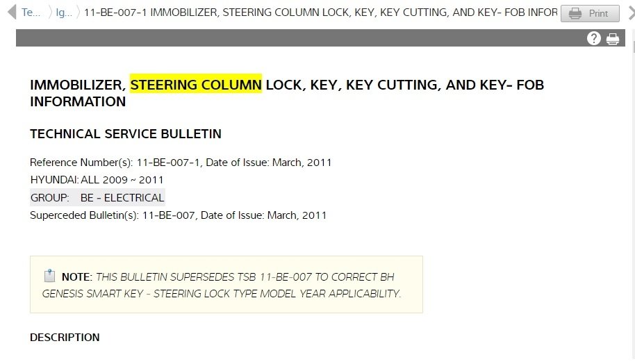

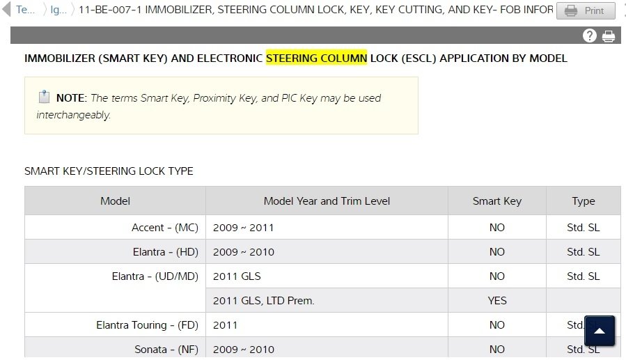

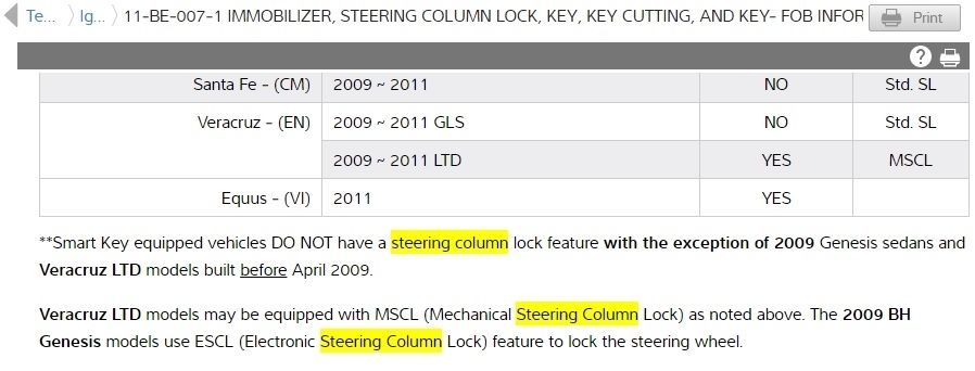

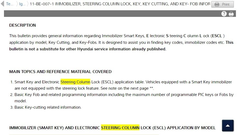

I found this in "Prodemand" under the "Recalls" section.
The dealer might be the next step in seeing if this repair might be covered by them.
See my screenshots below.
The Medic
