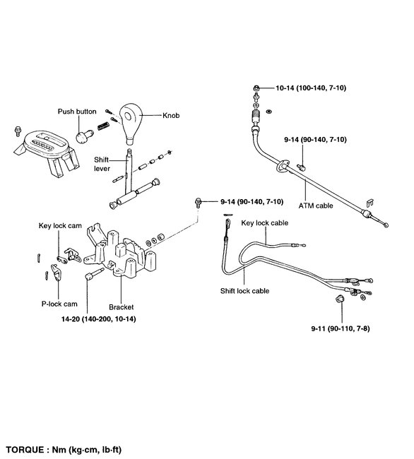

Are both lock cables same?
Sep 18, 2018 at 5:26 AM
  • 110,248 POSTS

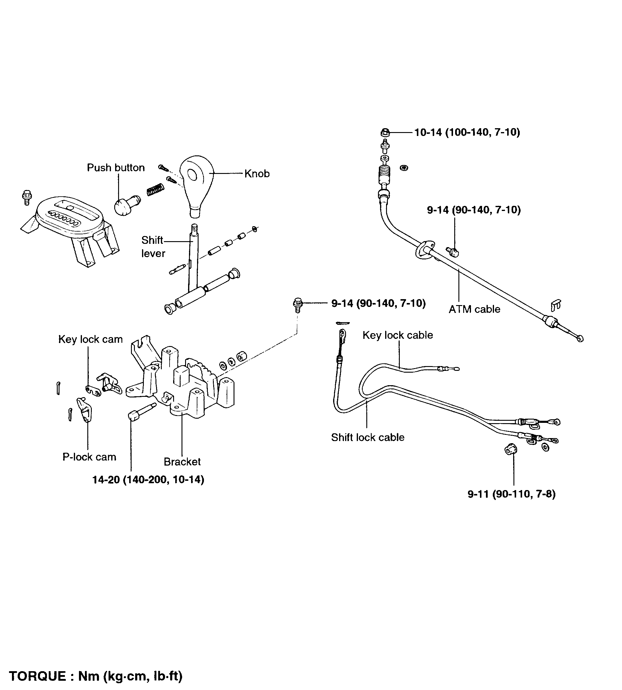

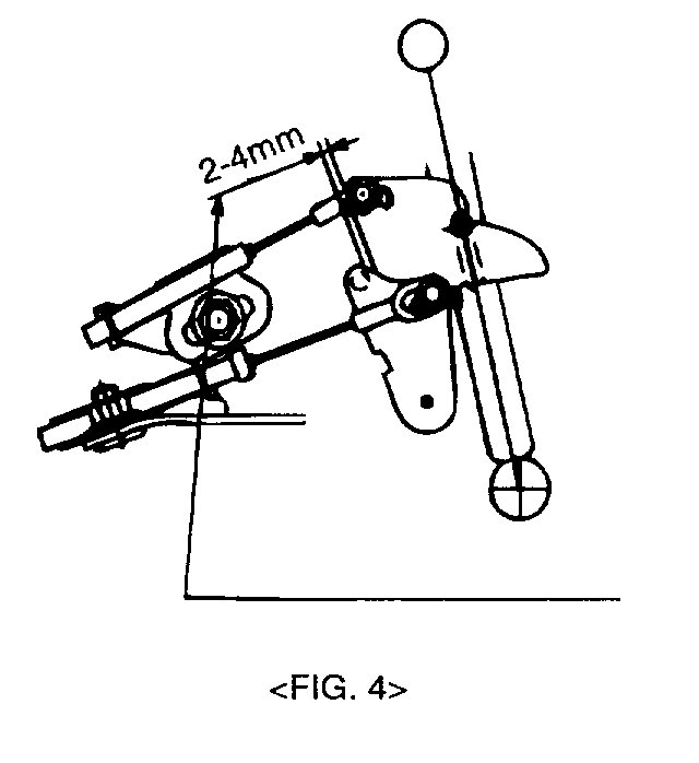

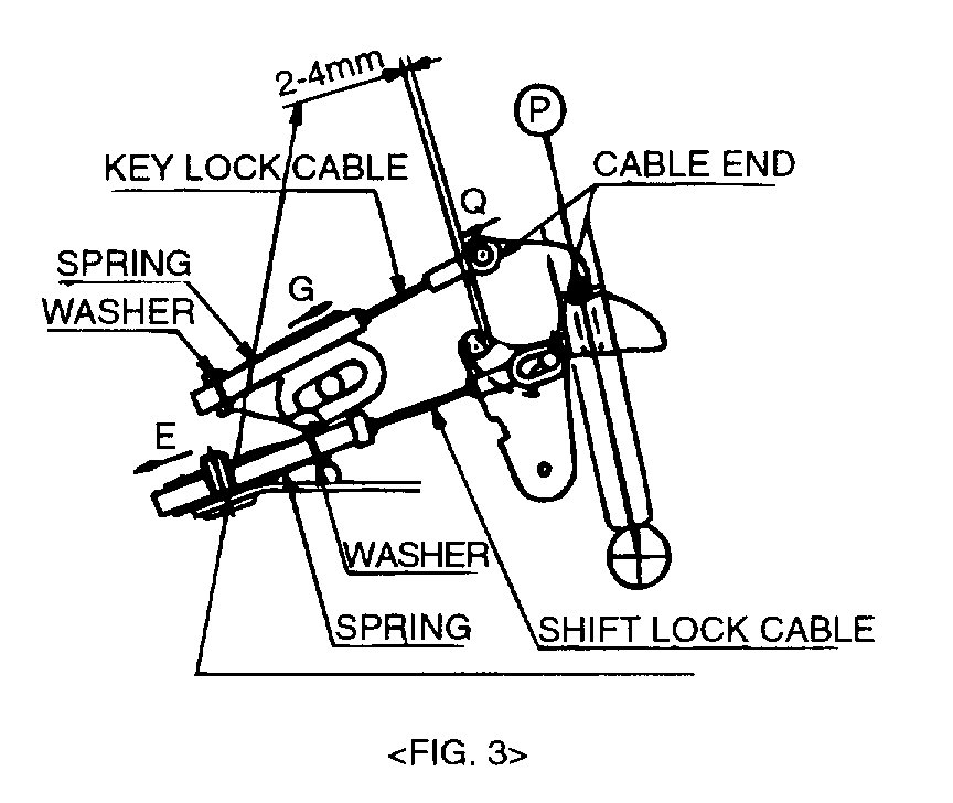

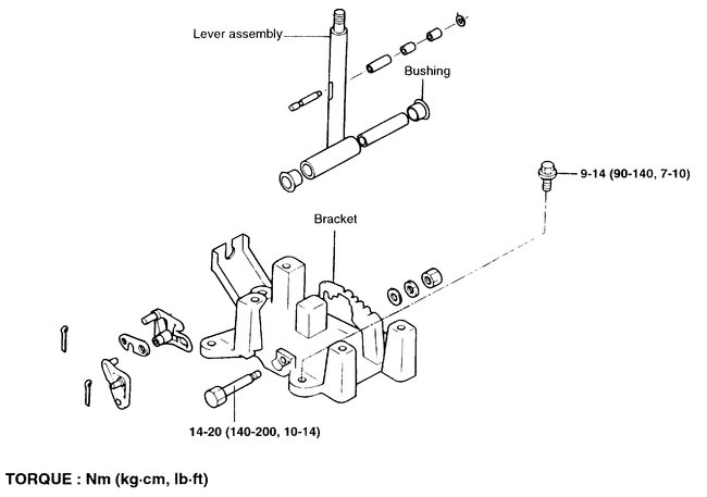

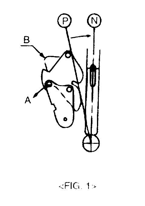

I hope it is the shift and interlock cables you are referring to. There are a total of three in the component to consider, a shift lock, key lock, and ATM cable.
If you need to replace one of them, here are the directions. All attached pictures correlate with these directions.
___________________________________________________
AUTOMATIC TRANSAXLE SHIFT CONTROL
COMPONENTS
COMPONENTS
INSPECTION
^ Check the detent for wear.
^ Check the bushing for wear or damage.
^ Check the spring for damage or deterioration.
^ Check the pin at the end of the rod assembly for wear.

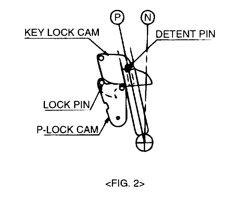

NOTE: When servicing the shift lock device, follow the service instructions and procedures 1. Procedure to install the lock cam.
a. Move the Mock cam to direction "A" and hold it by hand Refer to figure 1).
b. Check that the key lock cam is located at "B" by detent pin (refer to figure 1,2)
2. Procedure for adjusting the shift lock and key lock cable.
a. Check that each lock cam is located in position as shown in figure 2.

c. Temporarily install each cable to the A/T lever assembly as shown in figure 3. Securely insert the cable into the fixing pin of each cam.
d. Keep a gap of 2-4mm between the key lock cam and the P-lock cam to eliminate cable slack by pulling the shift lock cable slightly in the direction of "E" (Refer to figure 3).
CAUTION: If the gap is not maintained between 2 and 4mm, the brake pedal will have to be depressed more than required when operating the push button of the shift lever.
e. After checking that a portion of the cable end touches the cable fixing pin of the P-lock cam, fix the shift lock cable to the A/T lever with the nut and fix the shift lock cable end with the washer and snap pin (Refer to figure 4).
f. Slightly push the key lock cam in the direction of "Q".
g. Performing the work of "F", slightly pull the key lock cable in the direction of "G" to stretch the cable, tight and then fix it with a nut (Refer to figure 3, 4).
h. Be sure to check whether the key lock cable is inserted into the fixing pin of the key lock cam, and then fix it with the washer and snap pin. At this time, check if the P-lock cam is fixed to the shift lock cable as shown in the figure 4.

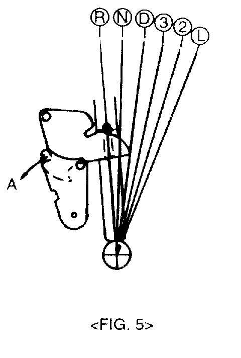

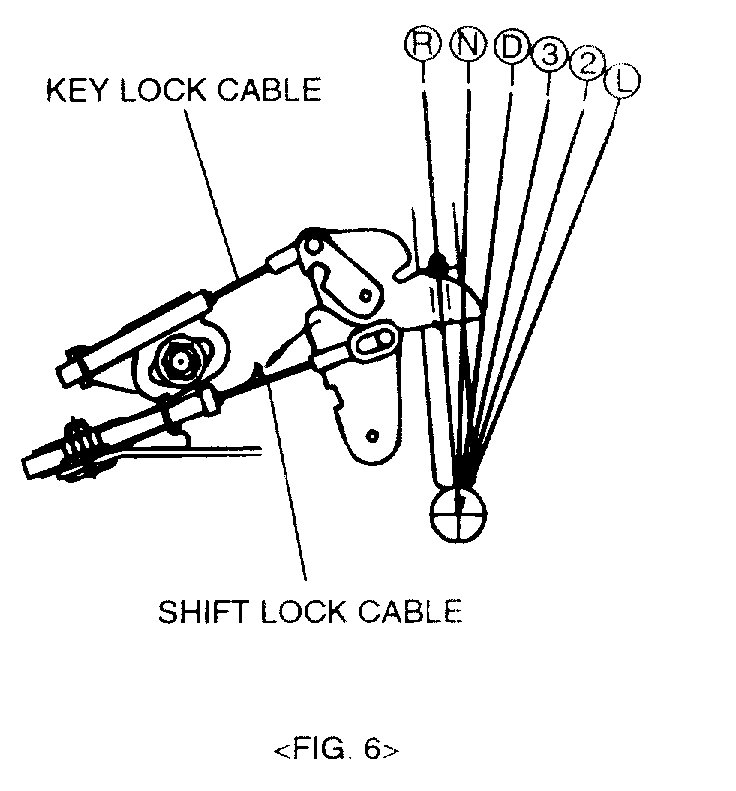

c. Before and after the relating work, the key lock cam and P-lock cam should not be in the same condition as the figure 5 and 6.
NOTE: When the key lock cam and P-lock cam are in the same condition as the figure 5 and 6, shifting the shift lever from D, 3, 2, L positions to P. R. N by force may cause a malfunction of related parts. Under the condition in figure 5, shift the shift lever from D, (3, 2, L to P. R. N after rotating the P-lock cam in the direction of "A"
Under the condition in figure 6, shift the shift lever from D, 3, 2, L to it R. N after rotating the P-lock cam in the direction of "A" the depressing the brake pedal.

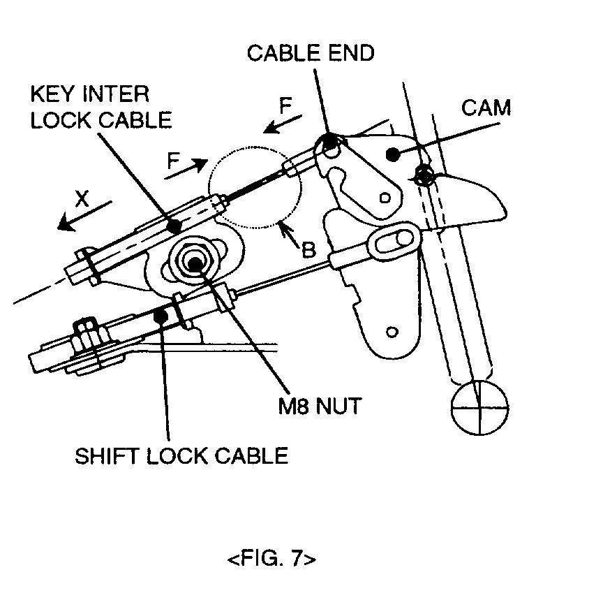

KEY INTERLOCK DEVICE INSTALLATION
It is expected that the ignition key may not be removed from the key cylinder due to Disassembly of the key inter lock cable. To prevent this problem, apply the following installation instructions when servicing.
1. Assembly of key interlock cable and ignition lock.
a. The Ignition lock is assembled to the steering column. Set the ignition lock to the lock position.
b. Assemble the key interlock cable and the ignition lock with the set screw.
2. Assembly of key interlock cable and shift lever.
a. Set the shift lever to the "P" position.
b. After setting the key interlock cable as shown in the figure 7, temporarily assemble the key inter lock cable with a Me nut just enough to move the key interlock cable plate by its spring force.
c. Holding the cable and the key inter lock cable plate, push them into the direction of "F" so as not to create any bending or slack on the "B" point of the key inter lock cable.
NOTE: Do not pull the cable in the direction of "X" to remove the slack. This may cause key not to remove from the key cylinder.
d. Tighten the key inter lock cable with a M8 nut.
