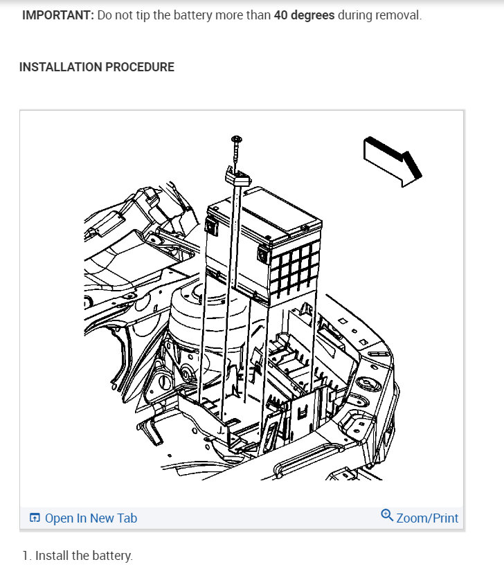

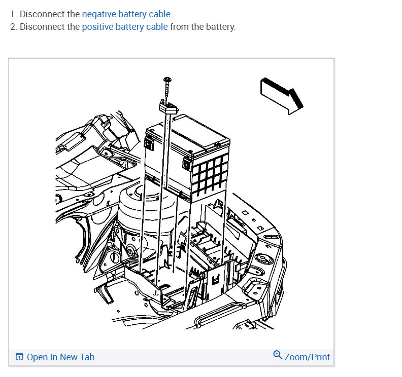

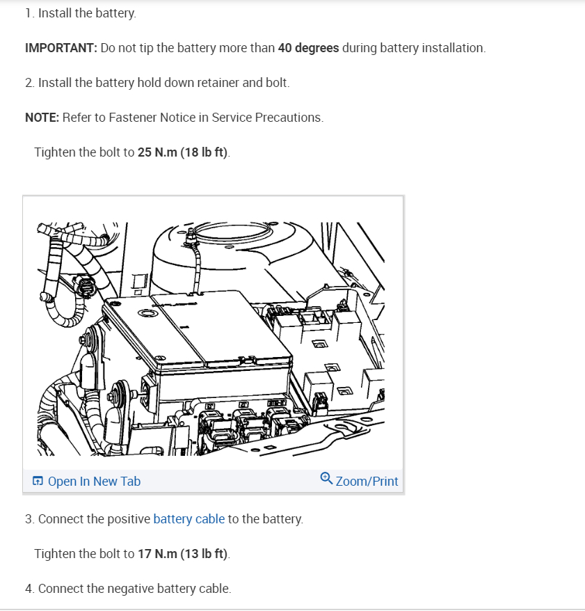

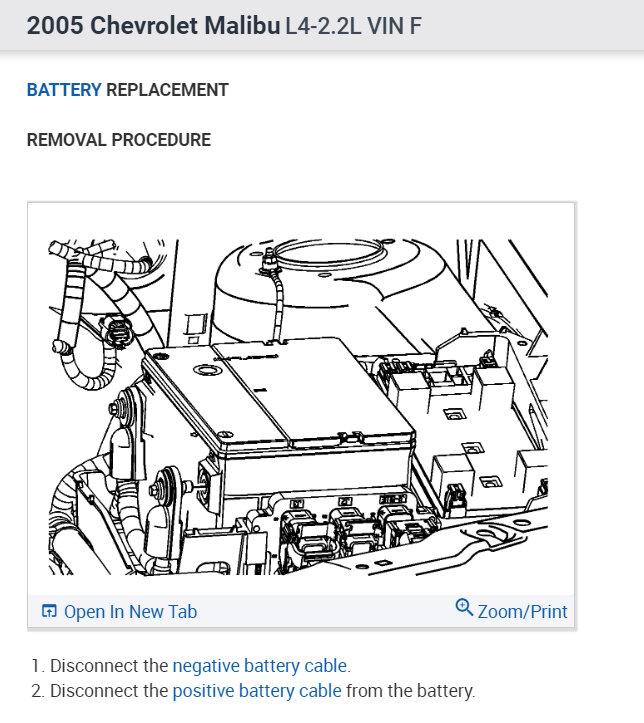

This happens when the battery goes dead, can you turn the headlights on and see if they are bright? This guide can help:
If the battery fails, this guide can help walk you through the battery replacement with instructions below to show you how on your car.
https://www.2carpros.com/articles/how-to-replace-a-car-battery
