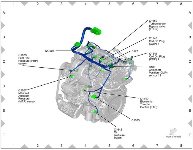

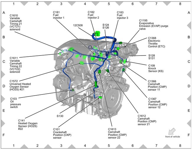

My check engine light is code PO344. I bought the camshaft position sensor but I do not where it is located. can you help me?
Jan 16, 2018 at 6:54 AM
CJ MEDEVAC
  • 11,004 POSTS
I found two diagrams.
I am not familiar with this vehicle, I was able to look it up on Alldata.
Let me know if one of them works.

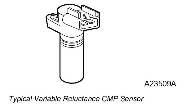

Camshaft position (CMP) sensor.
The CMP sensor detects the position of the camshaft. The CMP sensor identifies when piston number 1 is on its compression stroke. A signal is then sent to the PCM and used for synchronizing the sequential firing of the fuel injectors. Coil on plug (COP) ignition applications use the CMP sensor signal to select the correct ignition coil to fire.
Inline engines with 2 camshafts and with variable camshaft timing (VCT) are equipped with 2 CMP sensors. The second sensor identifies the exhaust camshaft position.
The 2 sensor system on inline engines use the following CMP sensor signal circuit names:
- CMP11 - bank 1, intake camshaft
- CMP12 - bank 1, exhaust camshaft
Engines with 1 camshaft per bank and with VCT are equipped with 2 CMP sensors. The second sensor identifies the camshaft position on bank 2.
The 2 sensor system on engines with 1 camshaft per bank and with VCT use the following CMP sensor signal circuit names:
- CMP11 - bank 1
- CMP21 - bank 2
Engines with 4 camshafts and with VCT are equipped with 4 CMP sensors. The 4 sensors identify the position of each camshaft.
The 4 sensor system uses the following CMP sensor signal circuit names:
- CMP21 - bank 2, intake camshaft
- CMP22 - bank 2, exhaust camshaft
P0344 indicates bank 1 which is the passenger side
