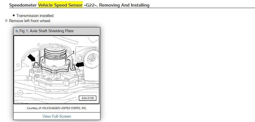

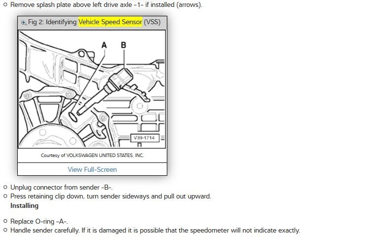

Do not know where the transmission speed senor is located so that I can put a new one on.

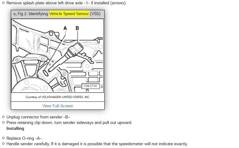

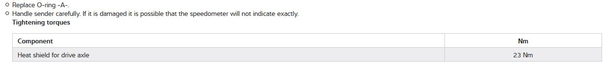

If you are talking about the vehicle speed sensor that runs the speedometer. hHere is Prodemand's information on its location and how to replace it. It sounds trickier than it is. Let us know if therei s anything else we can help you with.
