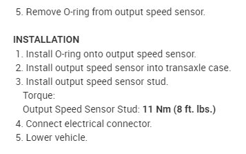

Where is the VSS located?
2002 SATURN L300
260,000 MILES • 6 CYL • 2WD • AUTOMATIC
DON LOVELESS
Need to replace the Vehicle Speed Sensor.
Jul 6, 2023 at 11:06 AM
  • 110,240 POSTS

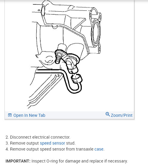

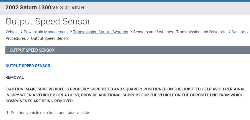

I suspect you are referring to the output speed sensor. That is what I attached the directions.
If you look below, I attached the directions for the replacement of the sensor. Take a look through them and let me know if you have other questions.
