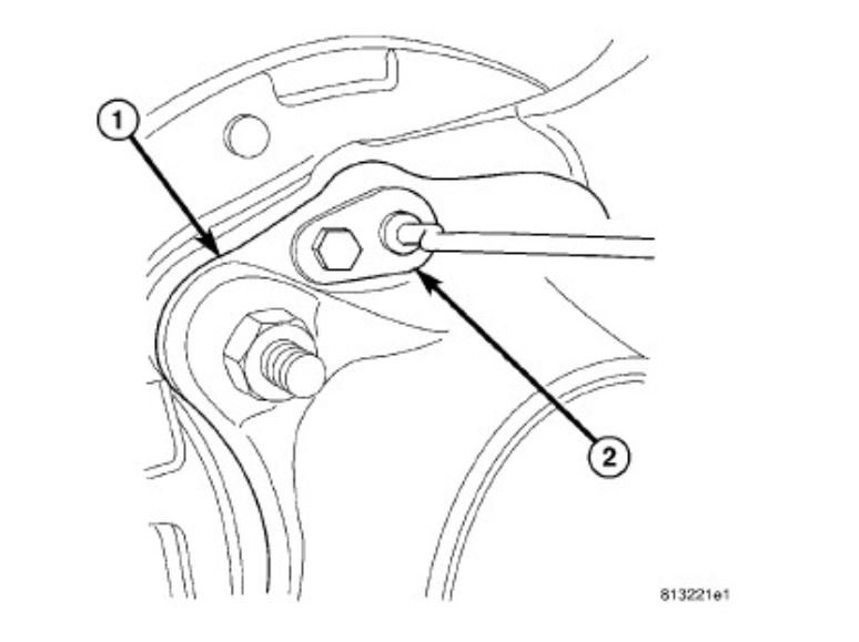

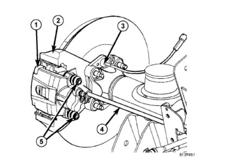

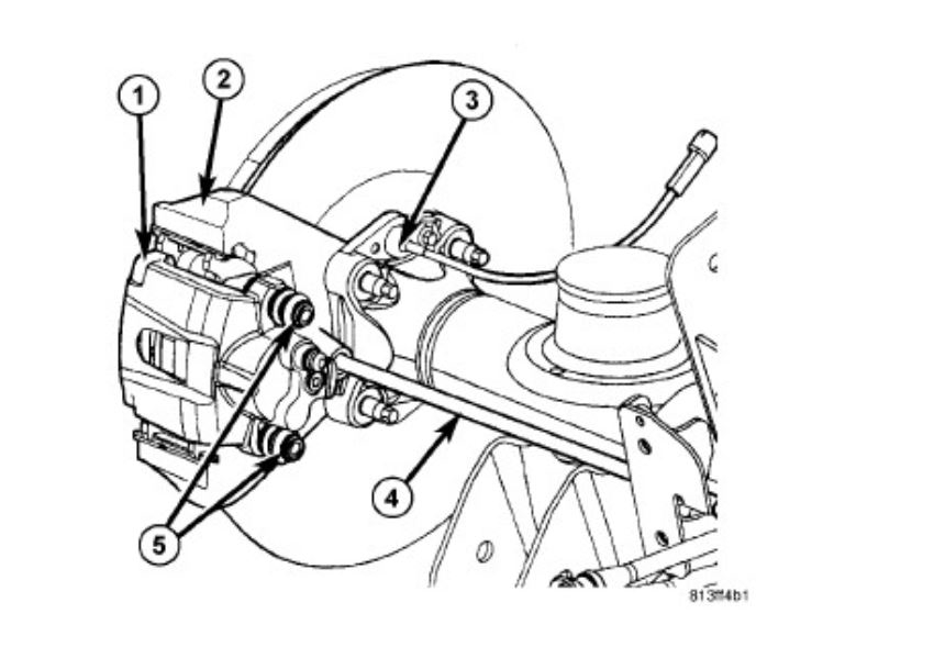

The rear ABS sensors send a signal to the PCM for vehicle speed.
It is not the sensor as indicated in the code description and possibilities. If it was a sensor, you would have an ABS light with a fault stored.
Both rear sensors send the signal.
Thursday, May 23rd, 2019 AT 12:11 PM
JOHN ROBERT DICKHAUT
  • 6 POSTS
That looks like a wheel sensor.
Thursday, May 23rd, 2019 AT 4:20 PM
  • 52,797 POSTS
That's correct. The ABS sensors send a signal to the PCM and it is translated to vehicle speed by the rotation of the rear wheels.
That's why I said I doubt it is a sensor at all.
