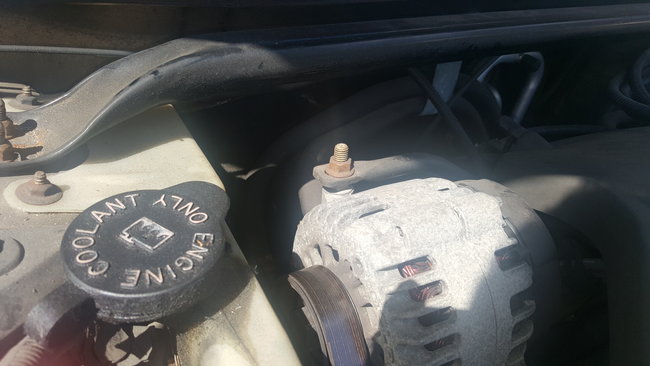

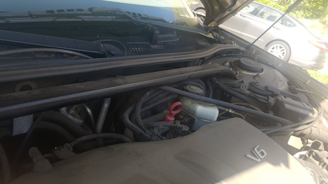

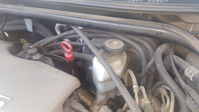

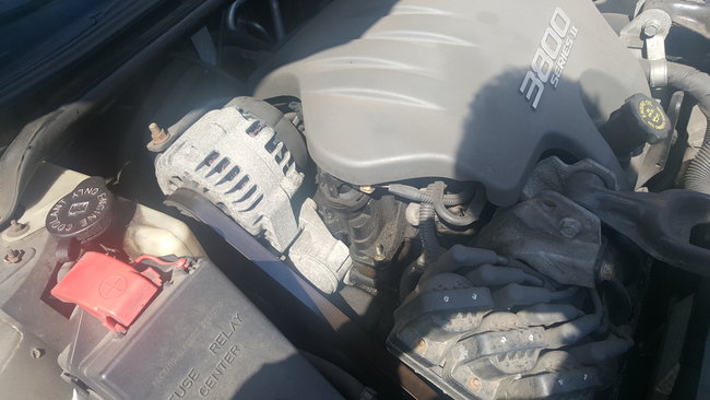

Below are some pictures of my engine bay. Where would the power steering fluid reservoir be?
May 7, 2020 at 6:45 AM
I don't see it in those pictures. More then likely it is closer to the power steering pump. I have a feeling it is going to be further up under the cowl.

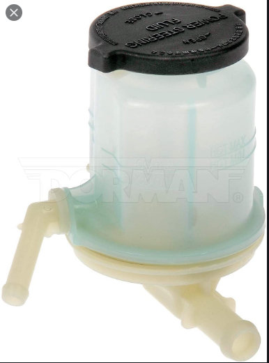

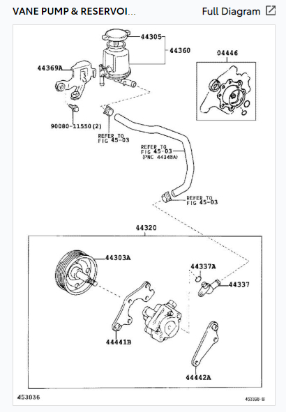

I also attached some diagrams that will give the layout of the system and one of what the reservoir should look like. In the second picture of the diagram you will see the reservoir and that line that comes off of it goes to the pump. So if you find the pump, just follow that larger line back and it should lead you to the reservoir.
