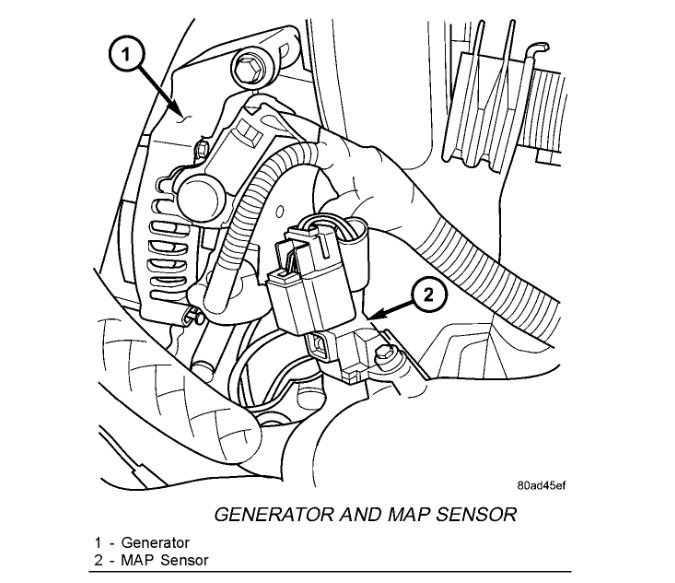

I am having trouble locating the MAF sensor. Please help me locate it.
Dec 17, 2019 at 11:00 PM
Good morning,
The car does not have a mass airflow sensor. It uses a MAP sensor in place. I attached a picture of the location for you.
What is the issue that makes you think you need a mass airflow sensor?

The car is idling rough and when I hook up the PCV hose it shuts off.Without it hooked up it runs fine. The timing belt and water pump were recently changed. Just put a new throttle position sensor in and have a new PCV valve to install.The codes being thrown were mass air flow sensor,throttle position sensor and thermostat sensor with a random misfire.

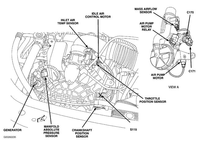

I looked at another diagram on here and it is showing a mass air flow sensor by air pump motor and air pump relay. I'm lost.
Dec 18, 2019 at 2:59 AM
Okay, thanks.
Again, there is no mass air flow listed for your car in our information system.

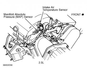

Chrysler is the only manufacturer that has never needed or used a mass air flow sensor to make their engines run right on their domestic models. The main fuel metering calculations come from the MAP, manifold absolute pressure sensor. That is a fancy name for a vacuum sensor.

https://images.2carpros.com/forum/automotive_pictures/198357_Graphic_454.jpg
intake manifold

Car does not have MAF uses MAP
