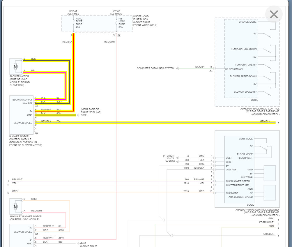

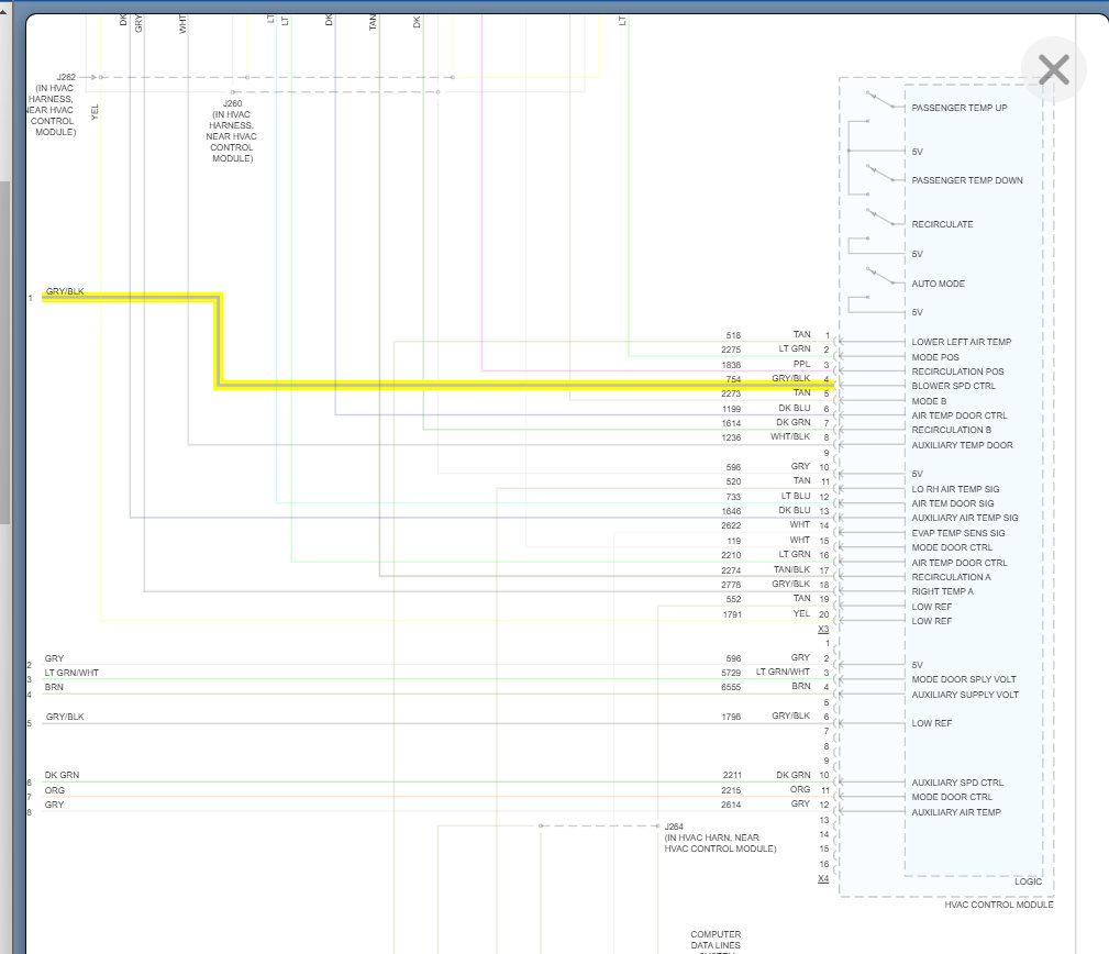

I am attaching the wiring diagram below, but we need to do a couple things.
I would start going to the resistor (control module) and check power on the B+ wire which will have 12 volts all the time. Then check for a good ground by using the ground terminal to check for the same B+ voltage.
This will tell us both are okay.
Next, we need to turn the fan on low and check the voltage on the blower speed control wire. Then increase the fan speed and make sure the voltage changes.
Lastly, we need to check the voltage going to the blower motor and check for a good ground on the low reference wire.
Let's start with this info and go from there. Let me know what questions you have.

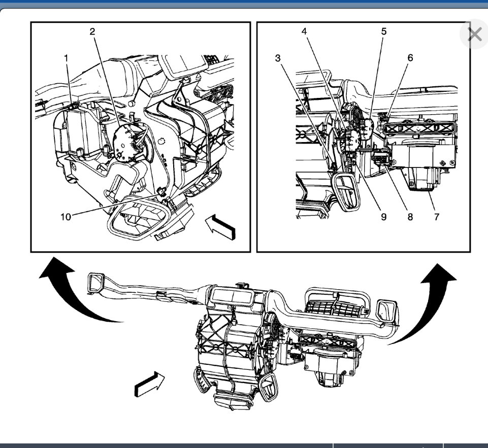

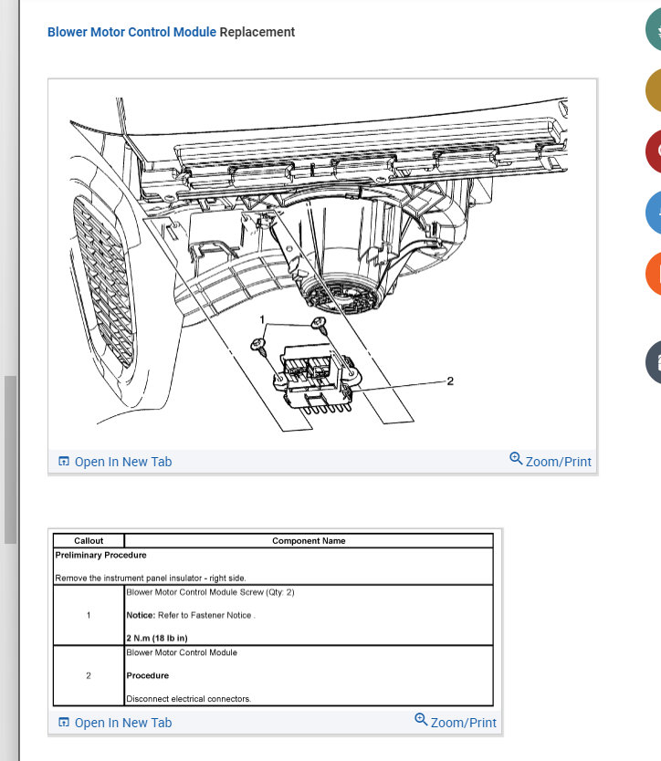

So, I’ve checked the power line to the blower motor, and it puts out 14.5v. I’ve checked both HVAC fuses, the one under the hood and under the glove box. Both are good. I could not find the resistor. There was a plug to the left of the blower that had plugs in it. Both were connected but I didn’t unplug and test any of them as I did not know what they were.
Apr 24, 2022 at 10:26 AM

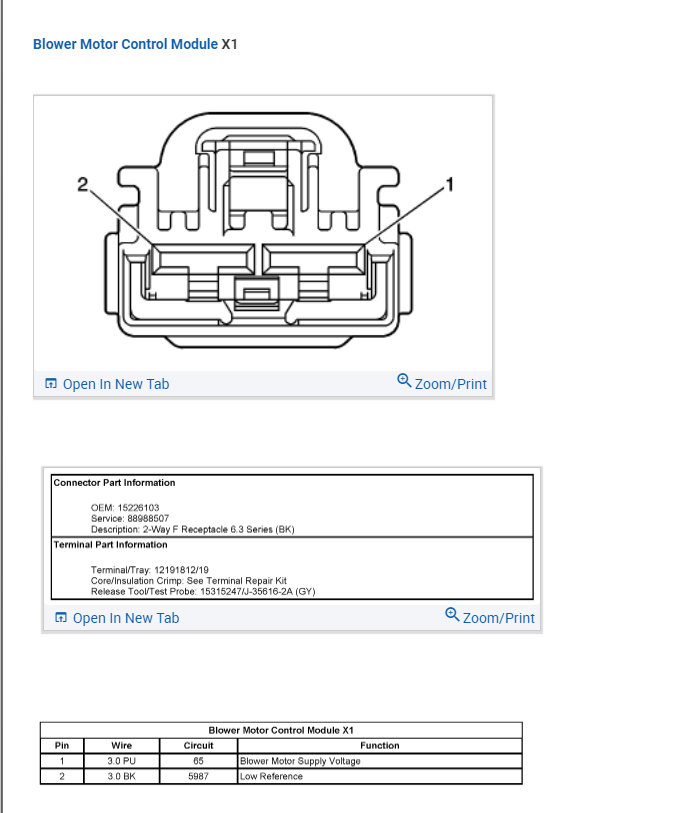

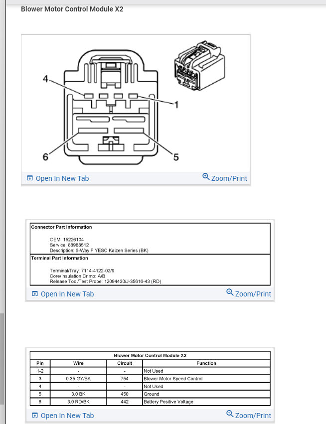

Okay. Yes, the connector that is next to the blower motor is most likely the resistor. They call it a control module. So, if you have battery voltage getting to it then it is likely the issue.
There are two connectors for it, and I am attaching the info on this below.
Basically, you need to check the voltage getting to and what the speed control is showing. This will mean if the blower is not working then the resistor is the issue or the blower motor.
Have you put 12 volts to the blower motor and make sure it works?

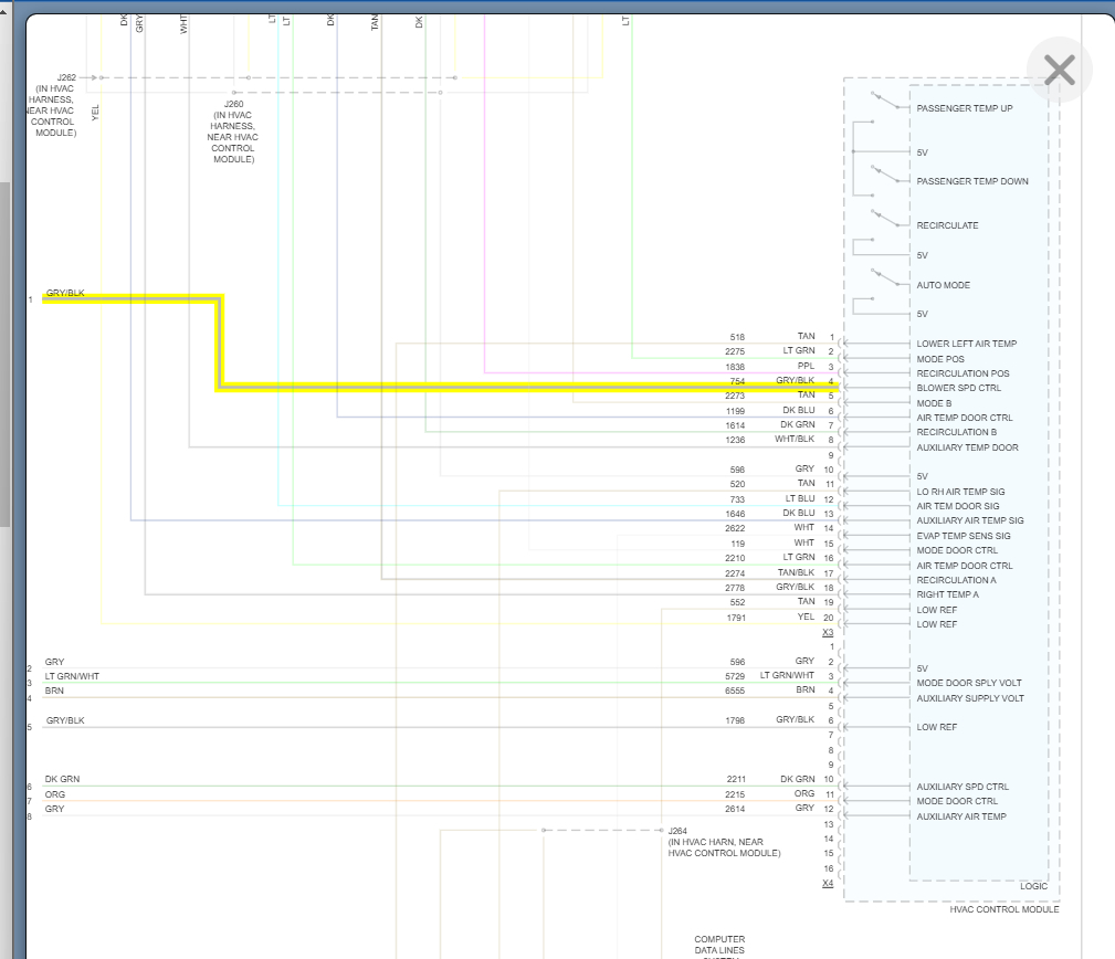

Your control module would be the likely cause, but we need to go to the resistor and check voltage on the speed control wire when the blower is turned on and find out what the control module is sending to the resistor/control module. If we don't confirm this, then we could be wrong or missing something. Also, we need to start checking this because we are assuming that the parts that you put on the vehicle are good but there is always a chance that they are faulty as well.
Take a look at the wiring diagram above and tell me what the voltage is on the speed control wire form the HVAC module when the blower is turned on.
If you have no voltage, you can also confirm that everything else works by jumping voltage to that wire and the blower should come on. Do not put more than 12 volts to it as that should be the high-speed command.
